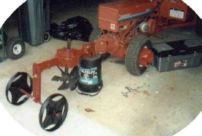

Thought it might help to have a picture. Here's one of my Gravely rotary plow. Note: it isn't on the tractor in the pic; it's sitting on that black bucket.
The rotary plow could give you a plow pan, but less likely because you generally don't stay at a fixed depth. You can go from just skimming the surface to about 8-10" deep, just by the place you put the depth wheels or the distance you drop the shaft on the plow.
