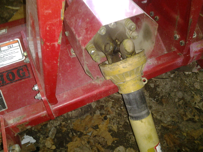

Hi. I bought a new chinese tiller on a internet acution. Well I know what you think...and I think the same;)
I should mention that I never tilled before. My plan was to till new land, after removing trees big, stones etc. Insted of filling up with new earth I use my tiller to get the earth movable. Areas of this kind usally contain hidden stones under the surface. On my tiller I havnt found any breakpin, instead I have broke the chain twice...:mad: this happens when the tiller hit a big stone.
So maybe their isnt any breakpins on tillers or my tiller is....well....chinese (bad copy)?
What happens if you run into a big stone with an orginal kubota tiller?

I am pretty sure there is a shear pin somewhere. If you really cant find it, perhaps you should install a slip clutch on the tiller pto. Its no fun to break open your BX hydrotransmission to fix the pto shaft/clutches/gears inside.

A slip clutch will mount between the PTO shaft and the tiller. You can buy a new PTO shaft with one installed. Just curious is the pto shaft mounted to the tiller gear box with a spline shaft or shaft with a key and bolt or just a bolt. If just a bolt that bolt should shear. Be sure someone didn't put a grade 8 bolt there or something. Also at that point pull the bolt and make sure the shaft will spin on the shaft and isn't rusted solid.
/ Tiller for BX... #6
Oldtractorfixer is totally right. Get a PTO with slip clutch to absorb any hard knocks. I have vast experience with Chinese product and I know that one brand I used to sell always turned up with no shear protection anywhere on the tiller. That's no good for a tiller. So thats probably why you are having trouble. Get a new PTO with shear protection or slip clutch. Slip clutch can be expensive but cheaper than fixing damage that will happen with no shear / slip protection in your tiller.
/ Tiller for BX... #7
Here is a pix of my slip clutch mounted under the safety cover

As everyone else says.... just add a slip clutch. Apparently, they don't have rocks in China ??? :confused::confused:
If your tiller has a standard six spline @ the tiller end, you can buy a slip clutch that goes on just as your tiller-end PTO shaft does..... then, just slip the PTO shaft onto the slip clutch (after you adjust the length of the PTO shaft).
PTO Slip Clutch, 1-3/8 in. 6 in. Spline Shaft - 0271211 | Tractor Supply Company
Do a search here on TBN for the correct process on adjusting your slip clutch once it is installed.
