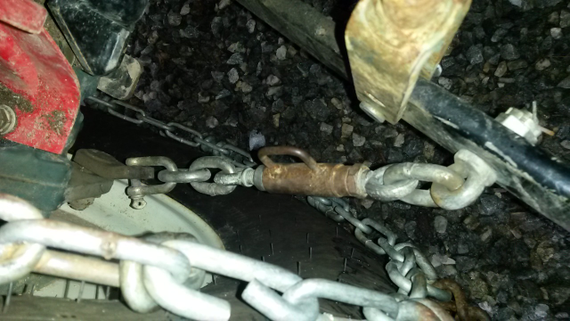

My stabilizer chains get loose and I find I have to tighten them down a couple times per day. I have chains on my turfs and when I hear that familiar sound of thesway arm hit the tire chain I know its due for a tightening. Anyone else have this problem? I was thinking of adding a lock washer into the mix?
/ tightening sway chains #34
Stopping the barrel from turning, using a locknut or clevis pin, is a good idea.
I had a similar problem: the aftermarket clevis, that attaches the swaychain to the 3-point mount behind the transmission, kept stretching. I posted a photo here after it neared breaking. I replaced it with an 'H' style chain splice. Thread with pics.
/ tightening sway chains #35
California...I have enclosed a picture of my chains. How would a clevis pin fit into the equation?
/ tightening sway chains #36
I see yours has a locknut, so my suggestion isn't relevant.
I should have thought of a better description. Lets try this: One variety of sway chain assembly has a slot in the 'barrel', the center portion, so both threaded tips are visible. One of my Yanmars has that type. And one threaded tip has a hole drilled across it, with a cotter pin in this hole. This prevents the 'barrel' from unscrewing. I hope this is a better description.
/ tightening sway chains #37
My old Kubota L3400hst had that exact thing.. a lot of the guys don't know what the little hole in the tip is for, but it is for a "hairclip". It worked well to prevent turning, and only took a second to remove and re secure.

Thanks California - Now I get it!
