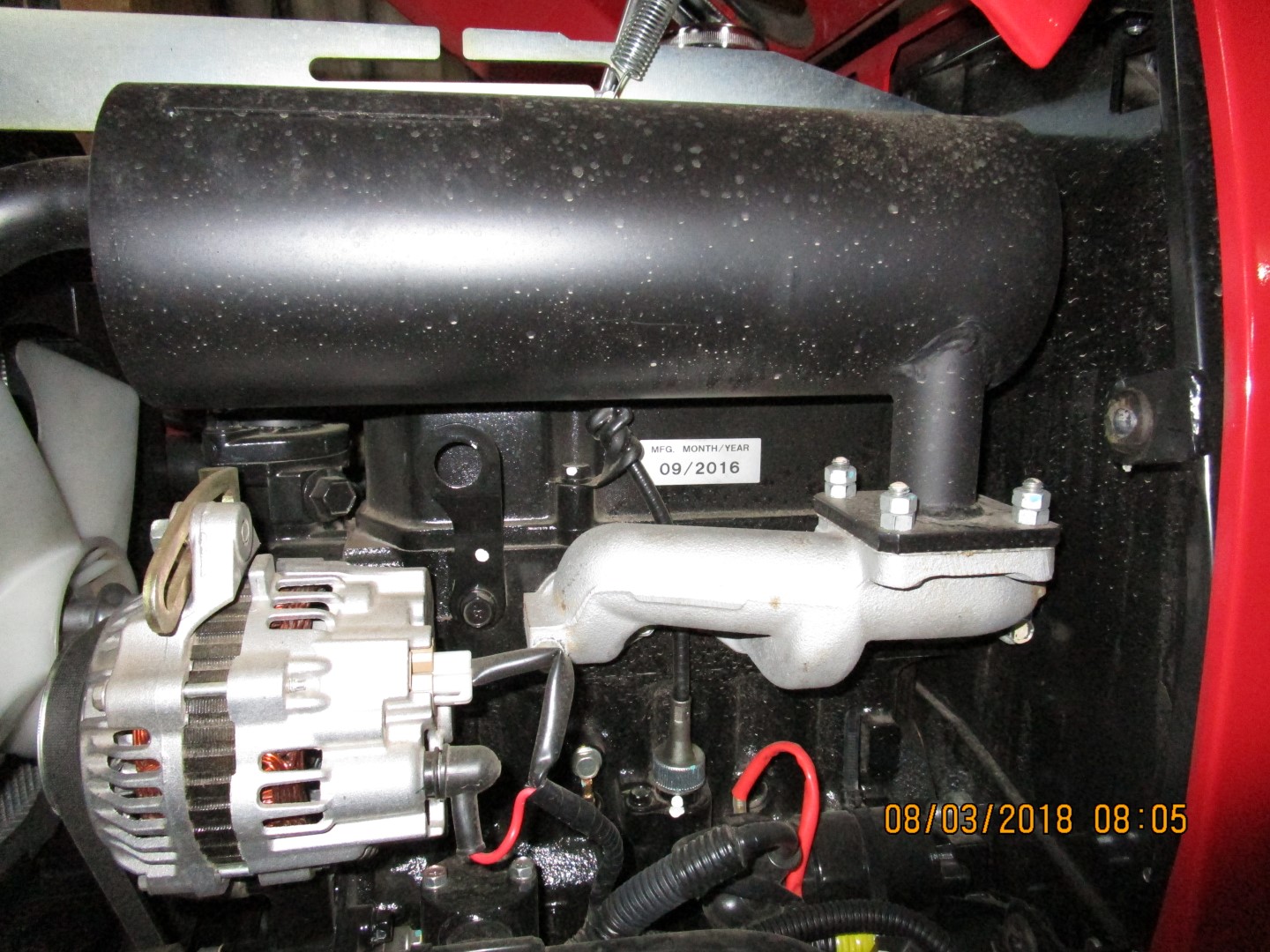

Nothing coming off the exhaust except an old school muffler on the 1526, no EGR...
