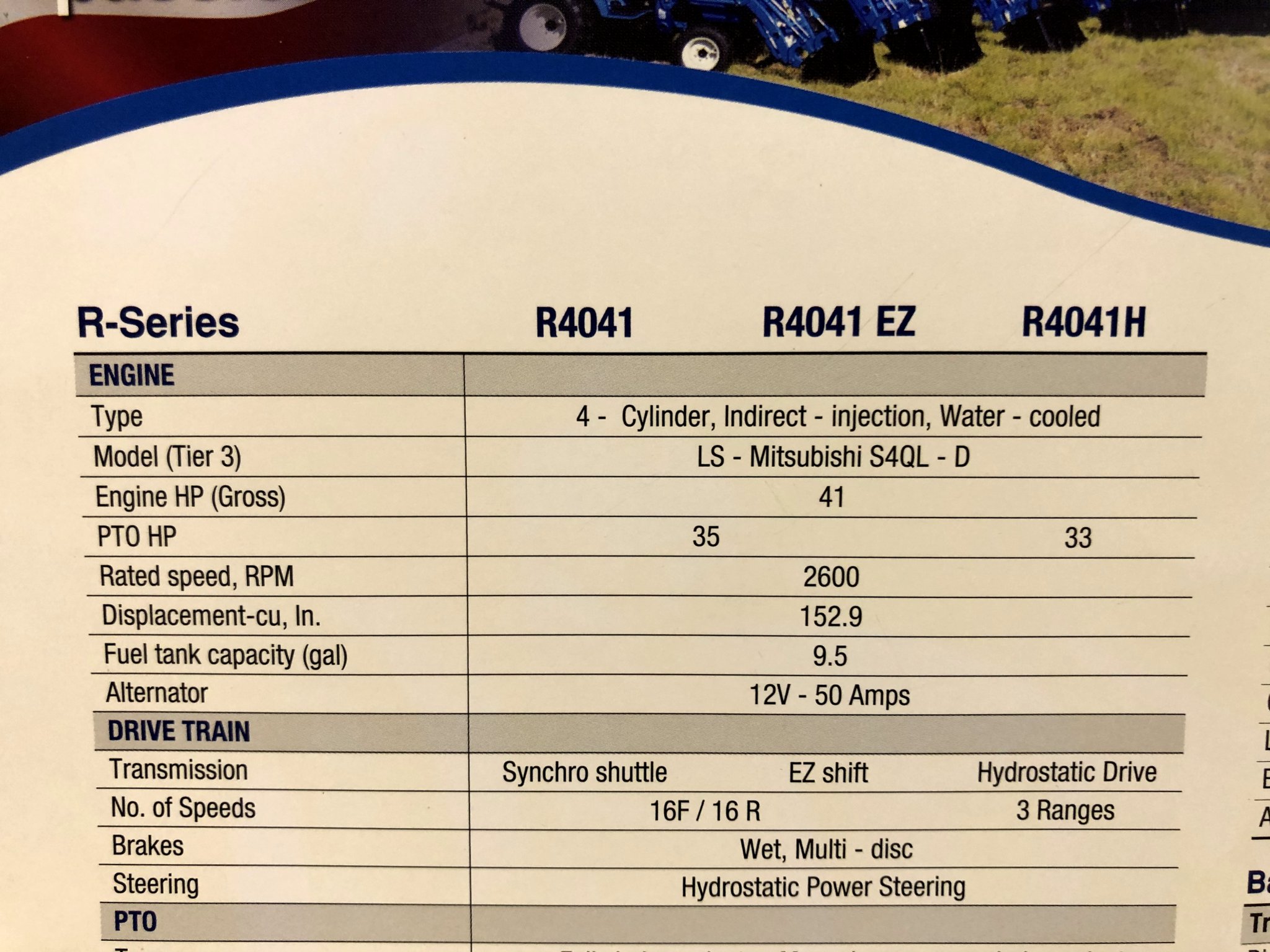

Perhaps I am misunderstanding, but my R4047 has a Tier 3 engine.
/ Tier 4 Emissions delete #23
It is complicated for sure.
Here is a link to the EPA Website showing non-road emission standards.
Your R4047 is 47 hp. As shown in the EPA table I linked to, the less than 50 hp (37 kW) went directly from Tier 2 to Tier 4. In the less than 75 hp (56 kW) there could be some Tier 3 engines if the manufacture took advantage of any of the foot notes. (Like I said, it is complicated!)
I don't bother referring to engines in Tiers in discussions of a specific engine unless it is miss information. I prefer to refer to an engine as either having exhaust after treatment (DOC or DPF) or not and this is readily apparent looking under the hood.
/ Tier 4 Emissions delete #24
This is from the sales brochure for my 2013 R4041H
/ Tier 4 Emissions delete #26
Well, I don't have dpf or any extra plumbing or regens so its a pretty user friendly and trouble free interim tier 4 tier 3.
