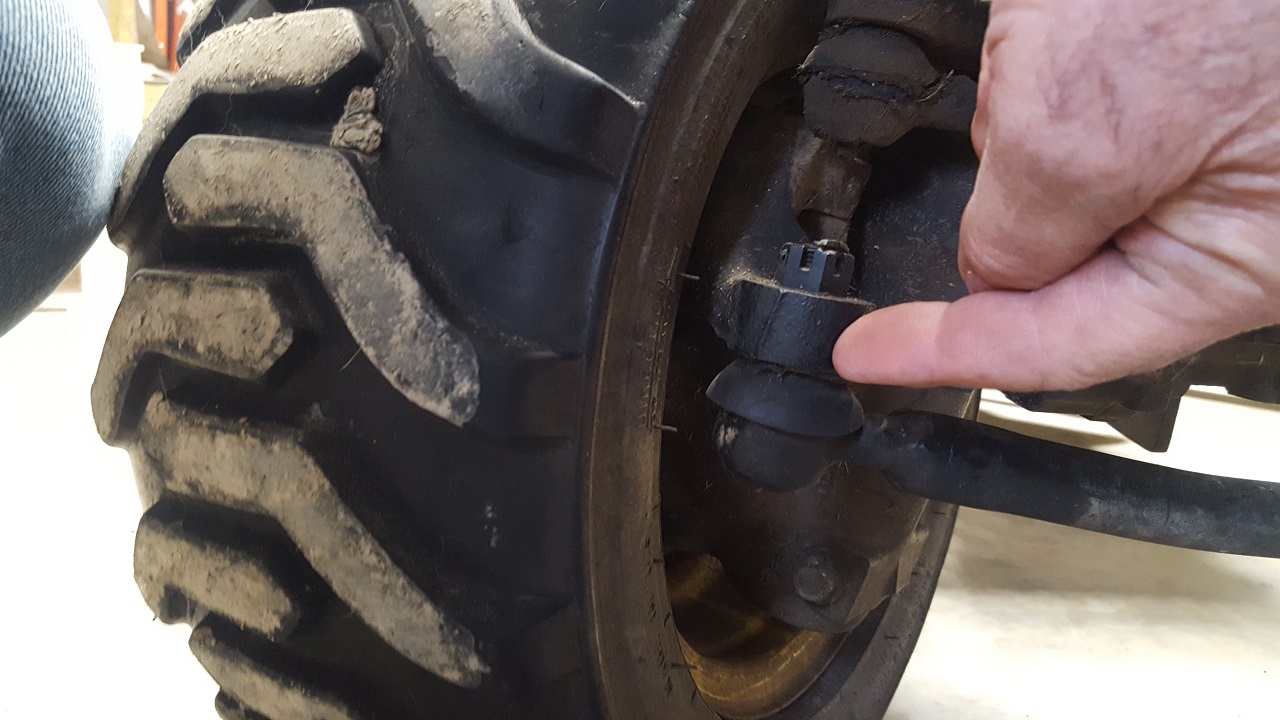

/ Tie rod boots #13
How about a pictorial?
Remove the cotter pin. Loosen the nut leaving a couple turns so you don't drop the tie rod. Smack the loop the tie rod stem goes thru where my finger is pointing. Diligently and with conviction. The tapered stem will drop out of the loop. Never, ever hit on the threaded tie rod stem.
Using my little JD as a demo because I'm too lazy to walk out to the machine shed and take a pic of the Ford 3910. :)
