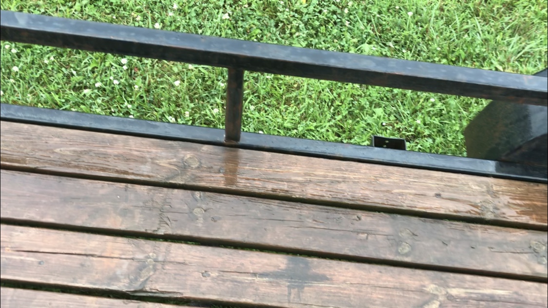

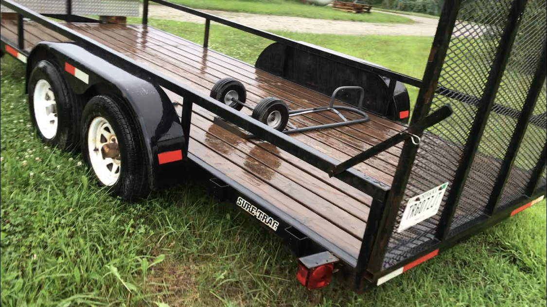

I have a 16 ft utility trailer I picked up a few years back when I wanted to tow my CUT. This thing pulls very well so I’m keeping it. Needs new decking, some metal repairs, and I’m planning to move a few things around.
The problem I can’t seem to solve is once I add sides to it how can I secure equipment? The walls will prevent me from being able to run my chains to the stake pockets.
Any ideas appreciated. Might be overthinking it

What kind of sides do you have? I plan on welding up a set of removable expanded metal sides for my utility trailer and cutting slots for my stake pocket D rings.
/ Tie down options for utility trailer with sides #4
D-rings welded to main supports. Help us envision your plans.

I’m considering treated wood decking or expanded metal for the sides. I’m leaning towards wood now. If the bottom rail is high enough I should be able to use the stake pockets that are “paid for” or access a D-ring welded to the frame.
Only issue that leaves is what to do with loose material such as mulch or stone. I’ll need a way to fill in the gap.
I don’t mind that idea so much because the gap makes it easier to keep the deck clean after hauling mulch or compost. Maybe keep a remnant of vinyl flooring around wide enough to wrap up the sides past the gap. Smooth surface might be nice for shoveling mulch or compost.
I read another post this morning where a member used a router to cut a slot in the deck board and loop a chain around the support.
Might be able to hinge the bottom rail... flip up when securing a load to access stake pockets, down when hauling loose material.

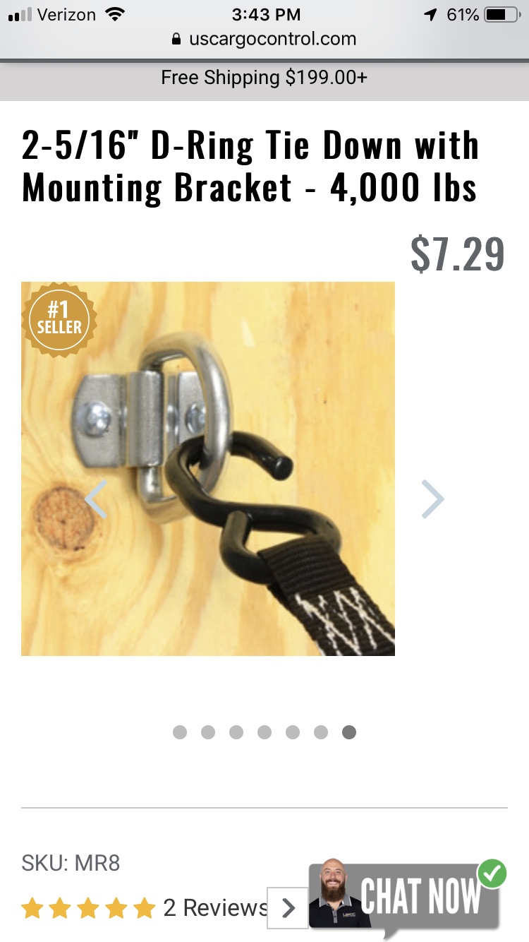

The previous owner of my trailer installed these. I didn't trust screws holding them down. Didn't matter since within a couple years they were so rusted you couldn't pull the rings up.
/ Tie down options for utility trailer with sides #12
With through bolts to the frame or plates under the deck they have the rated capacity. Mine haven't rusted at all in several years but I park inside most of the time.

Maybe I am not understanding but if you are only putting say plywood on your sides no higher than your current sides see no reason you can not run chain or straps over the top rail and the solid sides to trailer frame to tie your tractor down. Just be sure you use pockets to tie to that hold the tractor in place. Run to pocket behind the tractor to keep from moving forward and in front of the tractor to keep it from rolling back. Or you do the reverse. Have do so many many times.
/ Tie down options for utility trailer with sides #16
sides
When you have fixed sides, eyelets welded on the inside wont be awkward when loading pallets from the side because the sides dont fold so you cant load pallets anyways.
My trailer is universal use (dirt, vehicles, building materials) and i welded a pin in a stake pocket, with a long chain link on the pin. I can pull the chain link up outof the stake pocket to hook a tie to it. When i drop the sides they are our of the way, hanging under the surface.

I was planning on doing theses. Using washers with nuts on bottom side of trailer to secure a UTV. Is there a issue with this setup? Easy to do and no welding. Thoughts?
/ Tie down options for utility trailer with sides #19
I use them to keep a big plastic box in one place on my utility trailer. The box is the size of larger cooler and has my chains and binders in it. When all the stuff is in it, I can't move it by hand. These are just screwed into the wood decking. On another trailer I have these bolted through the metal frame to secure my Gravely walk behind. Again not a lot of weight. Jon
/ Tie down options for utility trailer with sides #20
Seems to me that going through 1.5”thick boards using 7/16” bolts to secure a 1600lb utv would be a piece of cake. I just can’t see the bolts not holding but several people said they don’t trust that setup.
