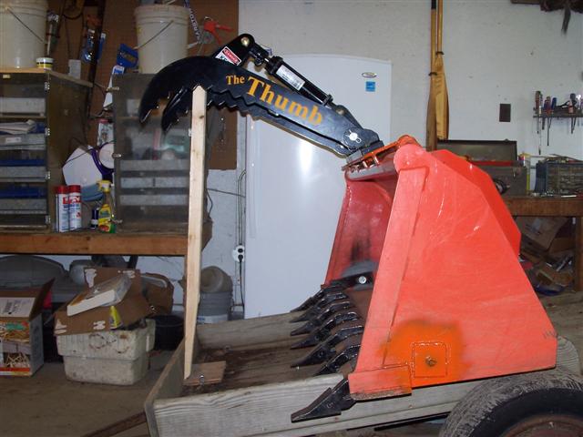

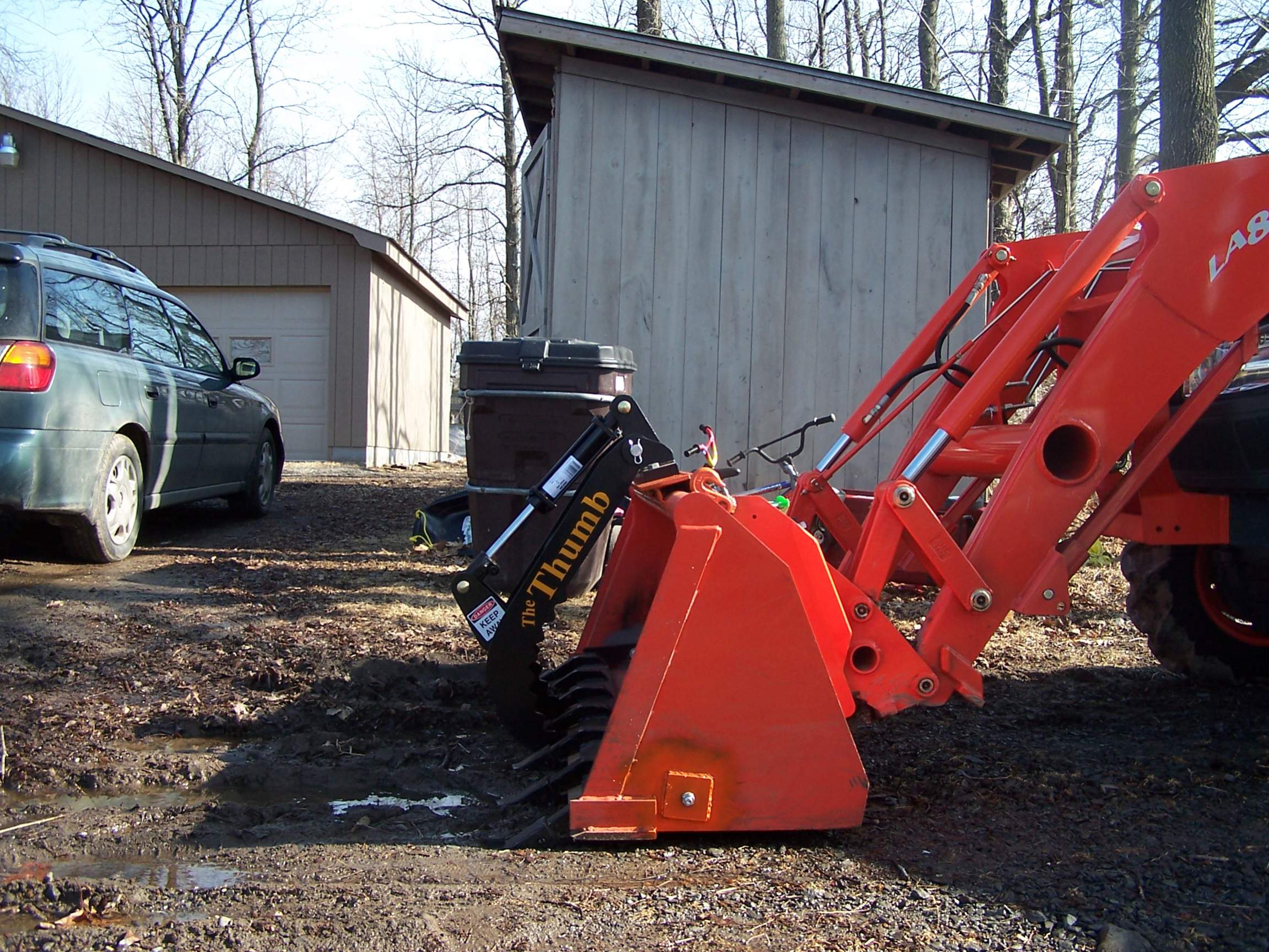

Green's Machine Thumb(I bolted mine on);best addition ever for my uses.Also added a tooth-bar.

That is exactly what I am looking for. Looks great! Thanks
What size thumb did you get for the Kubota bucket?
What tooth bar did you purchase?
/ Thumb / grapple upper for FEL #5
Mine is a 28" on a HD round-back,6' bucket.I had to weld an angle iron on top of the bucket to fully close on the bottom edge.Nuts are welded to the bottom of the angle(for easy removal or transfer).Can't remember where I got the tooth-bar(maybe Michigan Iron).
Tooth-bar is also a bolt on(notice tabs on side of bucket).

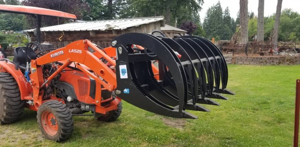

I got my Grapple from Titan Attachments. Love it. Need the bypass valveScreenshot_20200807-121557_Gallery.jpg
