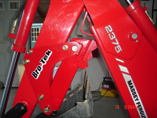

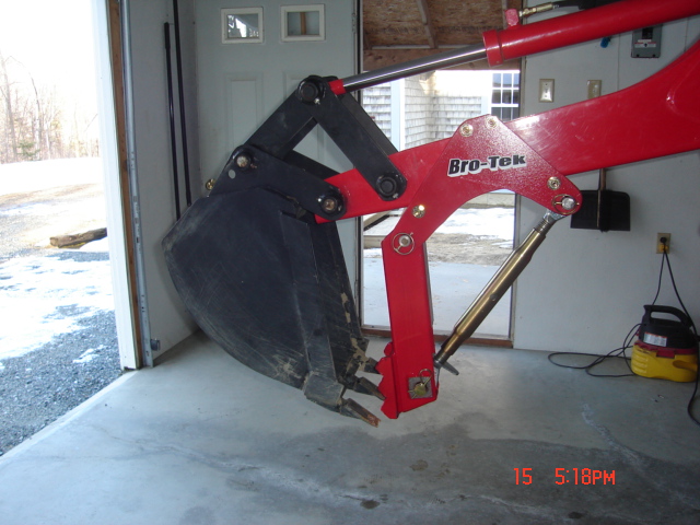

I have the Bro-Tek. Generations 1-3 of the Wallenstein all had severe engineering failures. I am under the impression they finally got the bugs worked out with Generation 4. The archives are full of thread after thread on this. Bro-Teks are specifically shaped for each model backhoe. The web page for that EMP thing lists a slew of backhoes that it "fits" or "might fit". I would stay away from something like that is not engineered for the arm of your specific bh.

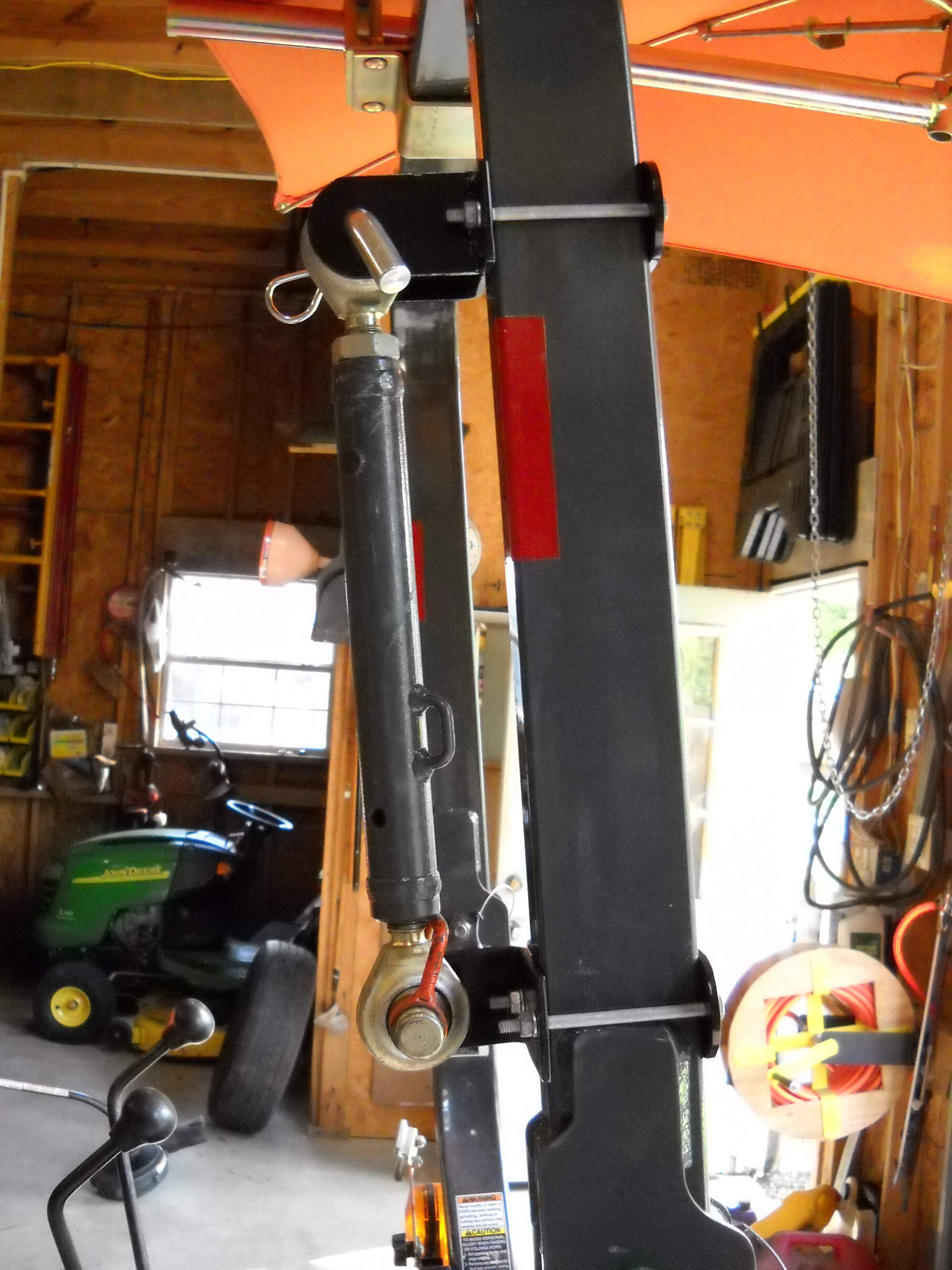

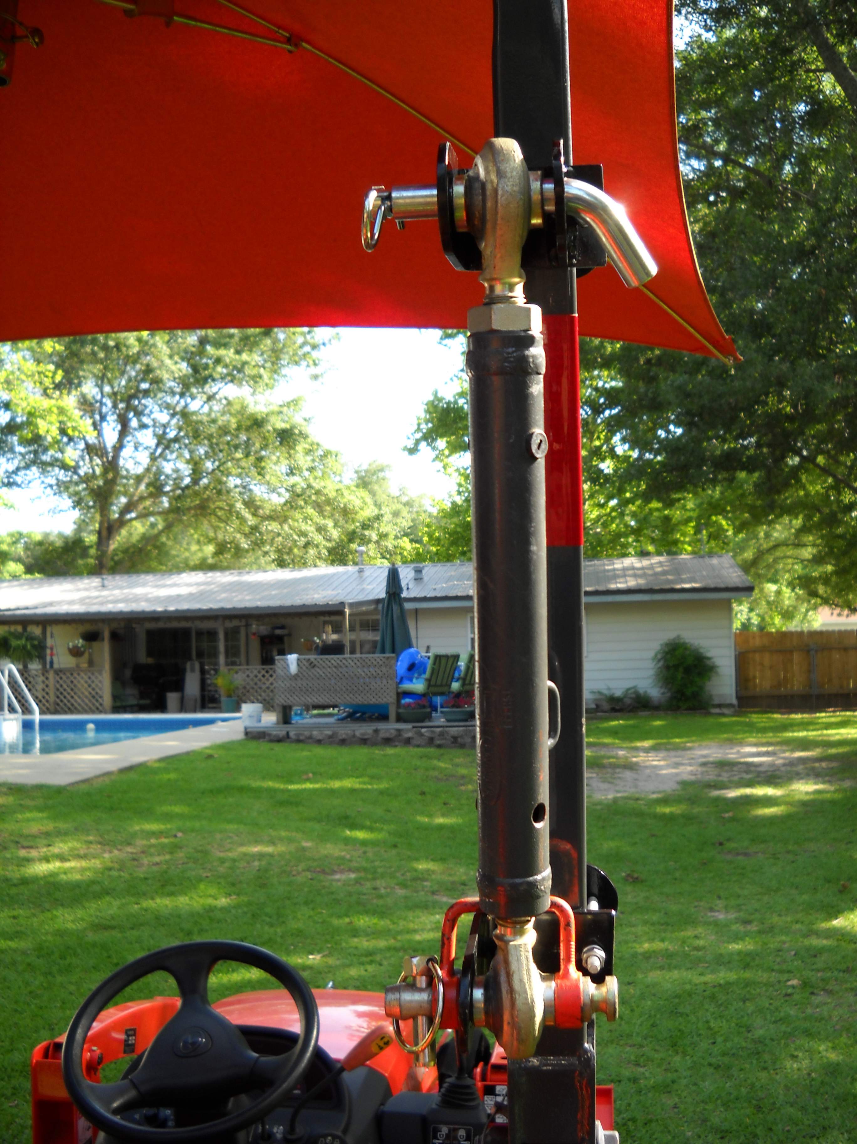

Yes, the Bro-Tek uses a top link. I believe that the Kubotas use their own, but on the 2300-series M-F tractor, the top link needs to be heavier than the OEM one so a top link (with 1" pins) comes with it.
The top link is simply removed for thumb storage on the BH boom. The thumb could be removed altogether, but I find it easier to just fold it up against the boom.
I've been very pleased with mine.

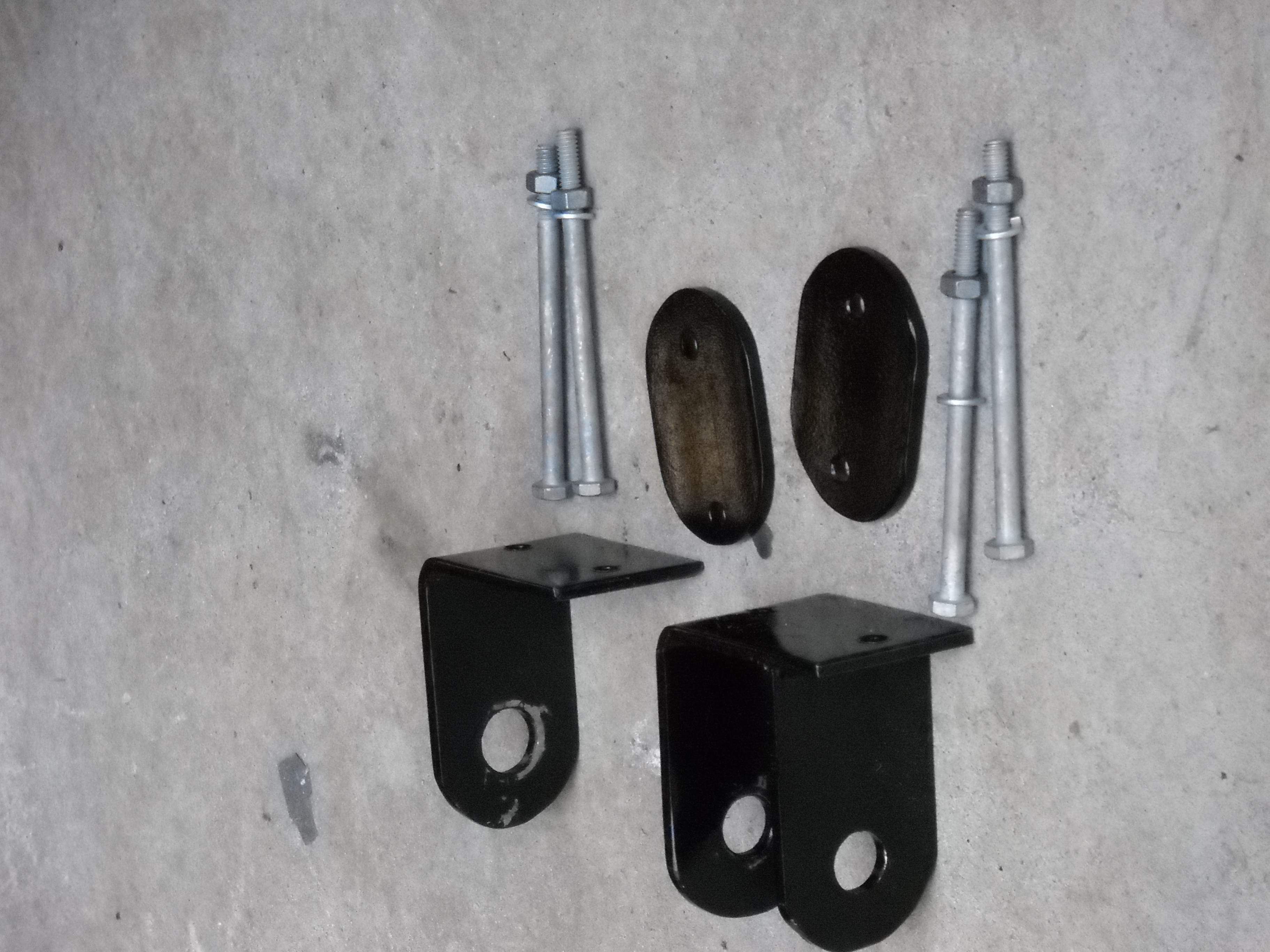

I have a BX25 with the Bro-Tek thumb
Love it, 1 year old & no problems with thumb or center link
My BX came with 3 point hitch lift arms & top link.
Here are pics of brackets I made yesterday to hold centerlink
when not using thumb
