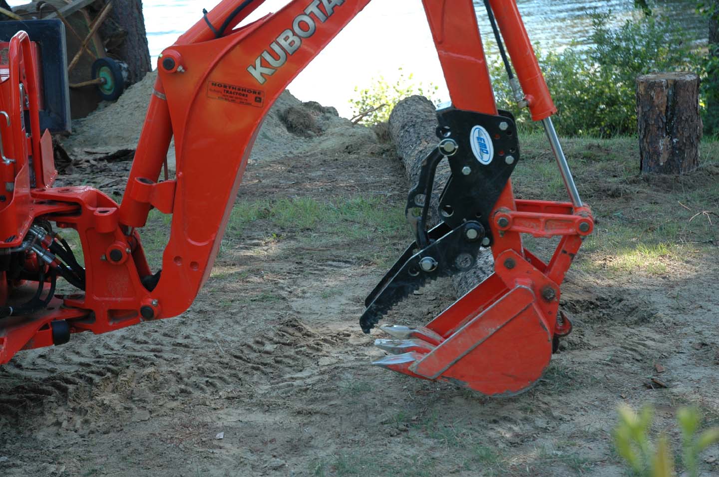

I bought a titan thumb (bolt on) off of flea-bay for $125 about a year ago. I got a slightly larger one and had to add 2 plates to each side of the mount to get it to fit tight on the dipper stick. Wasn't hard to do, but I would suggest that you have the dealer install it. That way, if there are any problems, you can deal with them to fix the problem. Definitely worth the cost!

Looks Nice. Do you think it would help lift rocks?

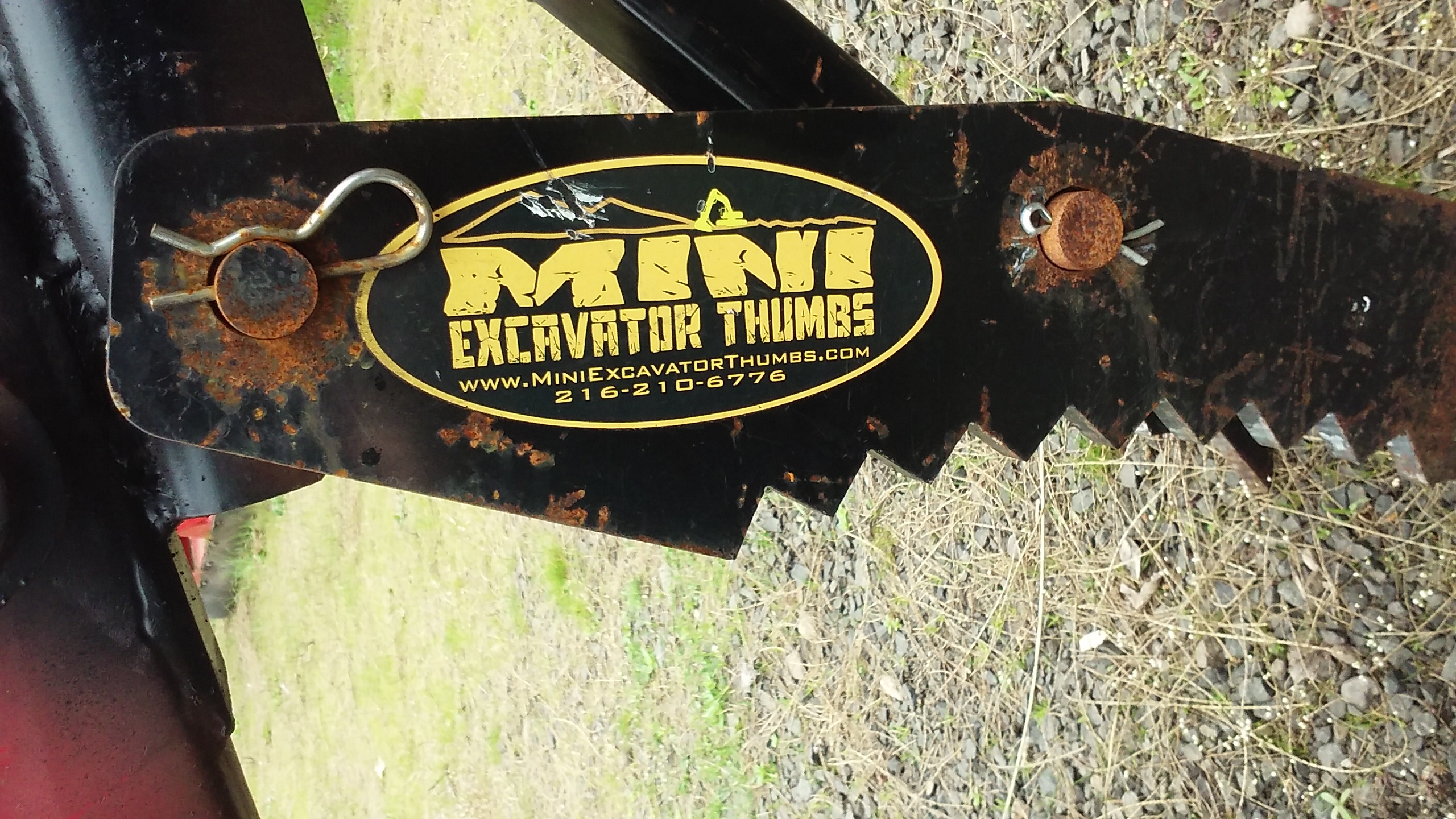

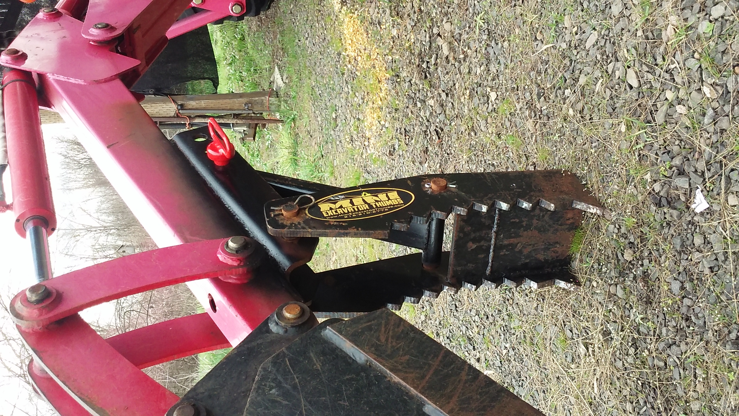

I'm not sure how the hydraulics are mounted on the LS tractors but on the Kubota BX25 I used to own, the thumb bracket moved and broke off a fitting on the dipperstick hydraulic cylinder. I bought the thumb off of eBay and installed it myself. Fit and function were good, but when I curled the bucket hard against the thumb, the brackets slid up the dipperstick. I didn't notice till I uncurled the bucket and broke off the fitting. After fixing the cylinder I cut and welded two 1/4" steel plates to each side of the dipperstick. You can see them in the attached picture. They prevented the thumb bracket from sliding. Never had a problem after that.

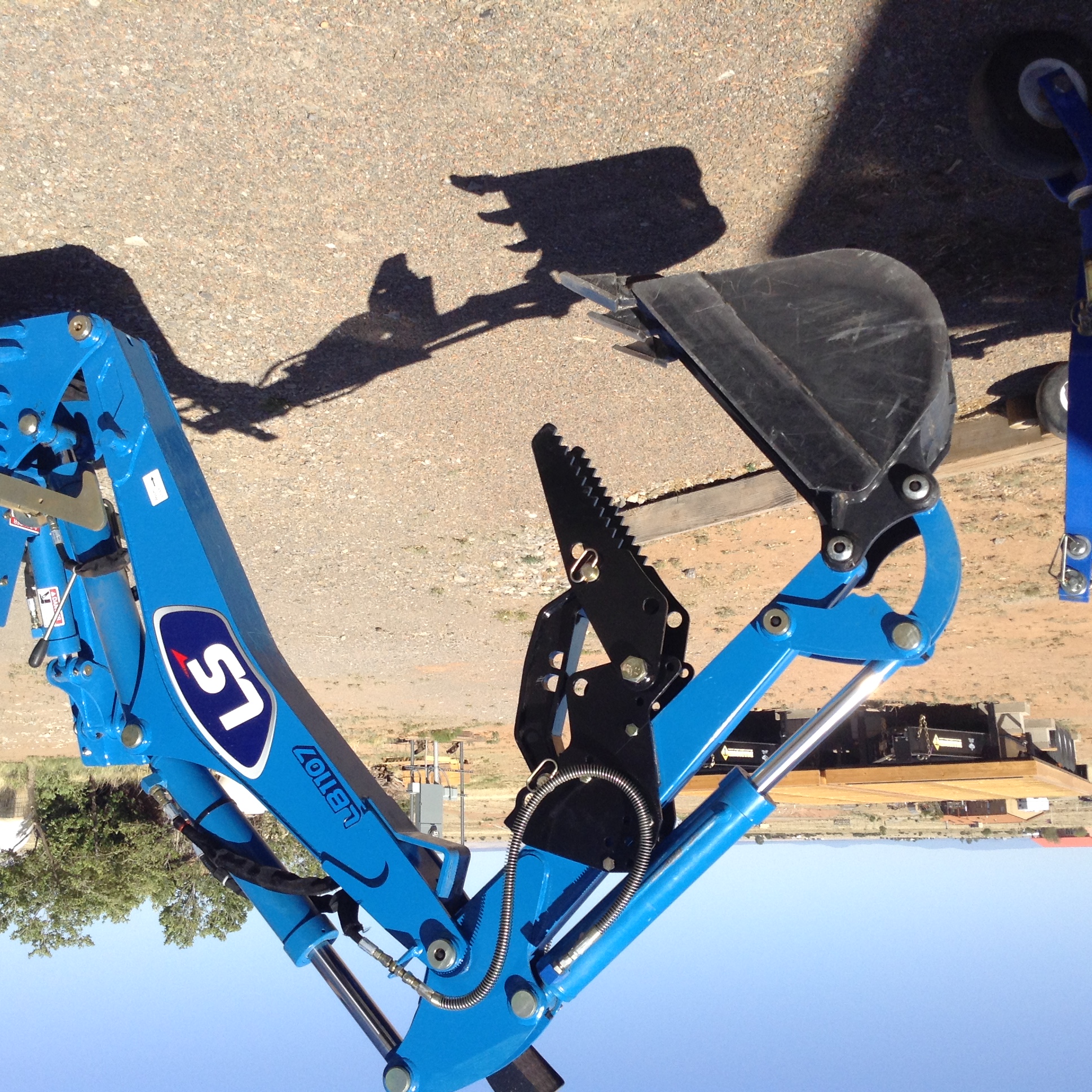

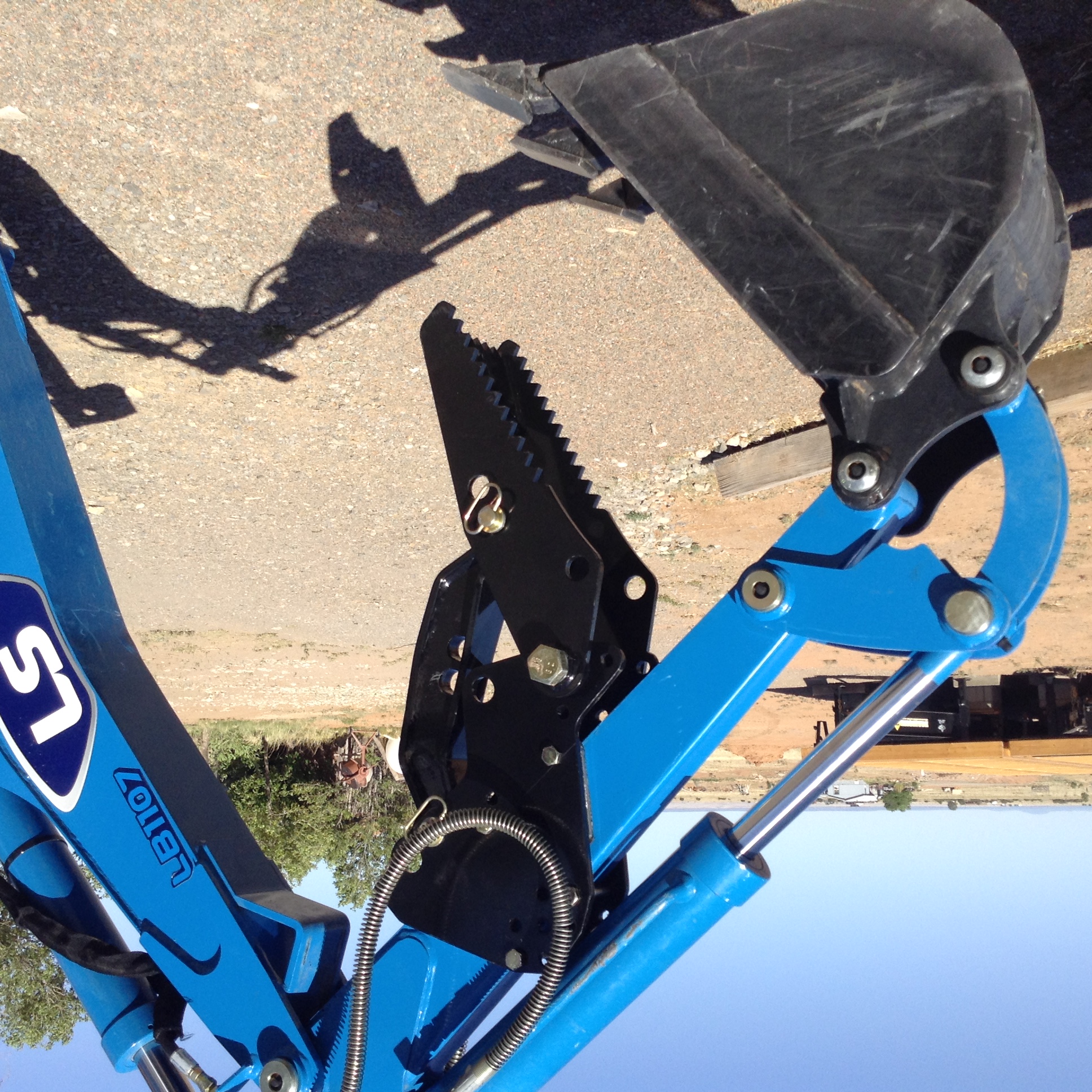

I'm very satisfied with my thumb. It was around $350.00 incl. shipping.
/ Thumb for Subcompact Tractor Backhoe. Need Advice #7
Oh it definitely helps. As GRTkub stated, it's easy to apply too much pressure and break things. If you compare pics, I have mine mounted up higher on the dipperstick. This was to allow me to lift a bunch of railroad ties (kinda spaced it to grab them "square"). I also used it that way to grab bunches of brush out of a pile and put onto a trailer.
