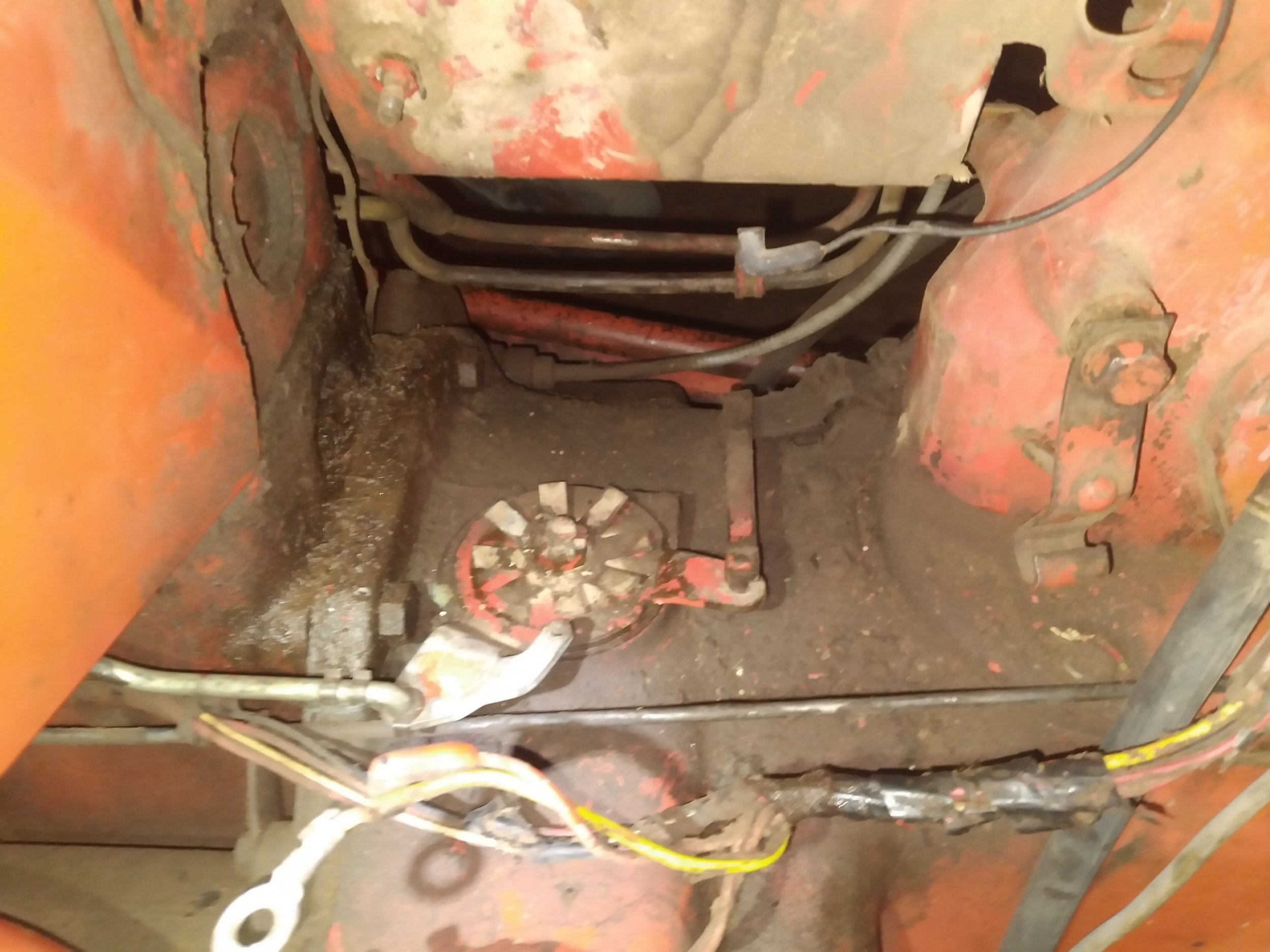

bought a Ford 841 for my son and I to have some fun with. We're tackling a problem with the throttle now. Throttling up we have to hold it open or it springs back to idle. Linkage up front seems ok but at rear there is a tab that the forward rod attaches to that points to the rear that has a hole in it, it look like it at one time either had a spring attached or maybe a thinner rod . There is also a metal tab attached with a loop bent in it behind and under the air filter that looks like it may have had a rod or spring or both that is at the same elevation as the tab with the hole in it. I'm finding the fellow I bought it from , who was the original owner did a fair amount of Jerry rigging to it, so there's stuff not there anymore. Can anyone help? View attachment 712446

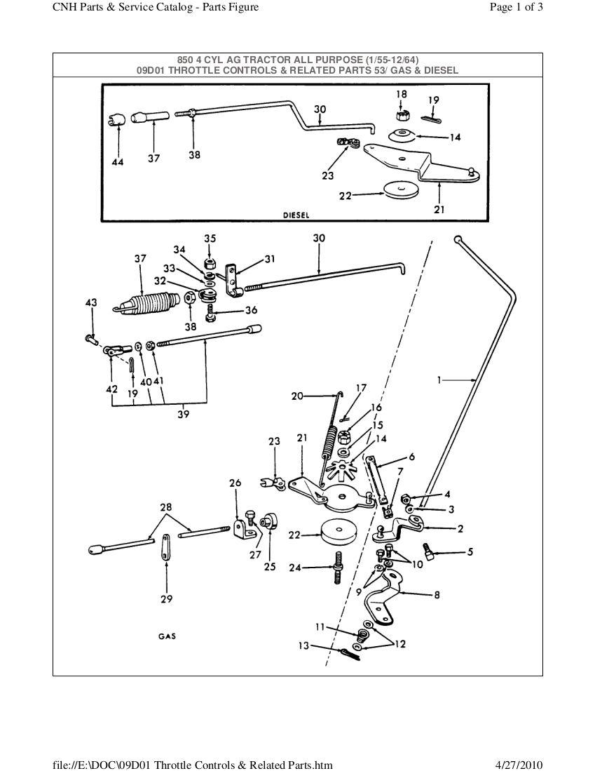

Under the battery box os a pivot point, there should be a fiction disc under that. You may need to replace it or might get lucky and just tighten it up a bit.
Ok, I see it thanks. It actually looks upside down from that picture so maybe its been installed wrong on my tractor.

John0829 is right, friction disc adjusted by lock nut.
