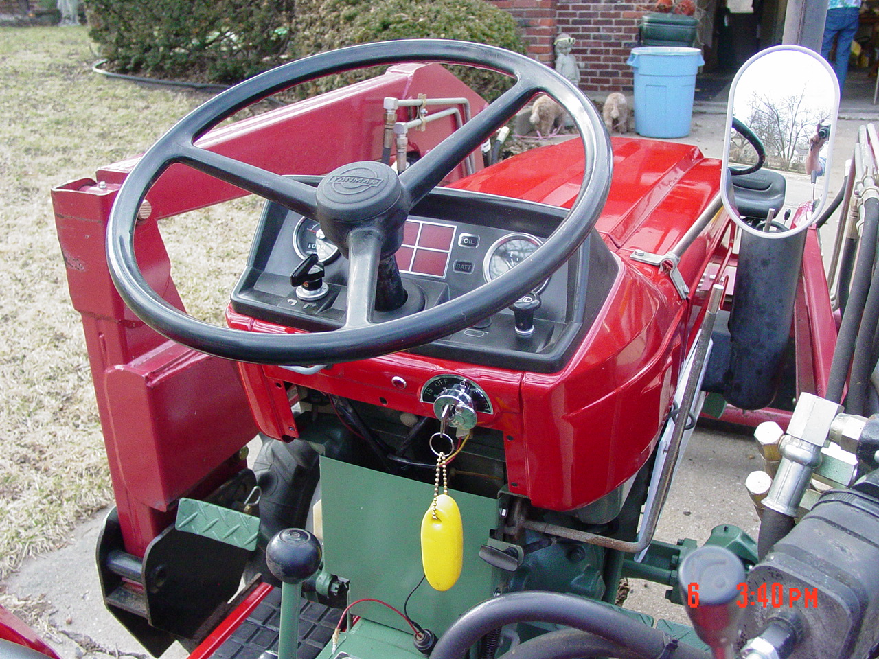

/ Throttle Detent on YM1610D #13
My 1602D does in fact have both a compression release and a fuel shutoff......in this photo, the T-handle on the right, down by the key fob is the fuel shutoff. The compression release can just be seen on the left, below the steering wheel, a grey L shaped lever you pull out.

/ Throttle Detent on YM1610D #14
You are right Jagman and I spoke (wrote) out of ignorance. Sorry to impugn your veracity.;) There is always something to learn. I wrote it and then realized that you were writing from the perspective of a 1602 with which I am not familiar. Sorry.
