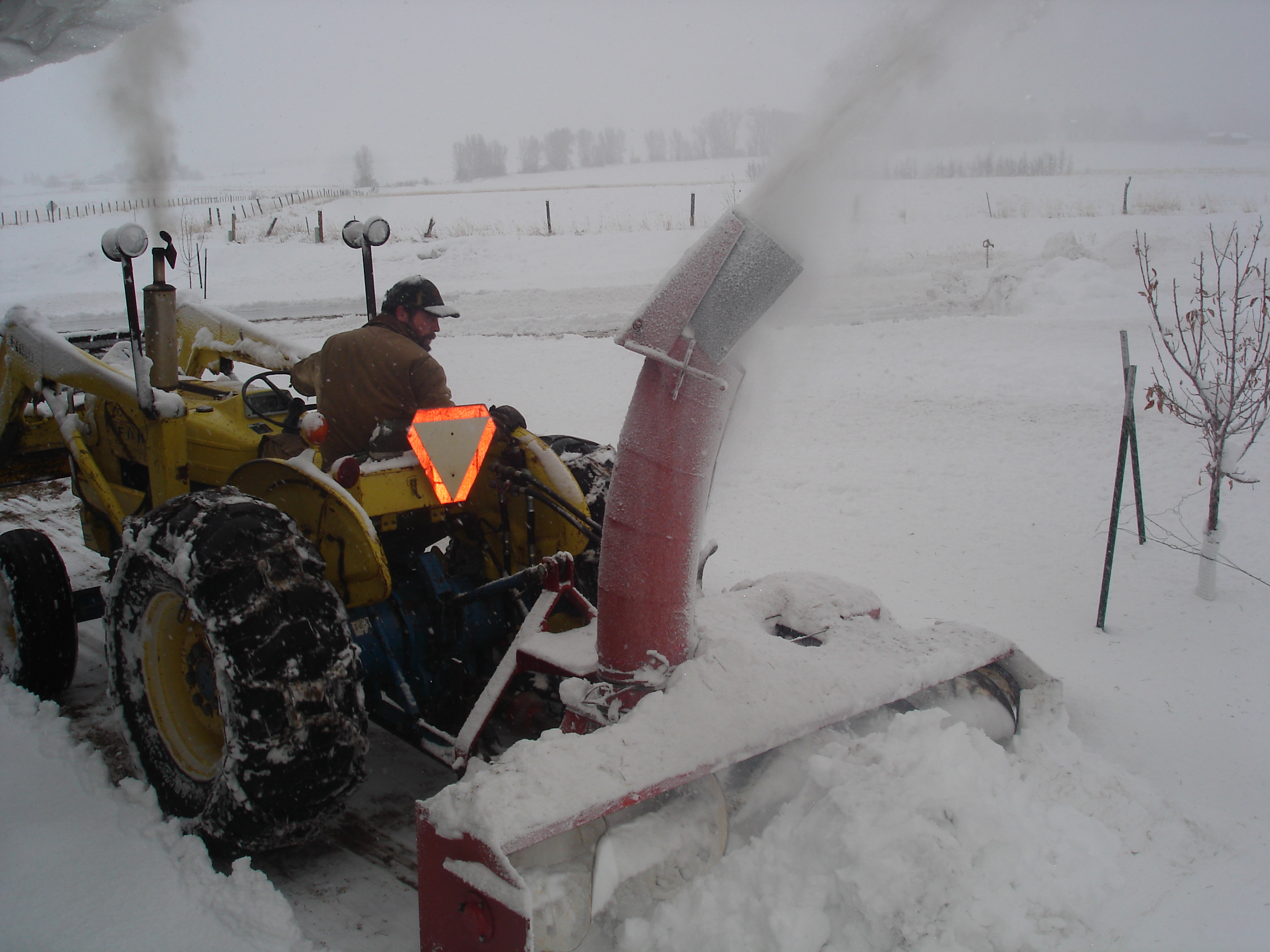

The first was a McKee 84" double auger two stage blower behind a Ford 4400 open station with a live PTO. The tractor was a little under powered for that size blower but as long as I watched my speed I could work my way thru about anything I needed to.

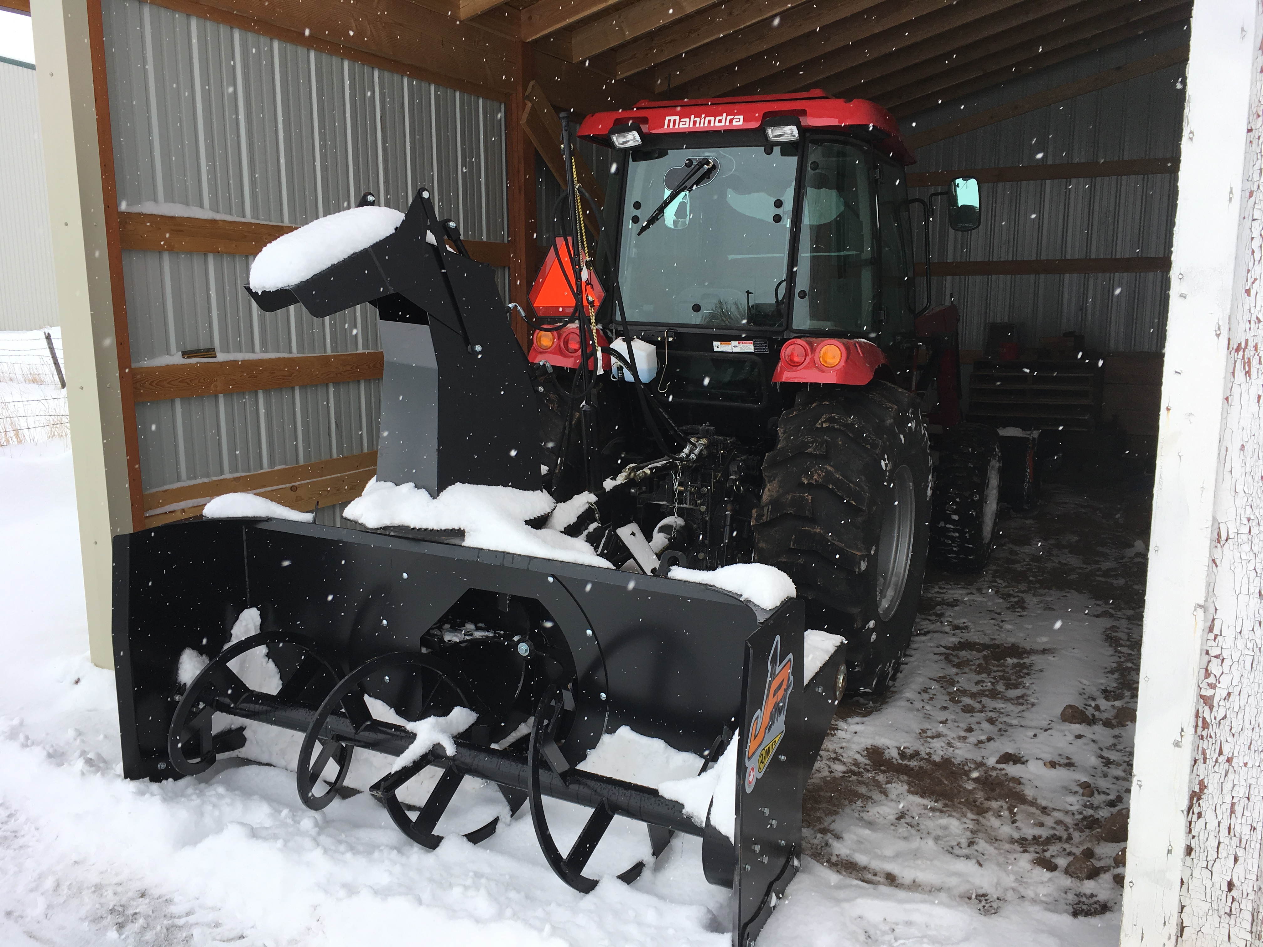

Currently I have a WIFO 78" single auger two stage blower behind a Mahindra 2565 with cab and live PTO. This combination works well due to the tractor having a bit more power and a few more reverse gears so I can match my speed to the amount of snow and condition of the snow.
