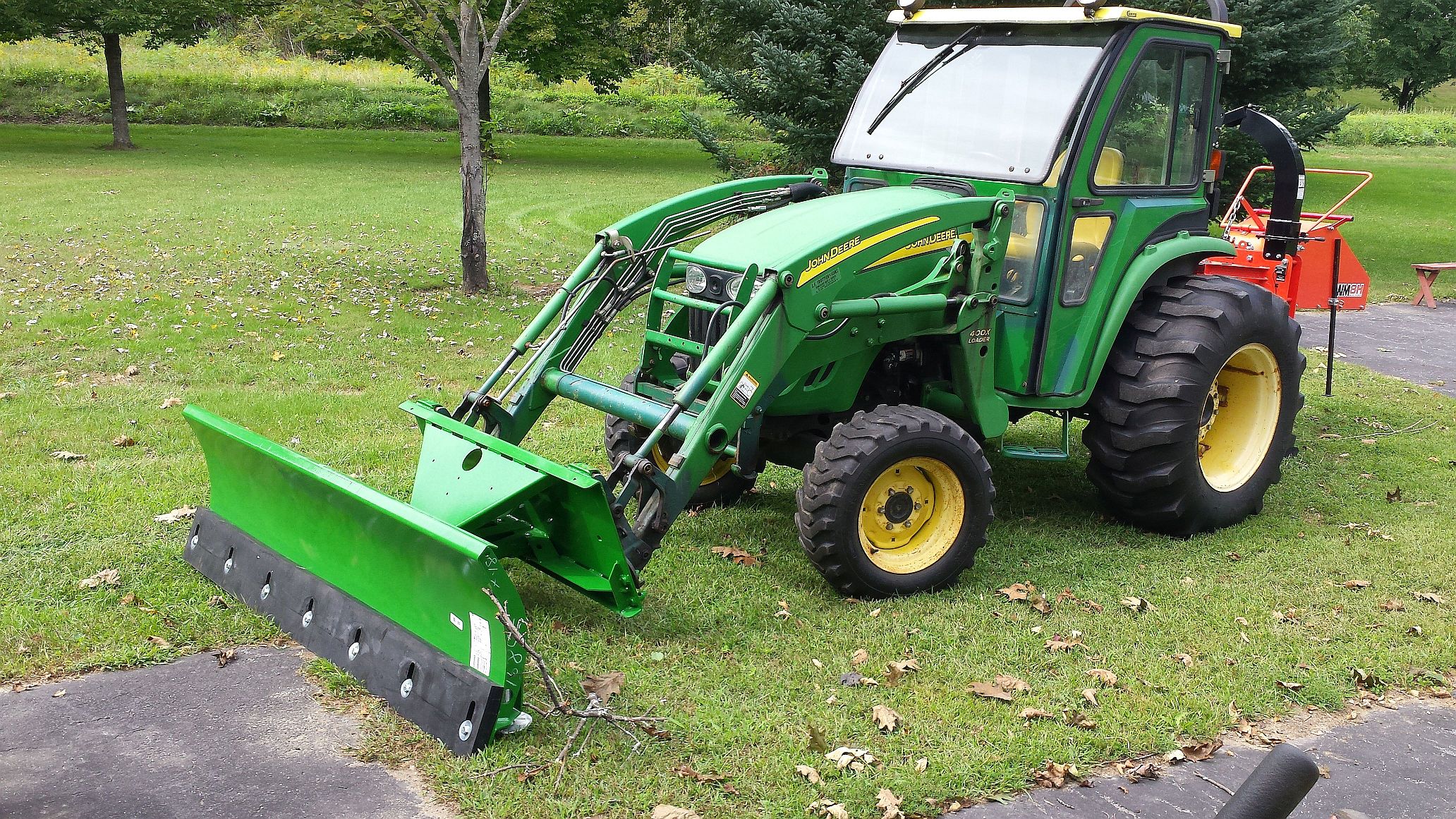

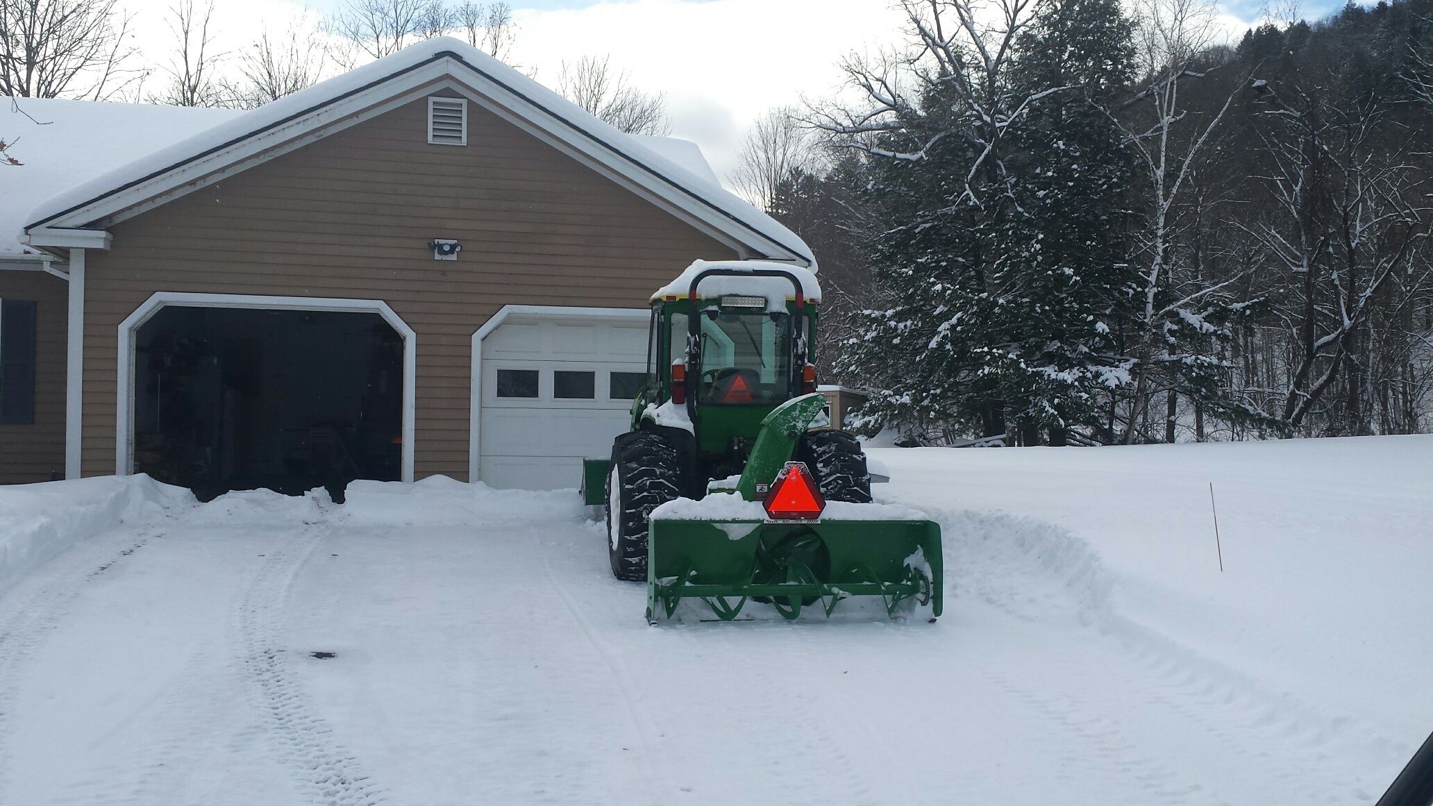

I used the bucket on occasion, but this year I bought a front blade (snow blower on the 3PH) for those lighter (6-8 inches or less)...best of both worlds.
The front blade is a manual angle since I only have one rear remote (used for the snow blower chute rotation). Next year, I'll probably add front hydraulics to the blade...we'll see how help it does this winter...
