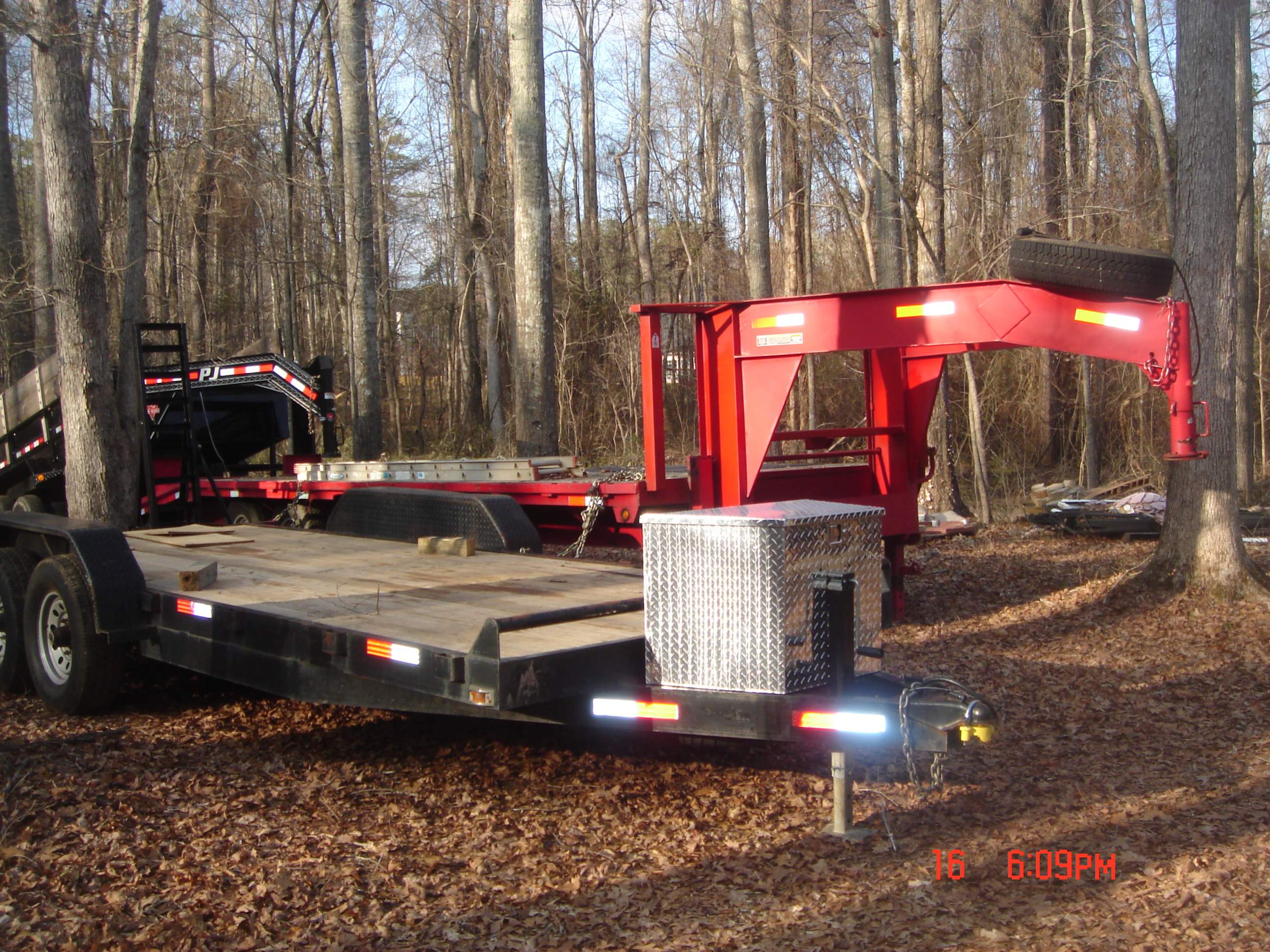

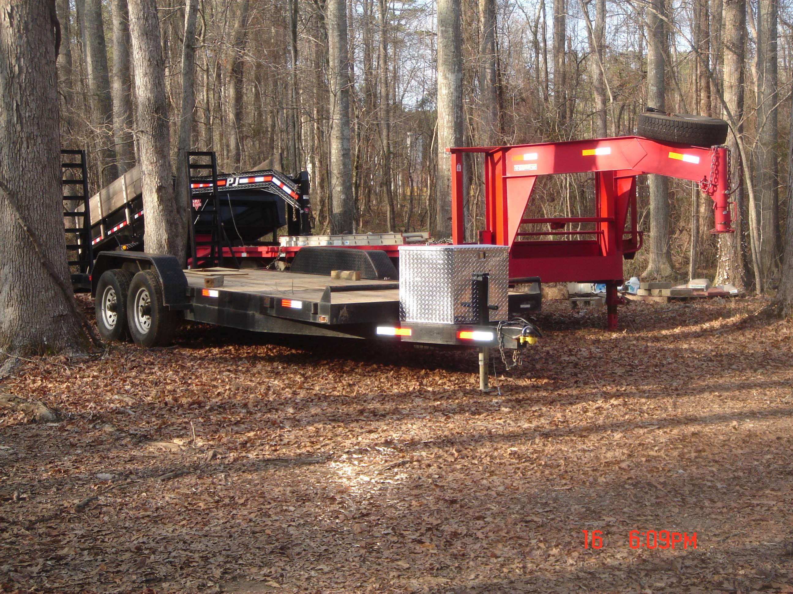

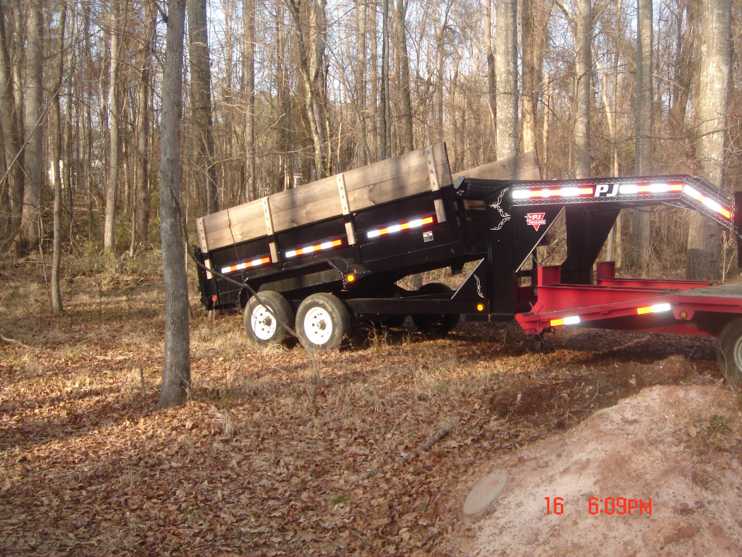

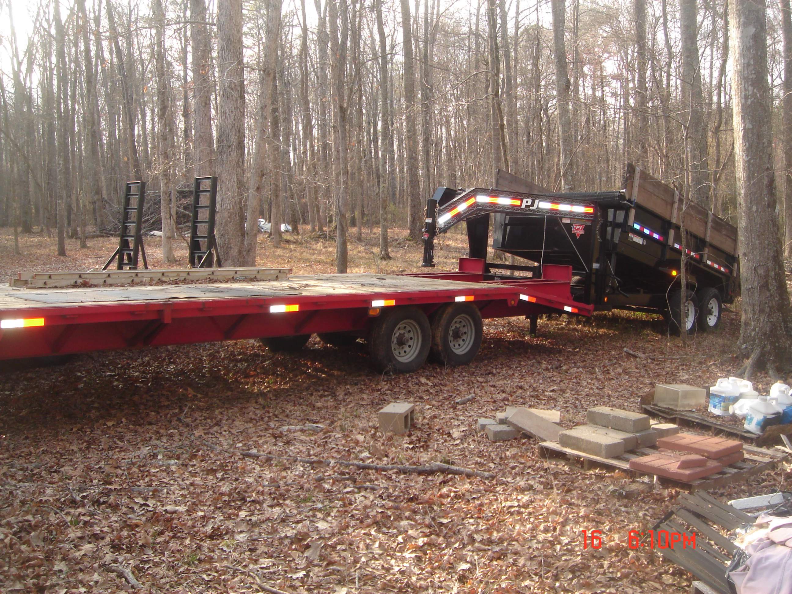

I have a small landscaping/bush hogging/backhoe/Bobcat company as a side business. I currently have 4 different trailers that fit a certain niche: 1.) 7X14 utility trailer single 3500 lb axle for lawn mowers and ZTR's. 2.) 7 X 18 + 2 bumper pull equipment trailer with dual 7000 lb axles for Bobcat and small tractor. 3.) 8 X 20 + 5 gooseneck equipment trailer with dual 7000 lb axles for large tractor and mini excavators. 4.) 7 X 14 gooesneck dump trailer with dual 7000lb axles for hauling dirt, gravel and trash. The gooseneck dump was the last trailer purchased and would also be the first trailer gone if I decided to close shop. They are great for moving material, but are a pain to move equipment with. Even with "D" rings welded in my dump trailer it very difficult to crawl inside and chain equipment down. Also the ramps are removable and are stowed under the deck. The ramps are heavy and I always seem to tear my knuckles up getting them in and out of the storage slots.
In my opinion if I had to go down to one trailer it would not be the dump trailer. I would probably keep the 7 x 18 + 2 bumper pull equipment trailer.
It will be interesting to see with others say since most folks don't have 4 trailers.
