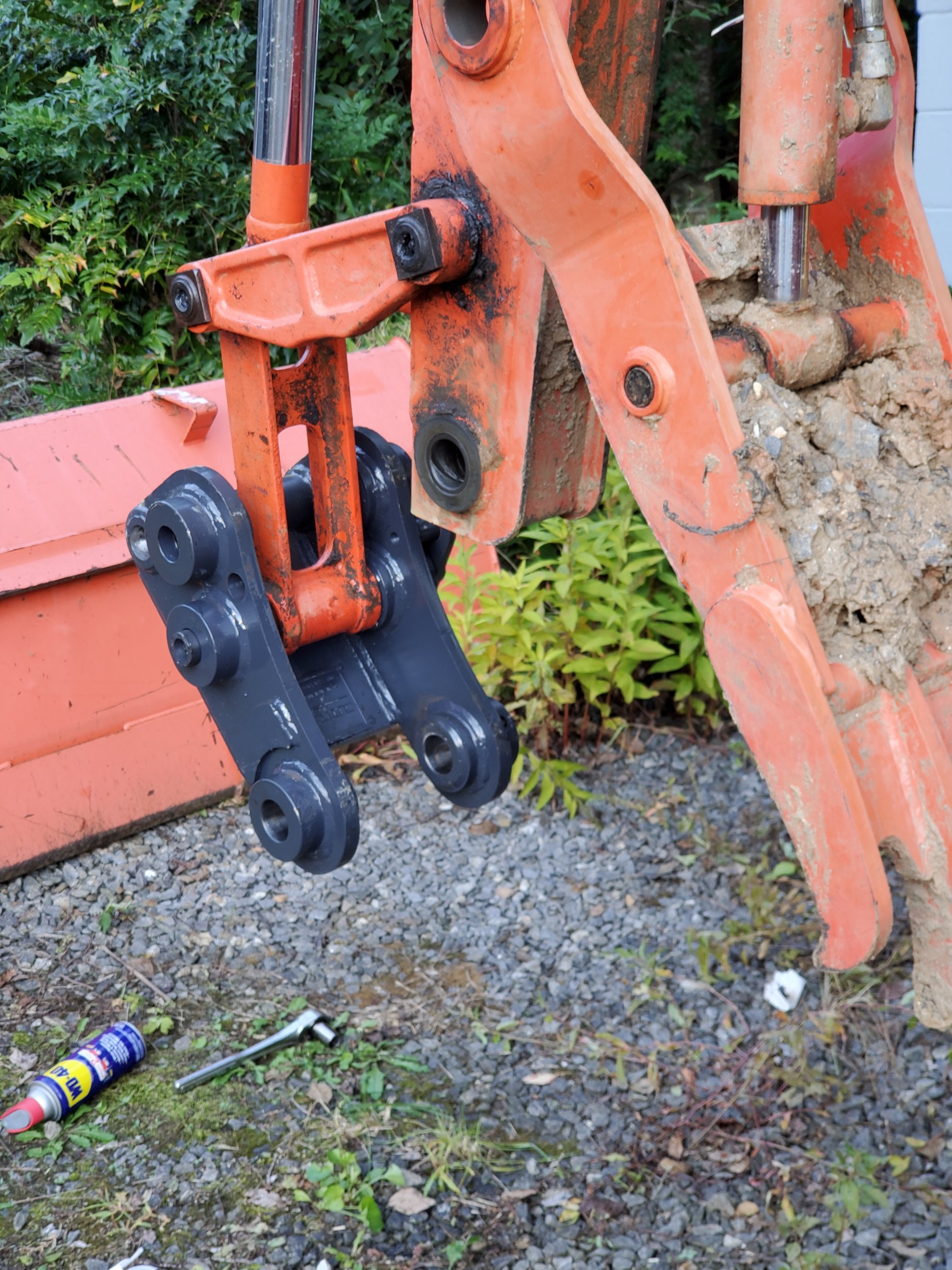

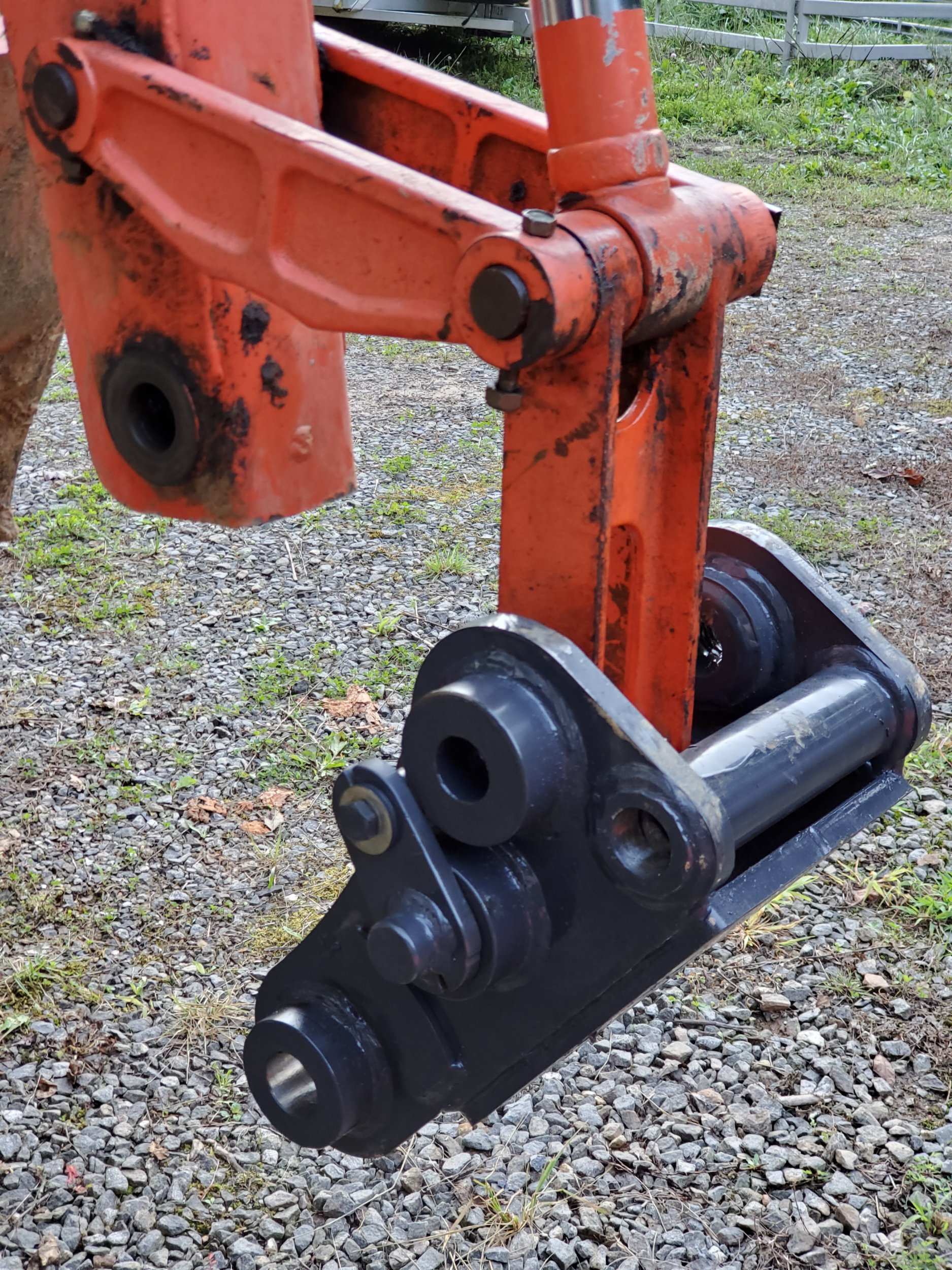

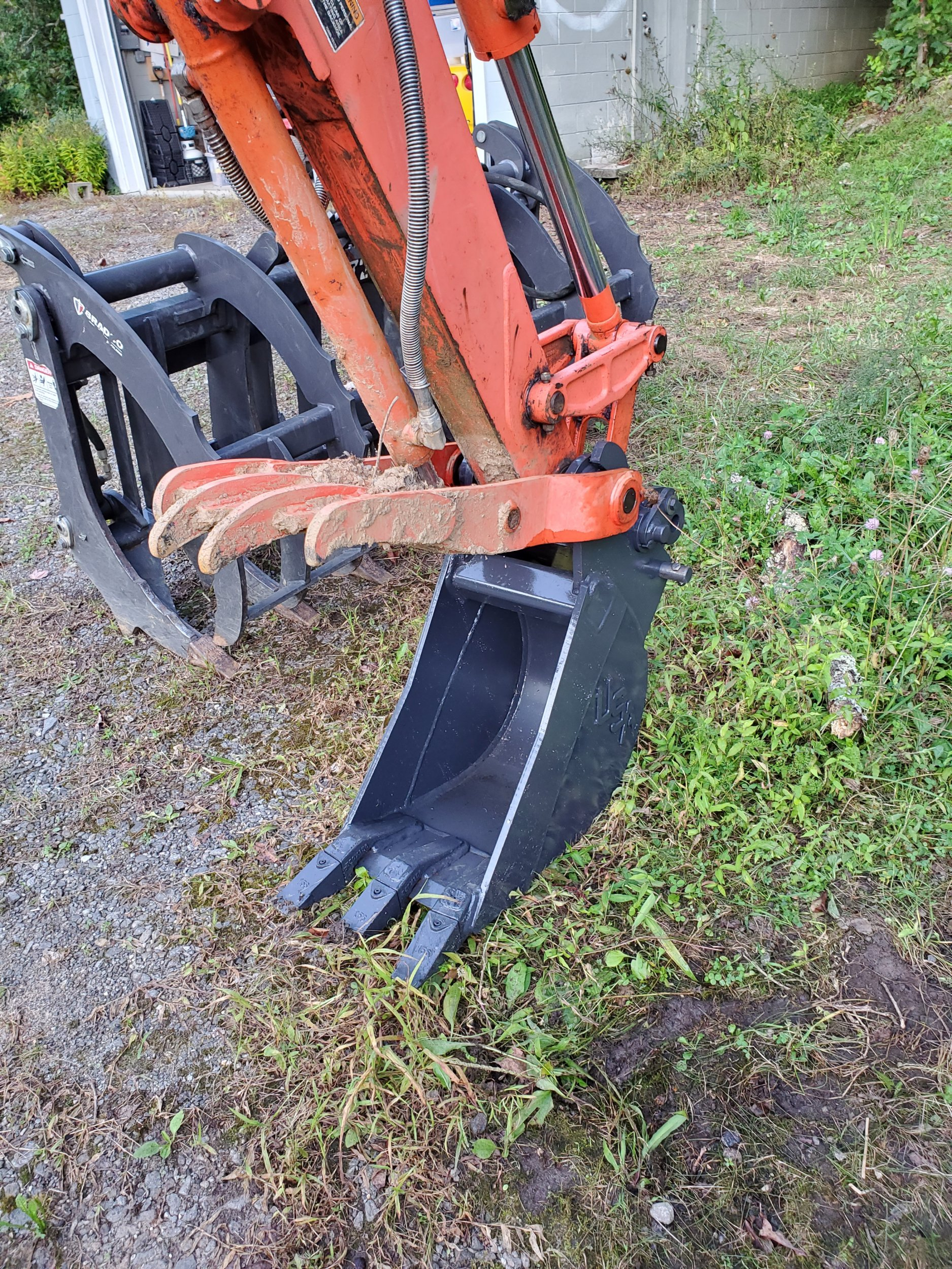

And, for those who like to add to their M59 and also L47 ( since they both use same pin setup on Hoe knuckle ), here are some pics of Quick Coupler adapter for using the KX series of hoe buckets.

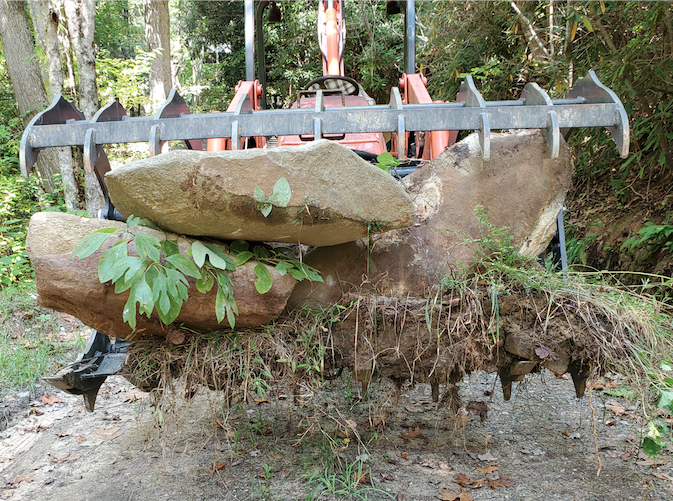

Fun with rocks. :) Dig them out of the ground, make piles, then use them for future projects. These became part of road building to prevent erosion washout. Beats paying good money to buy rocks.
