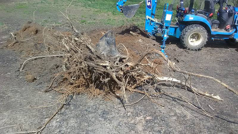

My ground ranges from red rock gravel, densely packed with clay to moderate soil and from rock hard, almost concrete to slippery sticky mud depending on time of year and rainfall.
https://www.tractorbynet.com/forums/attachments/stump1_stump2-jpg.570640/
https://www.tractorbynet.com/forums/attachments/stumped2b-jpg.694538/
I've blown one hydraulic hose and had trouble with joystick rod ends, but no major issues. Nothing bent or broken. I'm at 4 years and just under 500 hours.
I believe the 225 is the next step up from mine, so the BH with it may be even more capable.
