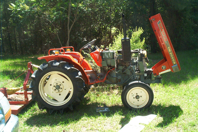

I'm not at the house to check the engine plate, but I'm about sure my YMG2000D had the 3T80 engine also. In my case it is detuned to 20hp at PTO.
