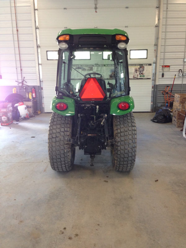

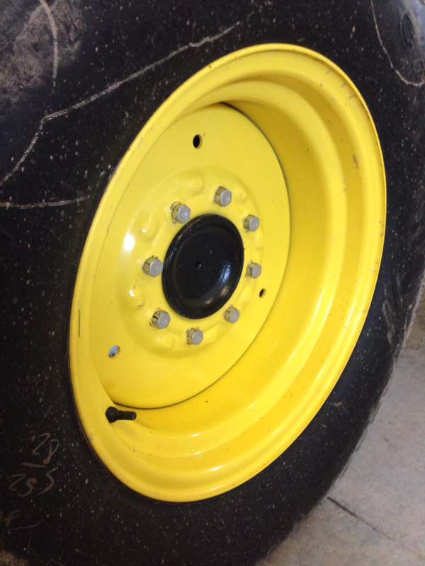

I was thinking the same thing, I asked my dealer if he put them on the "widest" setting possible which he said he did. I just assumed that flipping them was part of doing that, but the stance still seemed kind of narrow to me. I definitely agree that they aren't flipped. Looks like ill just have to do it myself..
Those wheels are definatley not flipped. I have the same tractor and same tires. Those valve stems should be on the inside and when you flip them, they will be plenty wide enough. You don't need spacers. Next chance you talk to the guy that said that the wheels were put at the widest setting, tell him thanks for making sure because they weren't. Your tires are tucked into the wheel wells. As you can see in my picture with the valve stems in and at widest setting the wheels extend past the fenders a few inches
/ Thoughts on 3520 Cab #23
If i remember correctly, the valve stems should be on the inside for max width.
I put wheel spacers on mine as well, and it felt much more stable on hillsides.

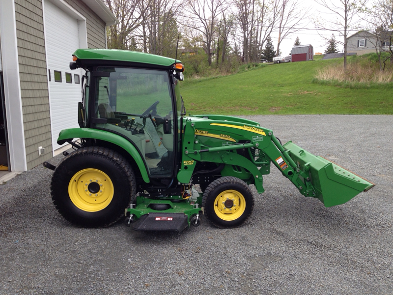

Here she is!!
