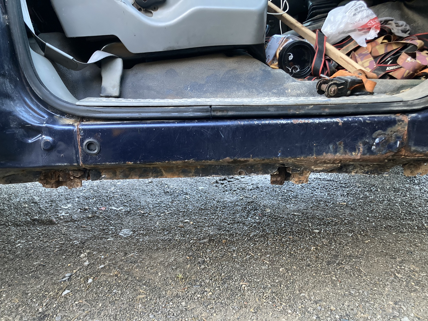

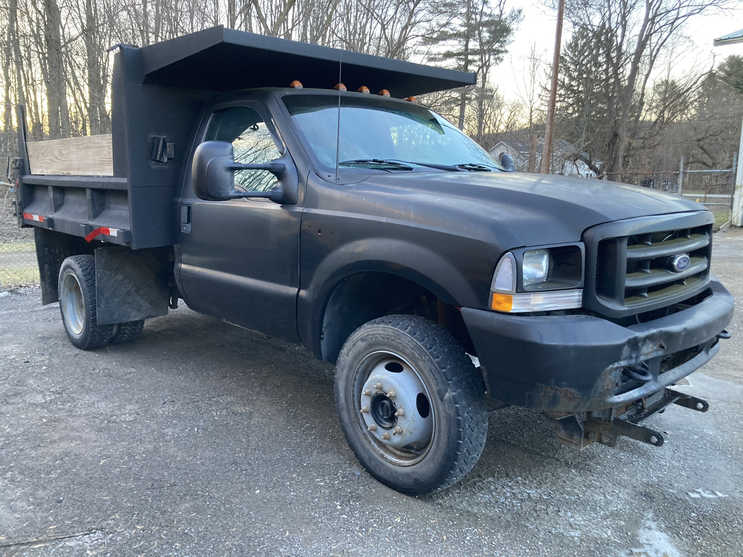

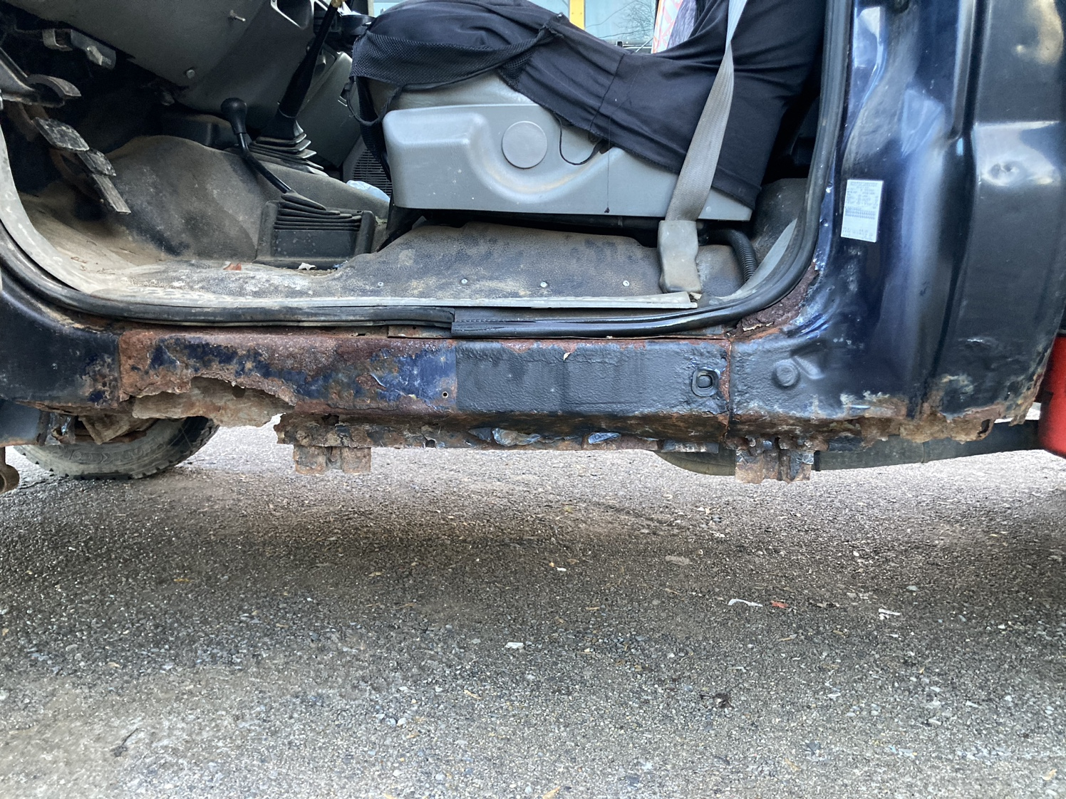

I have an opportunity to buy an 02 F450 Dump. V10, 6 speed, 4x4, engine driven hydraulics for dump, plow, spreader. Unit has about 50k miles. Cab is very rough on door bottoms, rockers, cab corners, floor. The frame and dump are ok.
I realize that I would have significant body work to do. It seems most panels that I would need are available after market.
If I could make a successful offer and get it for say $2000-3500, is that smart or should I just (try to) forget about it?
This would be for personal use on our 100 ac property, and include on road use to get materials, etc.

I'd jump on it if the frame is solid .
Not a fan of 10 cylinder, but I have limited knowledge of that engine having never owned or been in one.

I love my rusty F250 but have learned the rust does affect things you can't see. Mine isn't as rusty as the pic. Over the two years I've had to deal with the following due to rust;
Rear brake backing plates. metal brake lines, metal parts of brake hoses, currently the radiator mount and bed mounts need replacing (probably wood on a dump). trans cooler lines (you don't have them with 6speed) Just an idea of what rust can do to a low milage (70k) never abused 2004.
Electr grounds decline, bad bad bad

Doing the brakes which is likely required for safety would be $2k. I expect. Lines, booster, calipers etc. Budget $5k total. It is sort of a sinking ship with a few cruises left in it. Best of luck. Clutch sound OK? No Slippage?

Cab corners, inner and outer rockers are simple to replace. The corners can be replaced using structural adhesive, rockers are simple to mig weld in. Door bottoms are available, but southern doors are available from entrepreneurs in most little towns.
