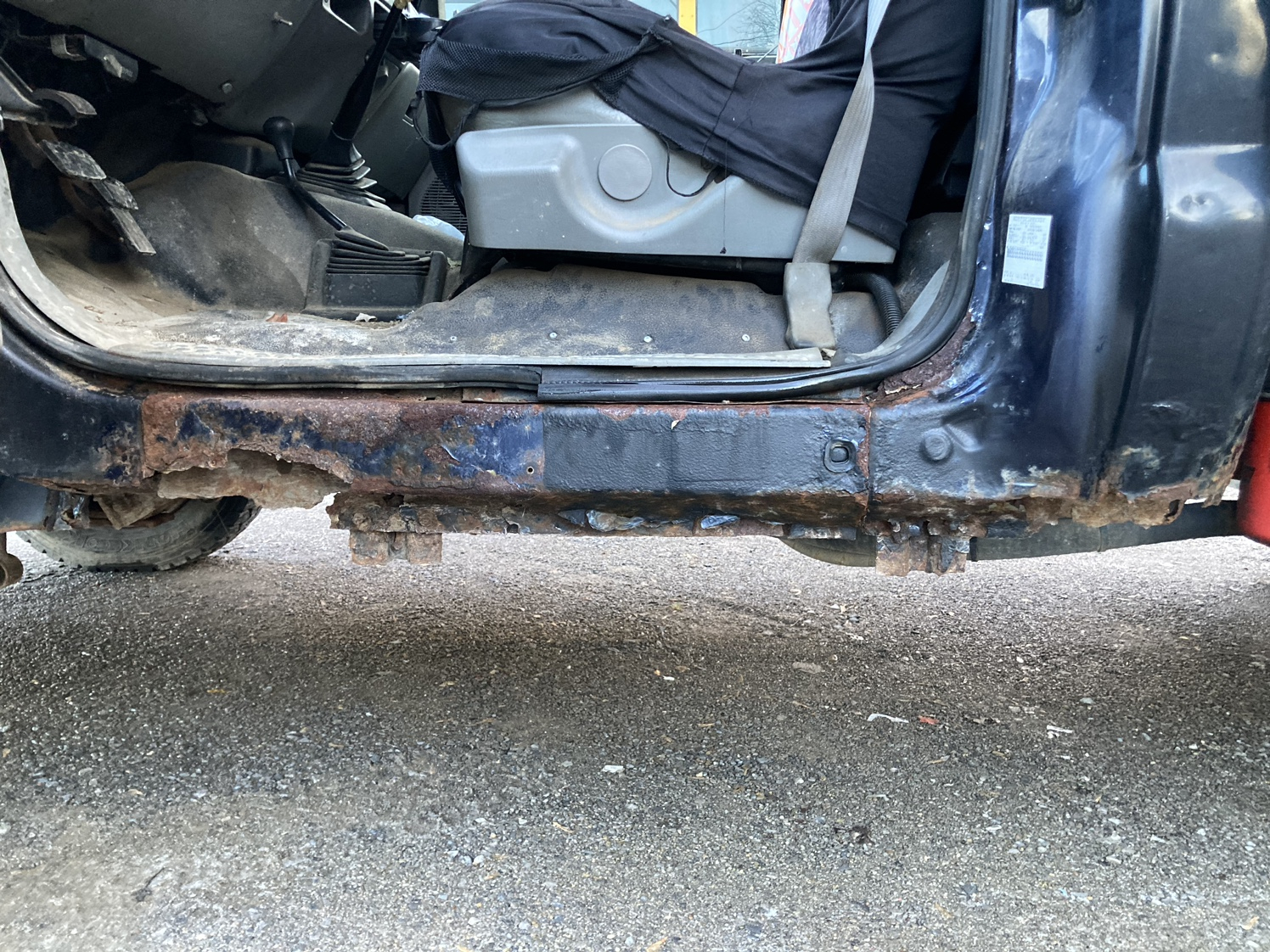

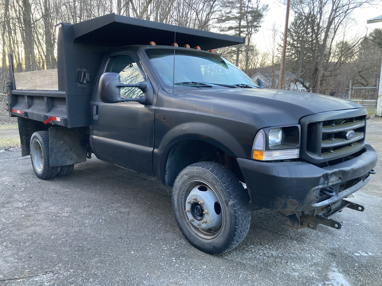

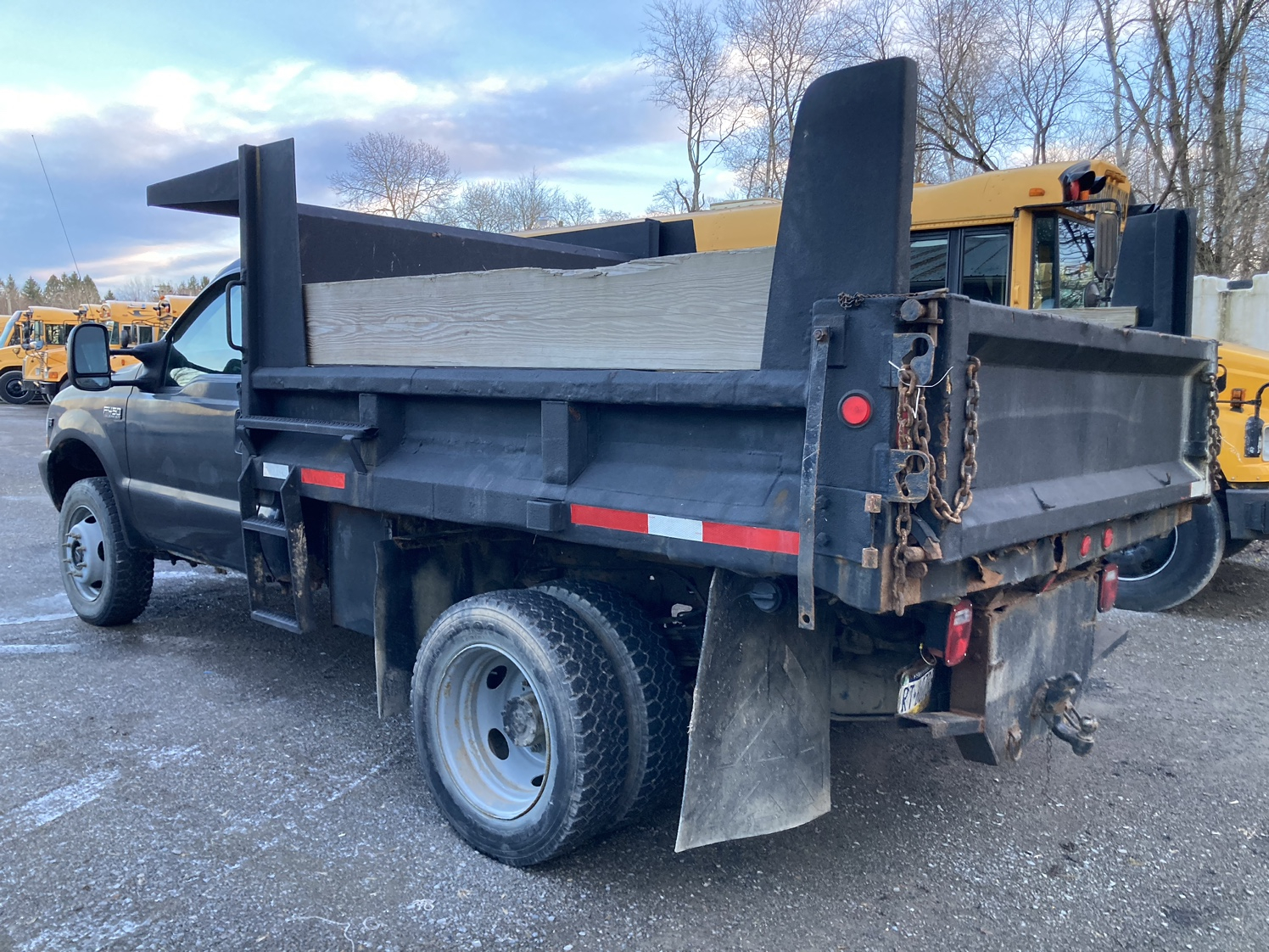

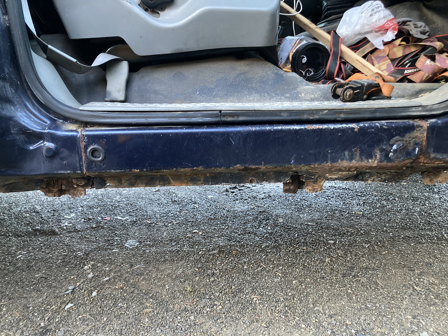

I have an opportunity to buy an 02 F450 Dump. V10, 6 speed, 4x4, engine driven hydraulics for dump, plow, spreader. Unit has about 50k miles. Cab is very rough on door bottoms, rockers, cab corners, floor. The frame and dump are ok.
I realize that I would have significant body work to do. It seems most panels that I would need are available after market.
If I could make a successful offer and get it for say $2000-3500, is that smart or should I just (try to) forget about it?
This would be for personal use on our 100 ac property, and include on road use to get materials, etc.
Insurance for limited use is quoted at less than $250/yr liability only to be added to our existing policy.

If the plow came with it, and you have snow removal needs, I would say definitely. Even if not, it’s still a good buy for occasional use.
Rust bothers me, so I tend to buy trucks with mechanical issues and solid bodies, but that’s just my preference. Once rust sets in to that degree, it’s a pain to fix.
The Ford V-10’s were known for spitting out spark plugs from the heads. Check for that, too.

Lot of work whether you'd replace the rotten panels, or the whole cab.
It's probably just as rusted (hidden), everywhere else also if you start checking & opening up things like brakes etc.
No idea what those are selling for, but $3000 - $3500 sounds like a lot for a drive train, frame & dump bed to me.

The initial owner was a municipality. The second/current owner is the bus company, which I work for part time.

Unless you initially only have a compact truck or 1/2 ton to pull it. In my brief searches for dump trailers they are pricey these days, even smaller 7-10k ones. It's nice that f450 runs the dump bed with a pump off the fan belt I believe vs other methods. Worst case you can make a dump trailer out of the truck or at least I'd try doing that.

The price sounds good but having fixed rust on classic cars and one pickup, I wouldn’t put a dime into the body. It’s a never ending battle. You might have to do some, so your feet don’t drag on the ground.

Yeah, PA state inspection doesn’t allow for holes in the body, so some work required…

I think for that money this truck as long as its operational will never be worth less and it's going to be very easy to get your investment back.
I've got a 99 f450 for my acreage. It's rust free and never goes out on the street from December to April. It beats the he!! out of a trailer and a suitable towing vehicle.
