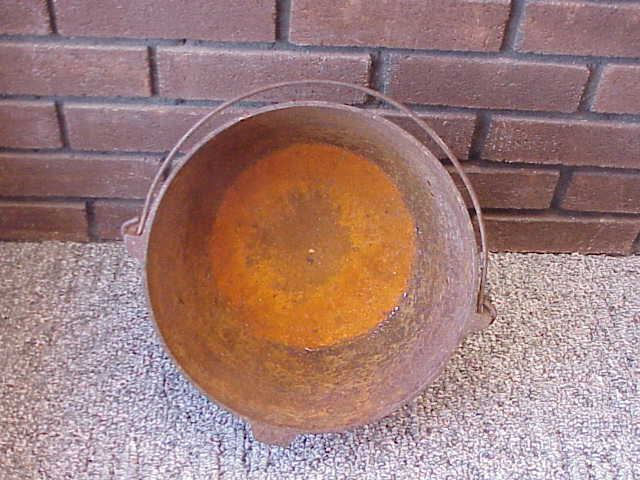

No I am not talking about Mike, but about the rusty pot that I pictured in another post. If you would like to read that one, it is called Rust and Cast Iron. Today, I decided to take on the challenge of cleaning this pot since the weather was on the warm side. I started by spraying the pot with oven cleaner on all surfaces. Please hold all questions until I finish the pictures posting (about 20+) and the text. I figure this might take as long as 2 hours. Thanks

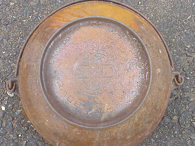

#2

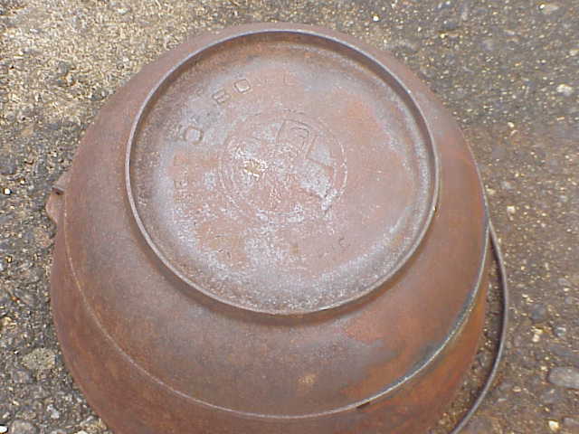

This is the bottom side before I had done any cleaning. This pot came from a flea market and has been waiting for the right day to be cleaned. Usually I won't work on one that is this bad, but I considered this one a challenge since it is a rare pot.... as far as pots go..... /forums/images/graemlins/grin.gif

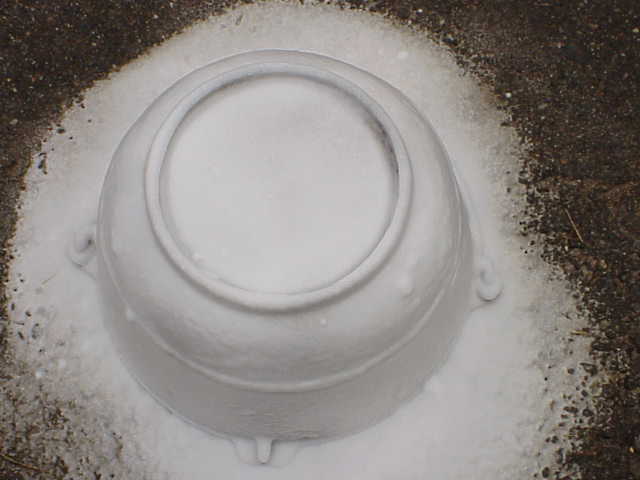

/ This Old Pot......
this is the first application of oven cleaner. I try to get a good coating the first time, but breathing in the fumes usually makes that a difficult task, that is why it is done outside.

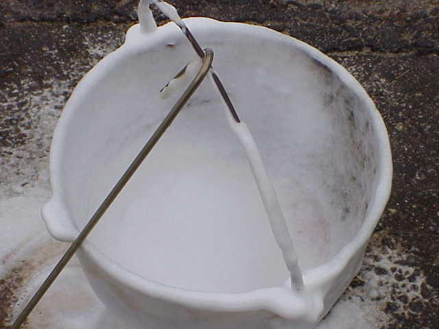

I use this wire hook to turn the pot over so I could spray the inside also. Since the post sits on a ring at the bottom, all surfaces are covered and cleaning is done at once.

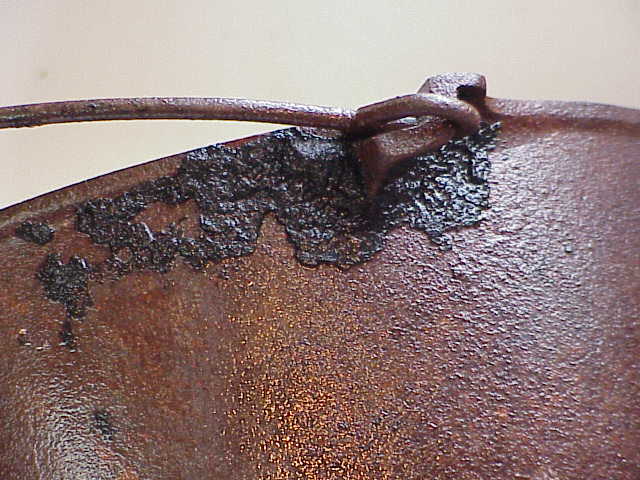

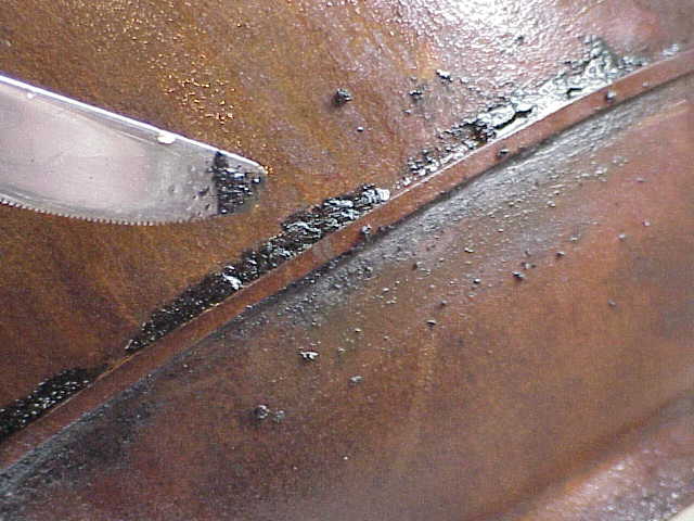

this is hard work... Here is the side of the pot where some old baked on crud has been exposed. This is then scrapped off using a kitchen knife with a serrated edge and a rounded point. It will come off easily with just some scrapping after the oven cleaner does its work.

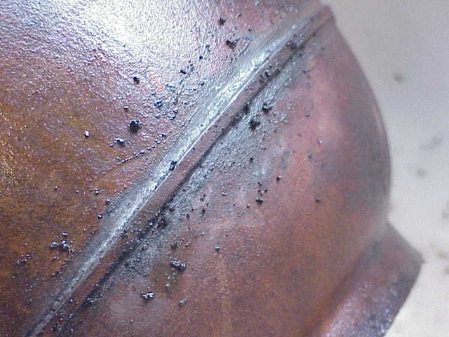

In this picture, you can see how hardened crud has been scrapped off along the center trim ring of the pot. I will then wash the pot with soap and water to make sure that I have gotten all the bad spots removed.

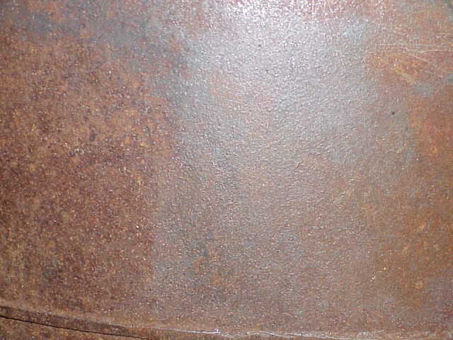

#9
In the center of this picture, you can see the grey area where this pot is totally cleaned. To the left of this there is still some rust that will need to be worked on. This is a very rusty pot...

OK ..... I am slow....... This is the bottom of the pot after the initial cleaning with oven cleaner. It still isn't clean enough for my standards.... /forums/images/graemlins/frown.gif
#11
Here the pot gets its second coating of oven cleaner. I am not making as much progress with this pot as I had hoped to. I am now into about 2 1/2 hours of cleaning time, not counting the amount of time that I was waiting for the oven cleaner to do its work.......

Bottom side after the second cleaning and at this point, this is acceptable for the bottom surface. It isn't perfect, but once the final seasoning is done, no one will know the differance.

#14
This is the inside of the pot. As you can see this is deeply pitted and the pits are holding the rust. At this point, I broke out the heavy guns and used toilet bowl cleaner to remove the rust from the very worse of the pits. The toilet bowl cleaner is a acid and the oven cleaner is a alkali (lye), so as you can see, there are different ways to attack the problem. If I find that I don't get good results with the toilet bowl cleaner, then I will move onto using muriatic acid. The only problem with using acids other than the safety factor, is that they will also remove good metal along with the rust. For this reason, you have to be careful how long you keep it in contact with the cast iron. I have not worked on the sides of the pot very much yet, but I will continue on that tomorrow. The inside of the pot might require glass beading to get it to the point where it is ready for seasoning. All rust must be gone before seasoning, or the seasoning will not take very well.
