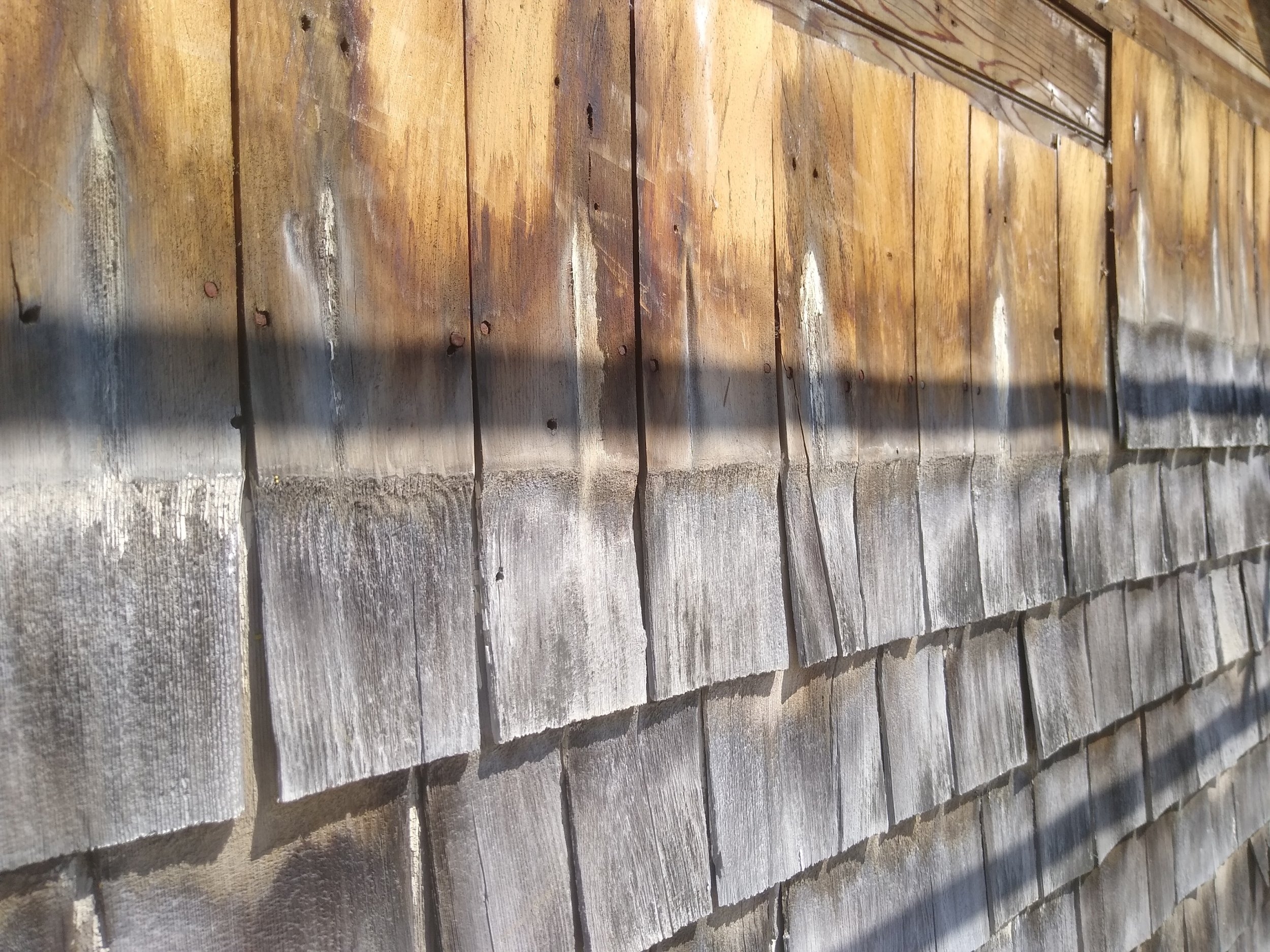

Since I'm opening up the wall from the outside, I'll probably reshingle that side too. It's time. The shingles are white cedar, and over time they literally burn away in the sunlight. Here's a picture from another wall showing how the exposed part has lost a lot of material:
The shingles on this wall have gotten really thin, maybe 1/8", and quite a few of them have broken off.

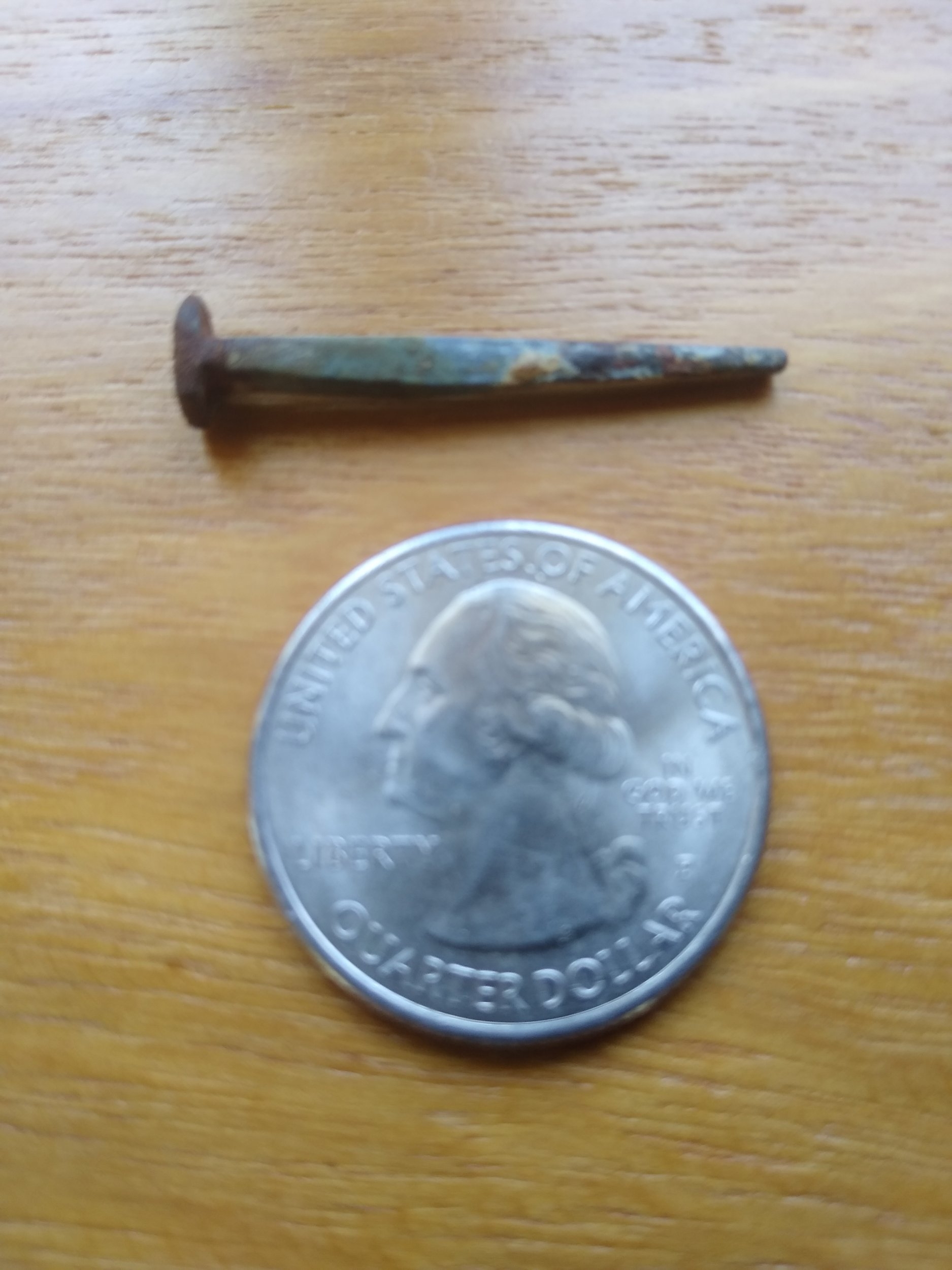

I don't know how old these shingles are, but they were put on with hand-cut nails, here's a close-up with a quarter for scale:

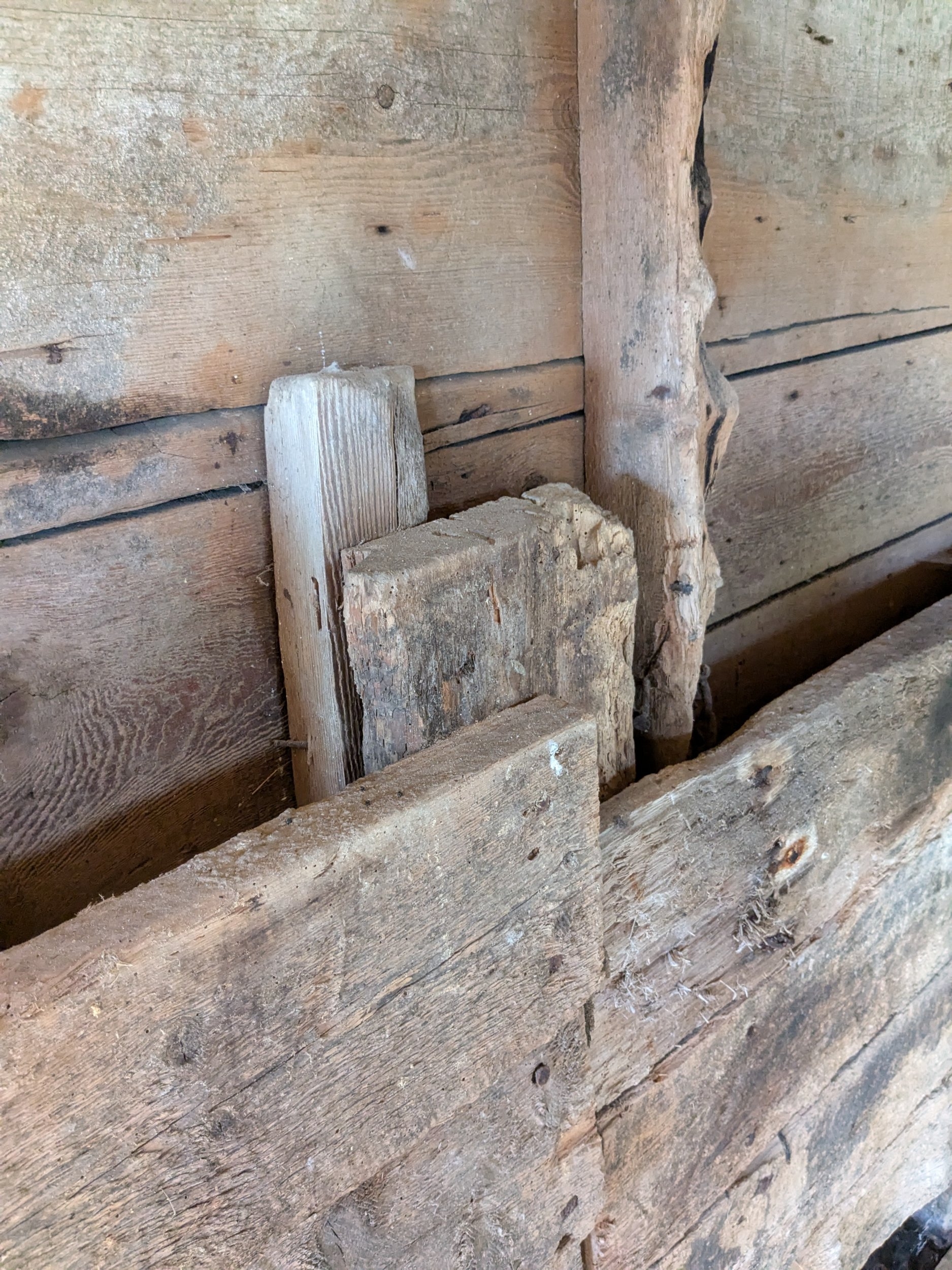

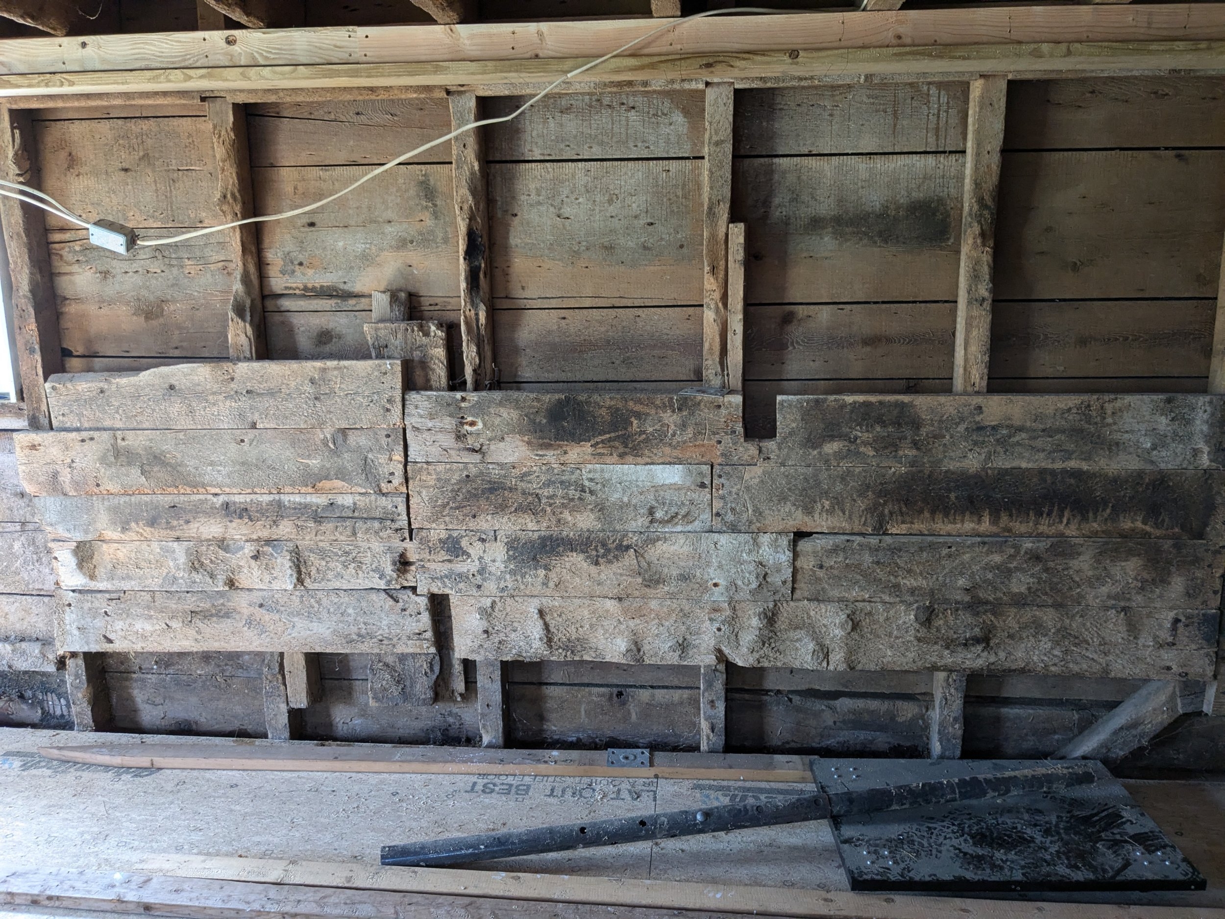

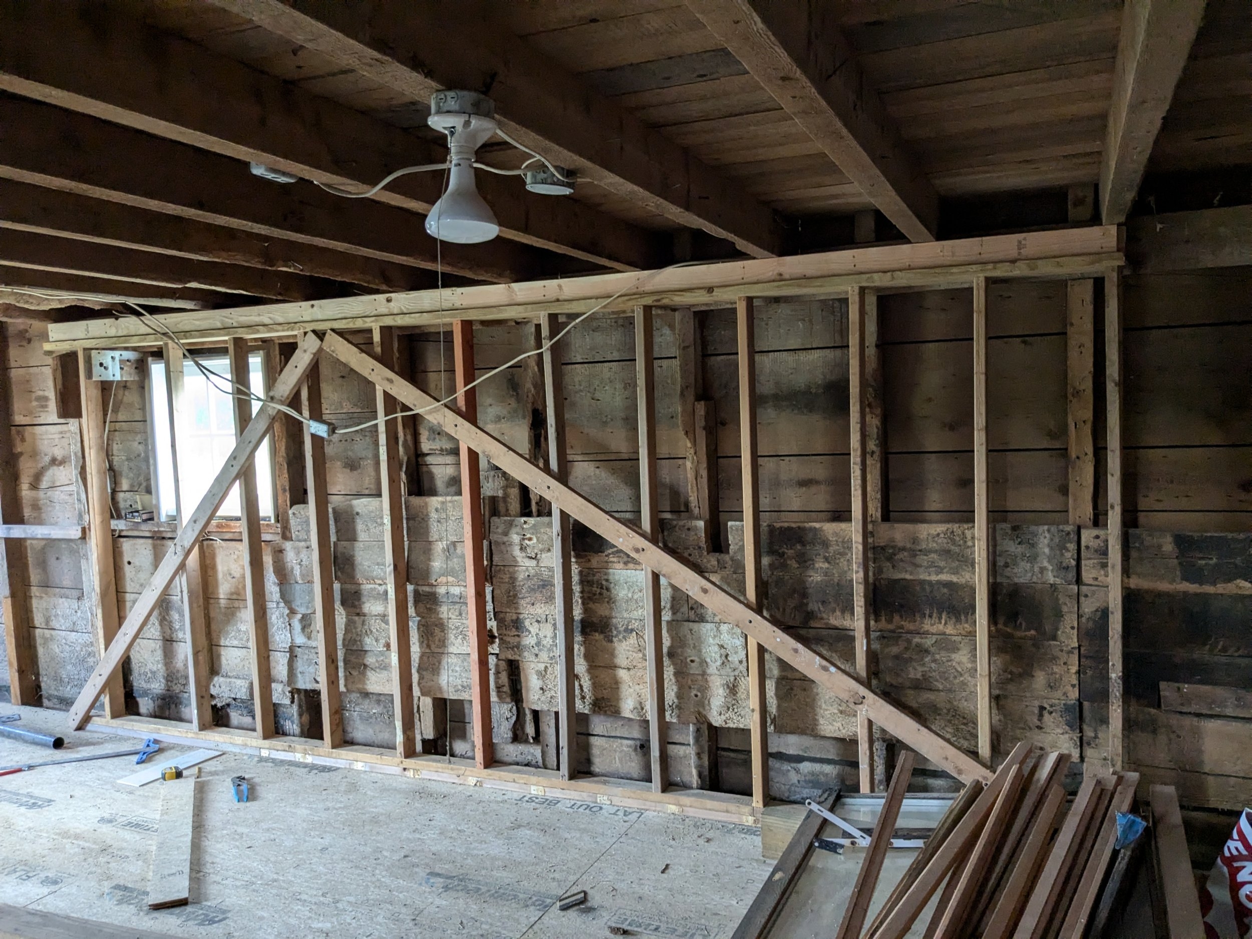

This is a picture of the wall I'm going to be working on. This is where the horses were kept, the studs were all chewed up by the horses. At some point 2" thick boards were nailed to the wall to protect it. I was worried that those boards are now contributing to holding up the wall, so I wanted to brace the wall before taking them away.
There is a hay loft above this section. There is a ledger board let into these studs, and that supports the loft. My first thought was to brace the joists of the hay loft. That would allow me to put the bracing far enough away from the wall that I could get in there to work. But it turned out the joists were just sitting on the ledger, so bracing them didn't brace the wall. So I had to brace the ledger, which meant working close to the wall.

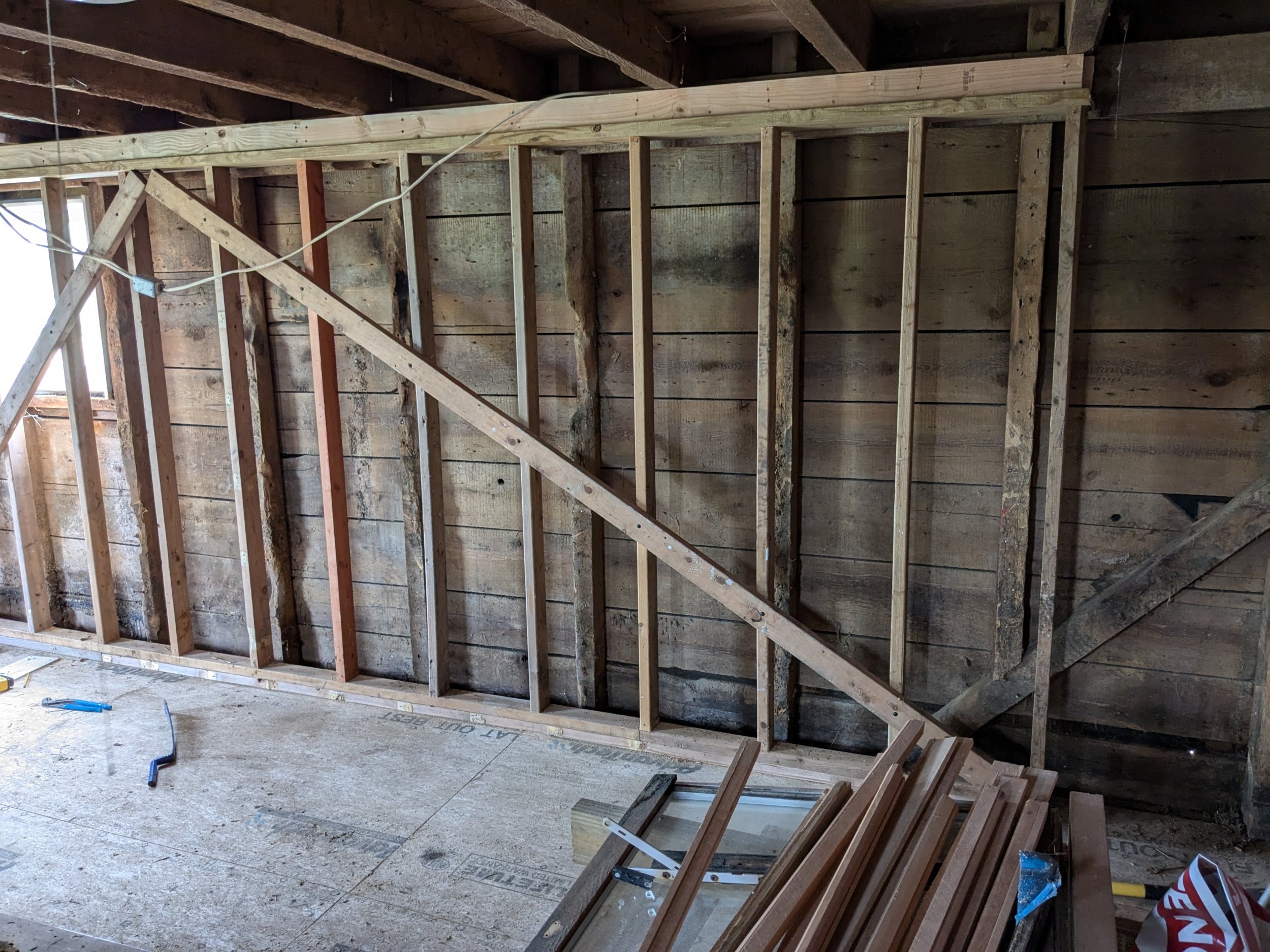

First step was to bolt a 2x4 to the ledger, up against the joists. Then I screwed two other 2x4's to it, and put a 2x6 along the bottom:

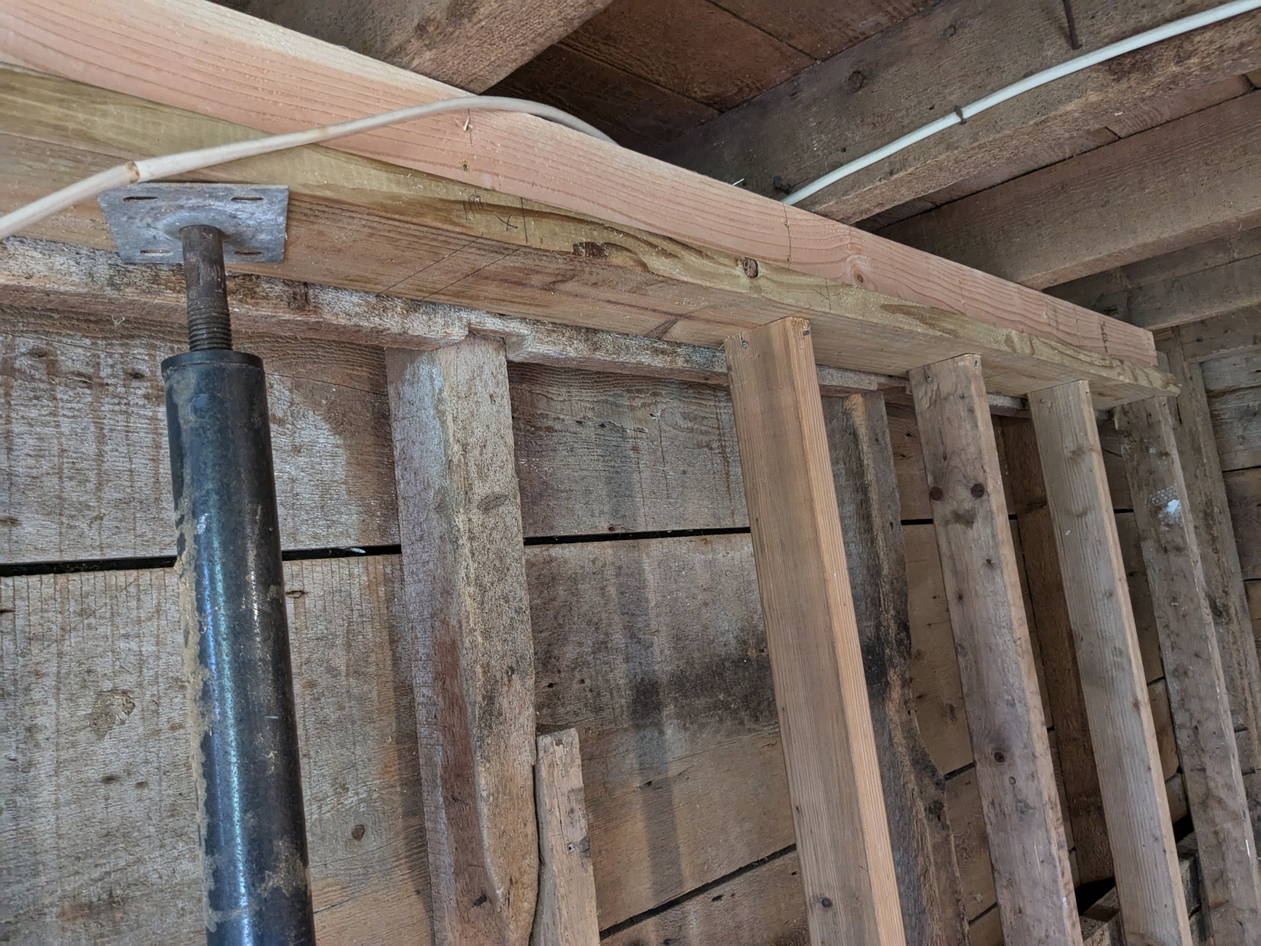

Before putting up the 2x6, I laid out marks for studs on 16" centers. I put down a doubled 2x4 for a bottom plate, and measured the distance to the floor at each stud. My plan was to cut the studs the same distance longer than the measured distance, jack the top plate up and put the studs in. By measuring all the distances before doing any jacking I made sure the top plate would be lifted by the same amount across its length.
This is a shot of jacking up. Usually in an old building there's a fair amount of play, so I cut the first stud 1/4" longer than the measurement. I was quite surprised when I tightened the jack as much as I could and couldn't get it in. I cut it back to 1/8" over and that's what I did for all of them. That was encouraging to me, it meant the wall was stronger than it looks.
OK, the finished wall. I added a couple of diagonal braces. I wanted to use duplex nails for the diagonal braces to make it easier when I have to take it down, but I couldn't find them at the store. They did have #9 screws that were labeled "structural," so I used those instead. Perhaps that's why they don't sell duplex nails any more.
With the bracing in place I could take the boards off and get a look at the wall. I mostly used a sawzall to cut through the nails. It's not too bad. Every one of the studs looks like it will need to be sistered but otherwise the wall looks in OK shape.

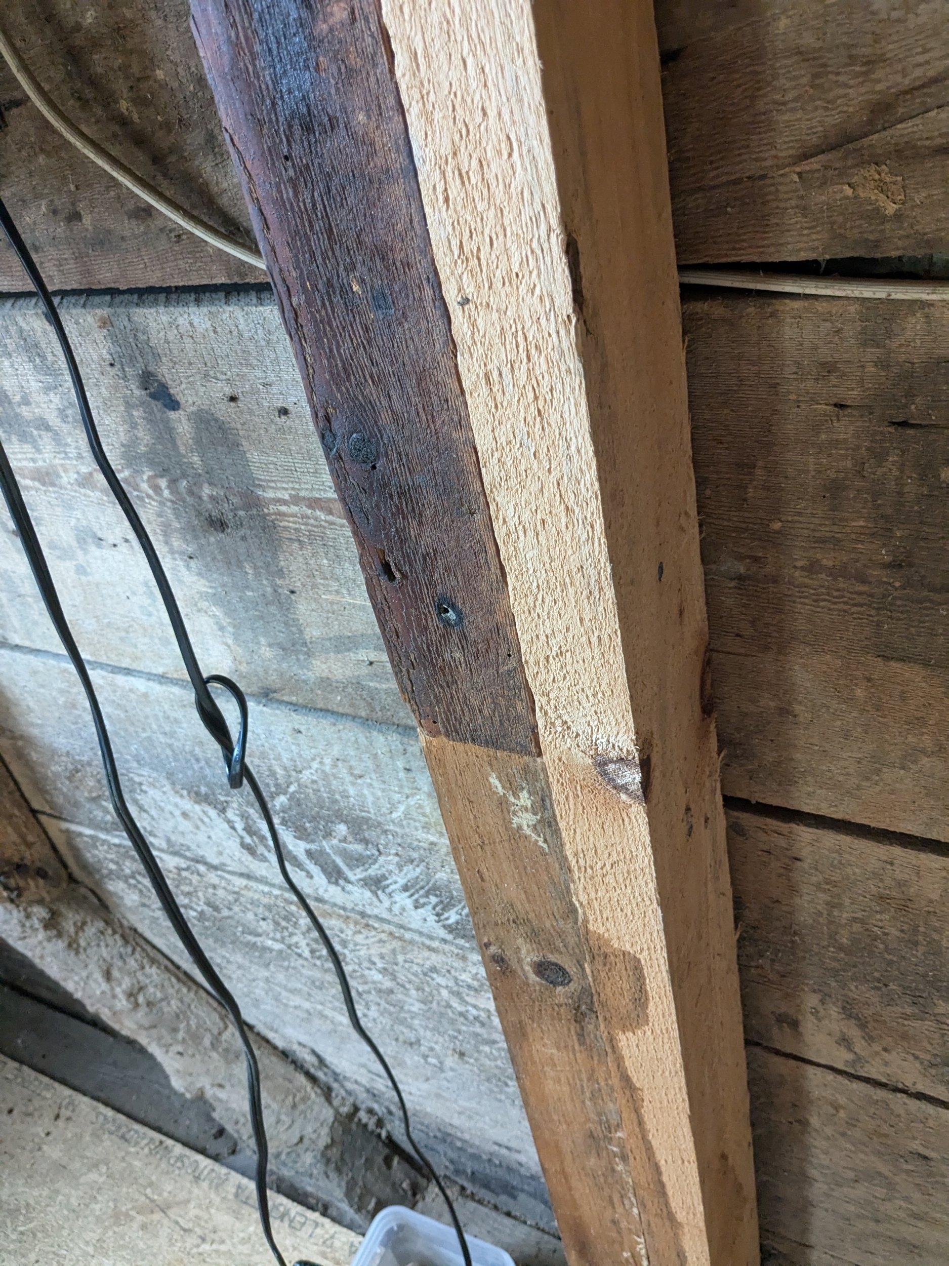

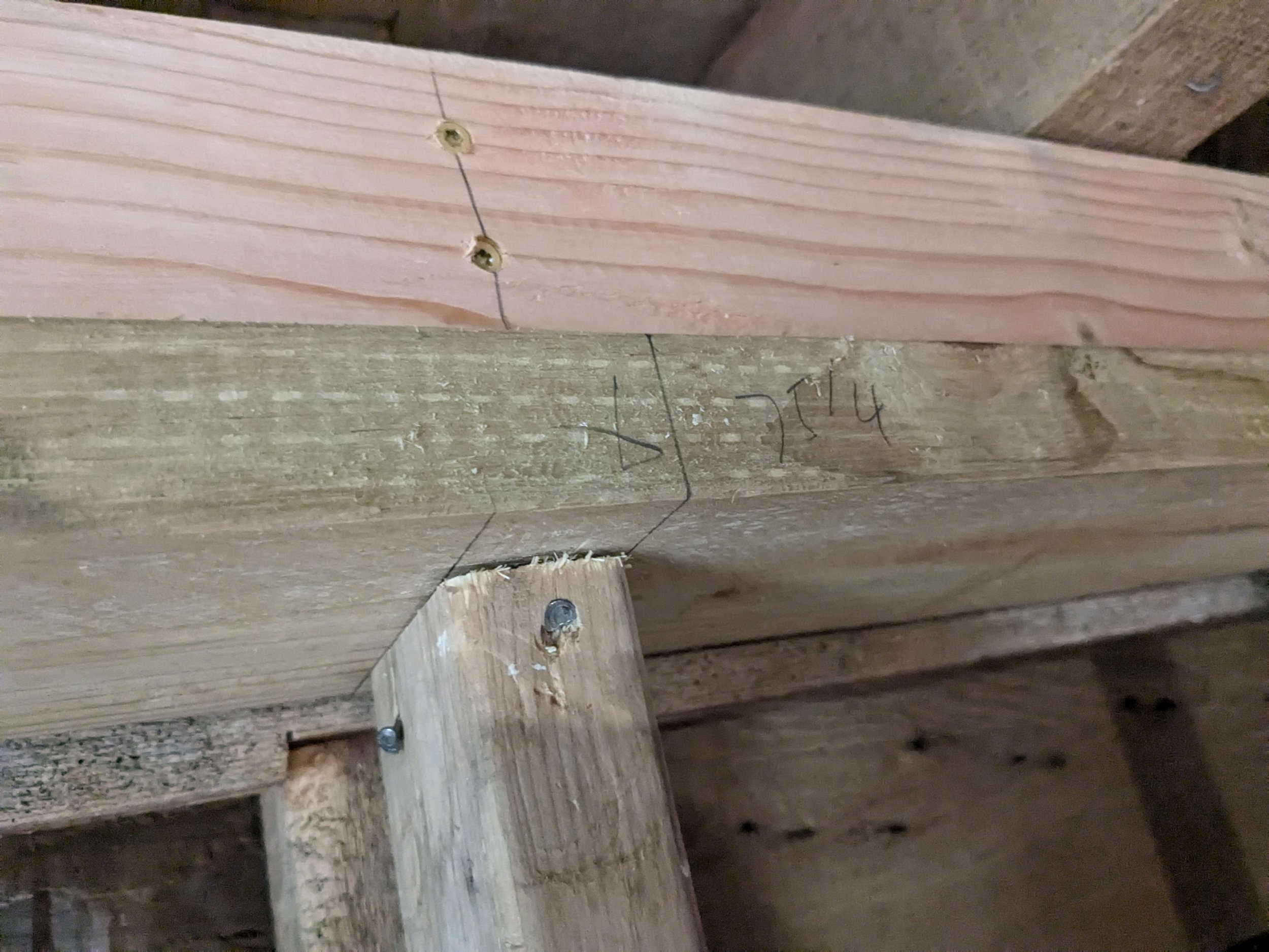

This is an example of where I've repaired a stud with a damaged section, I think I'll have to do all of the studs on this wall.
The original stud is 3x4. I cut out the damaged section and put in a piece of 3x4 that I got from a local sawmill. Then I fastened a new 2x4 of rough lumber alongside.

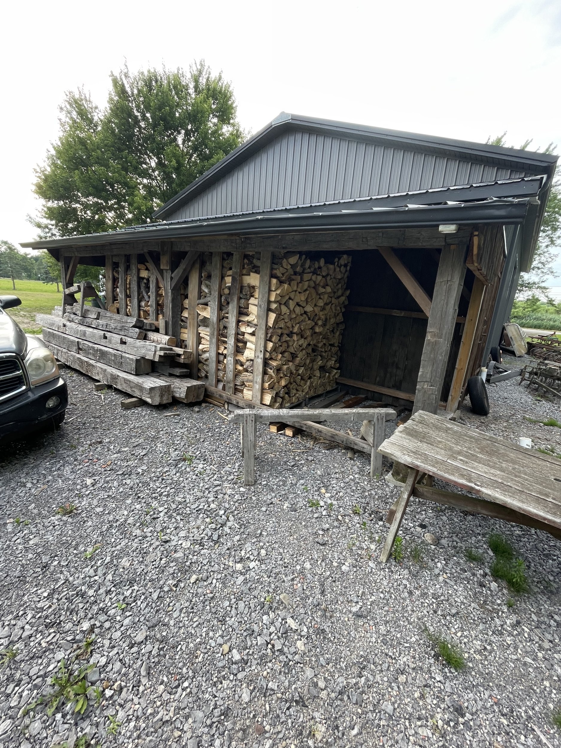

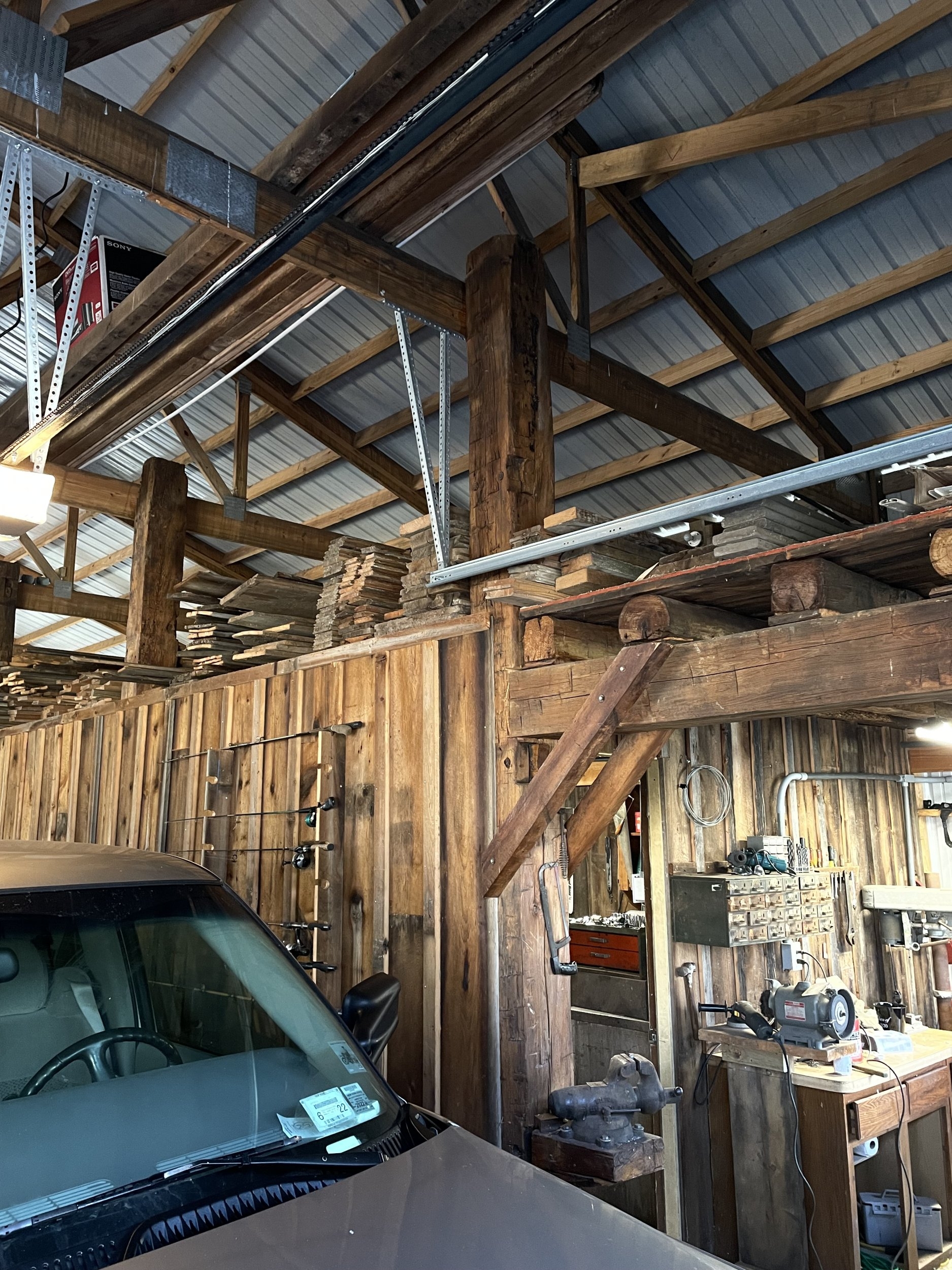

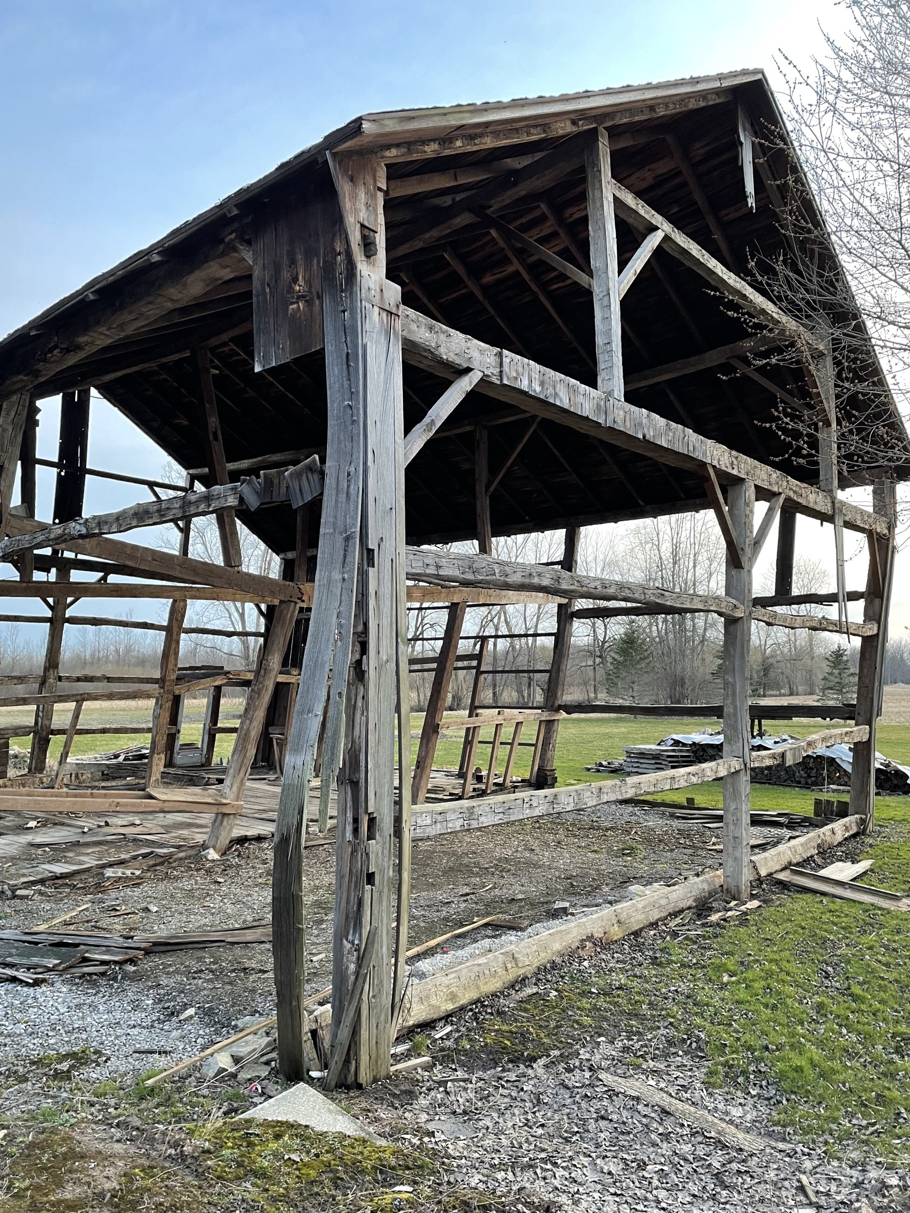

It’s nice that you were able to save that old barn. There were a couple old timber framed barns on our farm that my great great grandfather had built in the 1880’s. Unfortunately, they were too far gone for me to save, with the foundations and roofs failing at the same time.
While I wasn’t able to save them, I was able to carefully recover much of the original material, and use it to make a loft and workshops inside my new metal pole barn, as well as a woodshed across the back.
Most of the wood that my old barns were made from (in western upstate NY), was American chestnut. I like the color of that, after I power washed and varnished it.
Here’s a pictures of the last one before I pulled it down, the new barn interior shops and loft, and the woodshed (24 face cord capacity) across the back.
The green tin woodshed roof was included with the metal Stockade building, as cover sheets to protect the gray roofing and siding tin during shipment. I didn’t need to spend a penny on materials to make that woodshed.
Part of the reason the old barns were in such bad shape was that the hay lofts were never intended for baled hay. I remember them being nice and straight when I was a little kid and we drew in loose hay. By the time I was a teen, grandpa had a baler and I got the fun job of stacking those bales up in the lofts.
The beams supporting the loft floors were spaced at 4 ft. It didn’t take long for them to start bending and breaking. I learned that lesson well, and spaced them at 2 ft under my new barn loft.
Repurposing that old material in the new barn let me keep the feel of the old barns, with the added benefits of reduced maintenance and greatly reduced cost, compared to what it would have taken to restore the originals.
You can see all of the leftover, hand-hewn chestnut and oak posts and beams, that remain from the old barns, stacked under the woodshed overhang. I’ll be hauling most of those up to my father in laws neighbors place up in the mountains.
He was going to cut pine timber’s for an addition to his vacation home up there, but he fell in love with the chestnut, when I brought a few pieces up for my father in law to work with.
