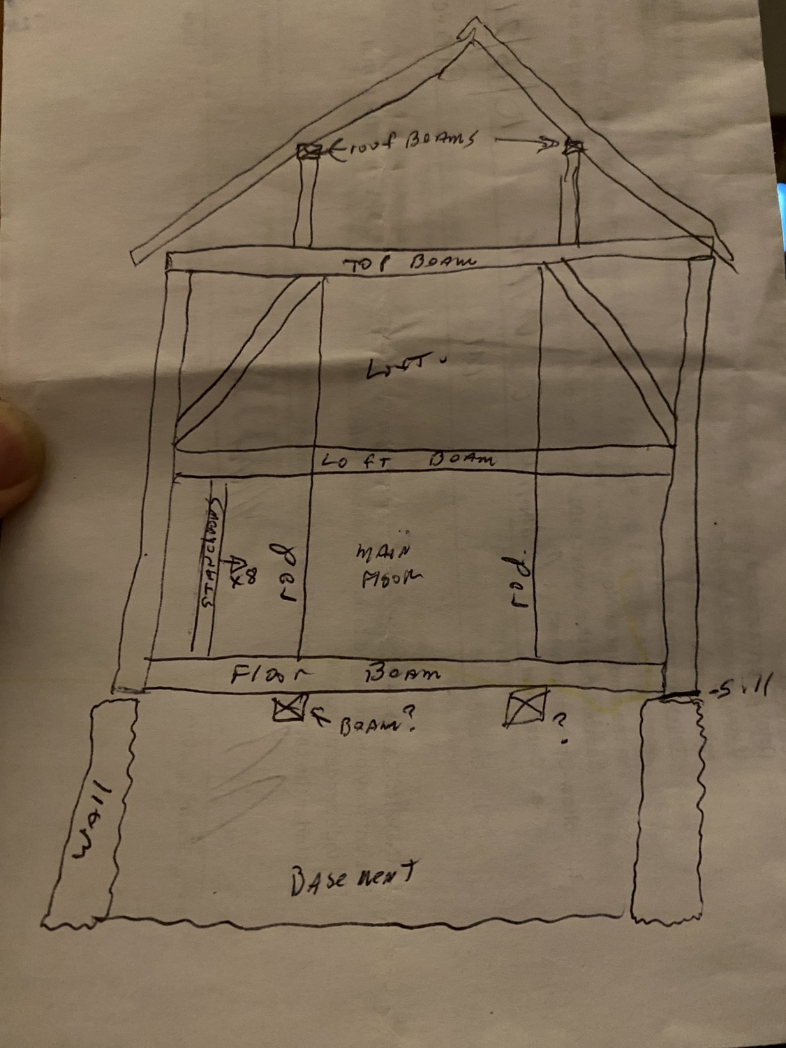

From your description and pics this is what I think your bents look like. The 2 center ones have the rods, the end ones sit on a sill on the foundation, except there is a basement door at one end.
Are lofts floored only on the 2 ends? Or is middle also floored?

That's exactly right. The rods go through the floor beam, then there's a metal plate at the bottom of the rod that the floor beam rests on. Those metal plates have all either rusted or the wood has deformed so the floor beams were all sagging at the rods, I put columns under all of them. The stanchions rest on the floor beam and support the loft beam. Originally the top beam held up the floor beam via the rods, and since the floor beam was holding the loft it held that too. Since I've put the posts under the floor beam it has taken the load off of the rods which means the top beam is holding a lot less than it used to. I don't have a winter's worth of hay in the lofts either.
The center is clear to the ceiling, the lofts are at the two ends.
I haven't been able to learn much about suspension barns other than they are rare. They seem to have been a local specialty in the town I'm in, there's a few that I know of. They all have the same design and orientation, like they were built by the same carpenter. All of them had the same problem with the rods failing.

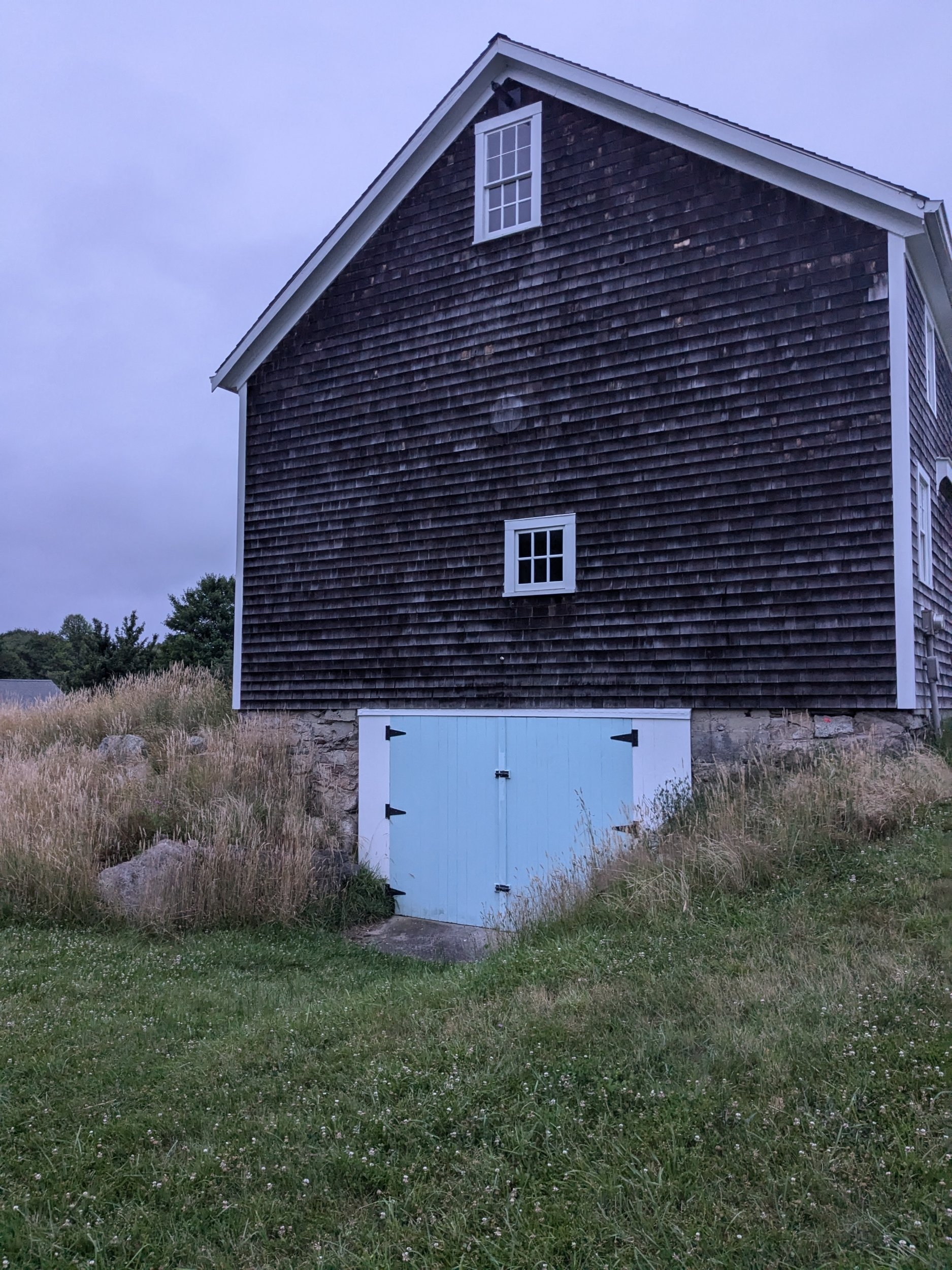

Was your milking parlor oriented a particular way? Every barn like this I've seen the barn is oriented so the long sides face due north and due south. The milking parlor is always at the east end. I had a debate with someone at the historical society about which way the cows would face, in the article it says they faced west and I'm pretty sure they faced west in my barn. But she said in her grandfather's barn they faced east.

Manure trough running north south on the east side of the barn would be consistent with cows facing west.

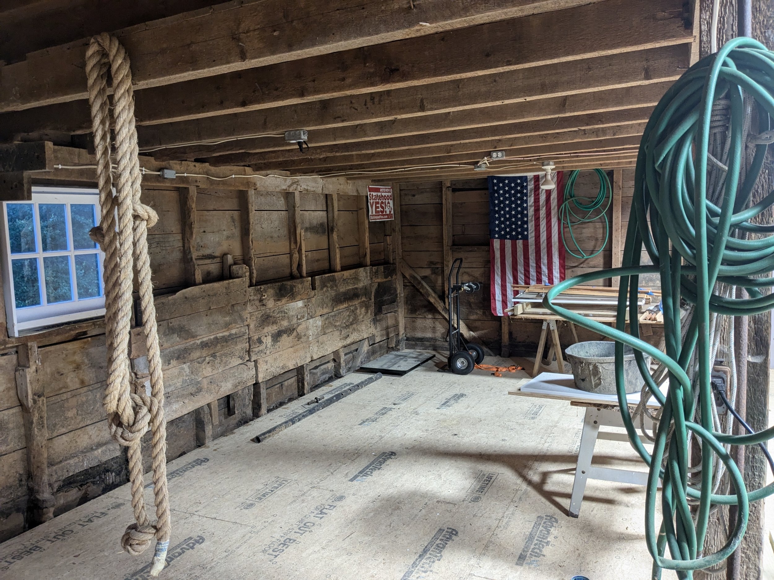

Today I started pre-production for season 17 of This Old Barn. This season's project is the west wall.
It doesn't look too bad in this picture, which is why I haven't gotten around to it yet.

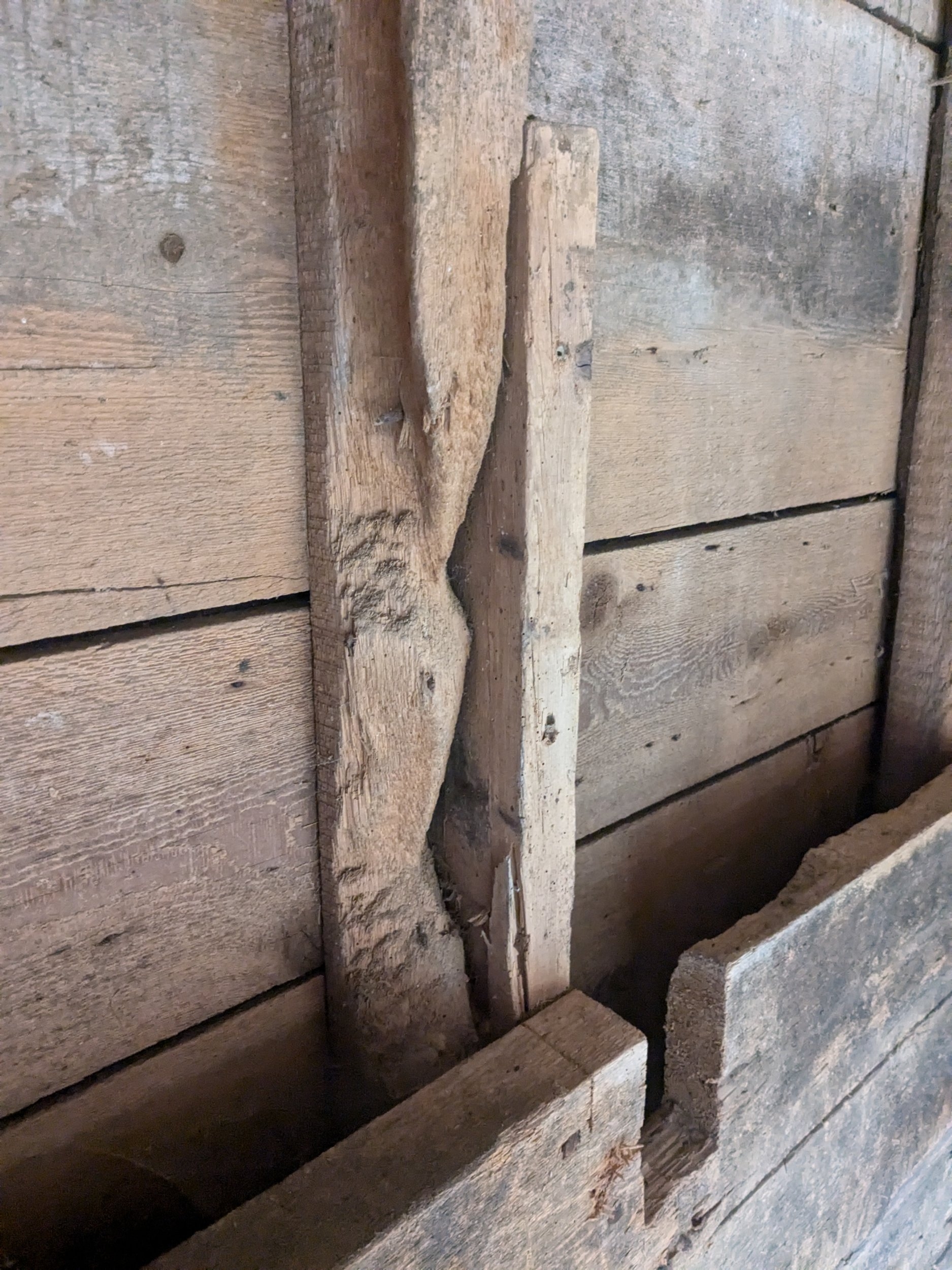

But the framing has some issues on the inside. This end is where the horses were kept, and the horses had a tendency to chew on things, so the studs in the wall are pretty chewed up:
Here's a closeup of one of the studs:
At some point some 2" boards were nailed across the studs to protect them. I'm afraid to take those boards away now without holding the wall up somehow. Since it's a gable end wall it ordinarily wouldn't hold much weight, but there's a hay loft above that is supported by a ledger board that is let into all of those studs.
If you go back to post #81 at the end of last season, I added a new rim joist so I could replace the floor joists without relying on the rotted sill. This is the section of wall where I did it, and those studs are resting on that rotted sill. So now that I have a solid floor, my plan is to support the loft from below on the floor and take all the weight off of that wall. Then I will go in from the outside, and replace as much of the sill as I need to in order to have something solid for the studs to rest on, and then sister the studs as necessary to make them solid. The window on the first floor was added some time later and the framing around it is really hinky, so I'll clean that up too.
First step is to get all of my junk out of the loft, and then figure out how to brace it from below.
