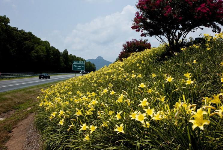

But seriously, my mom planted many flower beds with day lilies and other perennials in areas where my dad didn’t/couldn’t mow. Works great. Keeps weeds down. Low maintenance. Many varieties available. Looks nice. SAFE.
Anyhow, not for everyone, but just a thought.
   / This Bank is KILLING Me…. #22
Even helps with erosion control on the slopes.

Another vote for simply don't mow it. Scrape some of the sod off and go nuts with wildflower seeds. Some lillies should be able to cover it nicely and come back thick every year.
It will save you all the work AND look better for everyone else driving by on the road.

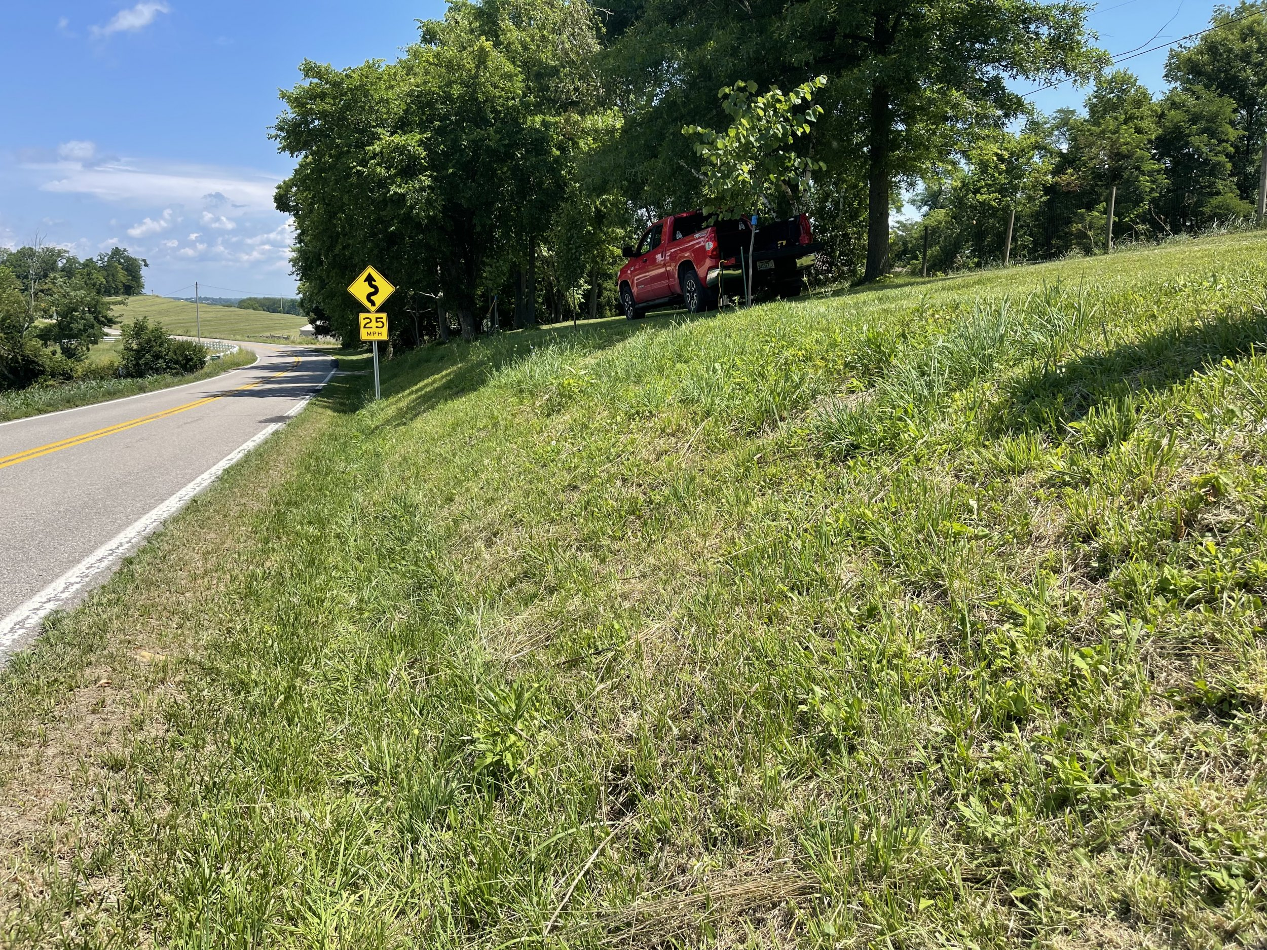

This hill is killing me. A little steeper than it looks. I have a JD 1023
Depending on how much "modify / fabricate" abilities you have, ideas I might think of:
1) Create wheel spacers so set the tires out wider than factory? County mowers have some really wide settings.
2) Use a long pole or beam of some sort that is connected to the tractor on the "uphill" side with a weight on the end to create extra stability. Don't insist that the wife sits on the end.
3) Require a second person to assist. One drives the tractor along (parallel to) the top of the hill with a chain or rope is attached between that any any type of push/self-propelled mower that traverses the hill with (or without) a person guiding it. Safeest method would be a self-propelled that the second person who "locks" it into drive mode and watches it go from a distance.

This hill is killing me. A little steeper than it looks. I have a JD 1023 - not enough juice for a boom mower or a flail. You can see I have easy access from the top. Been weedeating this mess for five years.
What if I took tow behind mower like you use with an ATV - hitched it to the back of the 1023 - and just backed up to the edge letting the mower drop down over the bank? Put a bit longer extension on it if I needed to. Then work my way across up and down. Is this a really smart idea or a really stupid one? I’ve been known to have both kinds.
Mow straight down in 4 wheel drive and back straight up your next pass. Takes a little extra time but should not be any trouble.

Before we were married, my wife had a yard service that used a zero turn ride on for most of the lawn and a hydrostatic walk behind for her steep hill, which may or may not be as steep as yours but seems many times wider. I bought a used one with a Velke/sulky (less than she paid the service annually) for the whole acre lot and alternately cut the hill at an angle as described previously. The mower works fine but the Velke would slide on the steepest hill if I cut horizontally so I just hung it up on the hook the prior owner installed when mowing there. Walking slightly downhill of the mower allows you to be more upright.
A self-propelled push mower works, but this is wider, faster, and much more stable.
Our current home is on the side of a hill with a third acre of 150 feet of up and down mowing a 30 percent slope. At the bottom is a 3 foot drop off (flood plain change) and heavy woods. Riding anything that could fail would be risky, even my tractor or ride on with seat belts and roll over protection.
BTW, I am handicapped, have balance issues, and need at least one cane to walk safely.
The perennial flowers sound great, except they don't last long. Ground covers seem to take forever to spread and still have weeds growing within, often unsightly large ones. Wildflowers are often annuals and have the same issues.
Is there somewhere you can rent a walk behind to try one out? It looks like you might get by mowing the whole bank horizontally in two or three passes. Up and down on that small a slope would take many times longer.

MossRoad - post#16 has the very best answer. And it looks good too. Otherwise - I'd plant Bachelor Buttons. Same idea as Moss - just a different type flower.
Anyhow - I would do SOMETHING that eliminates the need to mow.
