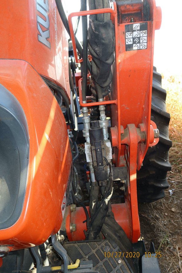

I have WR Long set up as true third function. The dealer installed it along with my Land Pride SGC1560 grapple. It is sandwiched into this well protected location.

At my dealer couple days ago.
He said kit for the sa424 was around $550.
