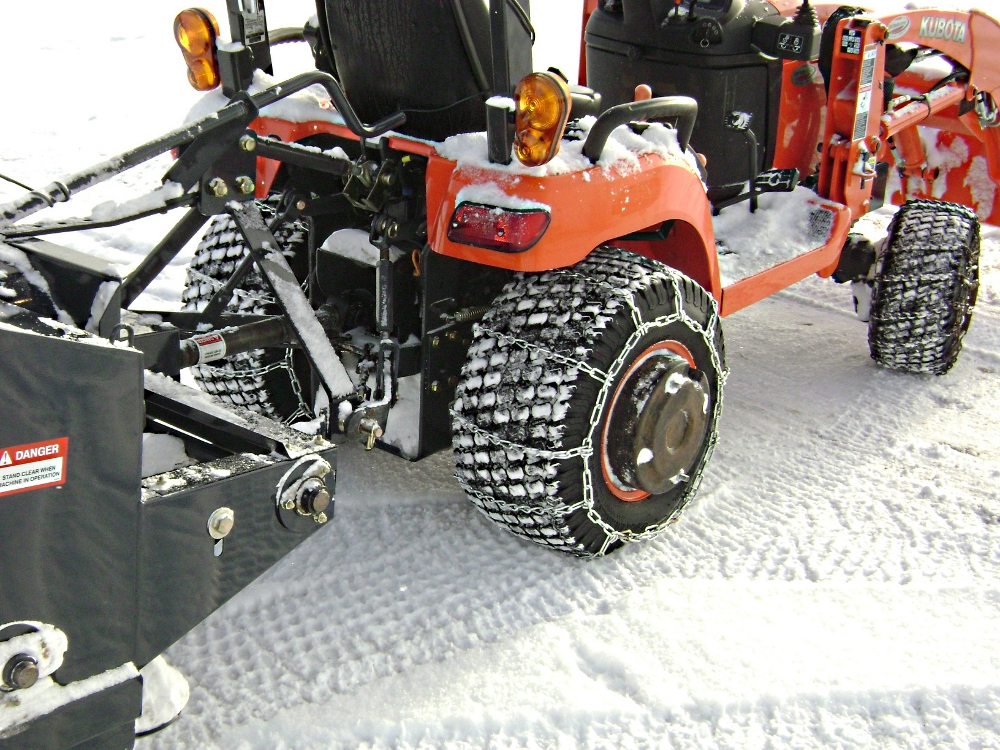

Personally I would go with chains all around. During the winter on my Bx2350 I have chains on all fours plus 500 pounds of iron rear wheel weights and a little over 200 pounds of lead hanging off of the front bumper. That coupled with a 585 pound rear mount snow blower and a bucket full of snow it pretty much gets me where I need to go. But without the weights and chains in heavy snow and ice I'd be better off using a shovel.
The downside of using chins in the bush is that the chains do tend to grab sticks and push them into those lovely PLASTIC Kubota fenders and linkages, get the picture?
