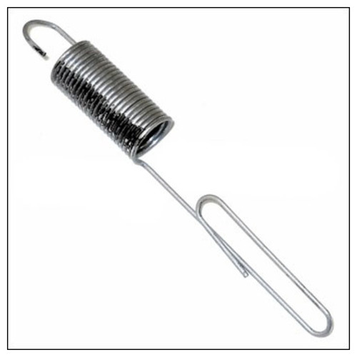

If you need a stronger spring, the Farm and Fleet or Ag stores sell those.
Some springs have long loops on the end as the governor needs to wander a little when high revs are hit. This allows the governor to do it's job vs. full WOT. This saves the engine from internal damage.
Now, do you need the Parts Manual for your machine? It will list the correct spring p/n and then the size you would need.
Thanks so much

Thanks for the parts maual!!
   / Think spring #13
I have used springs . would have to check new are available.
