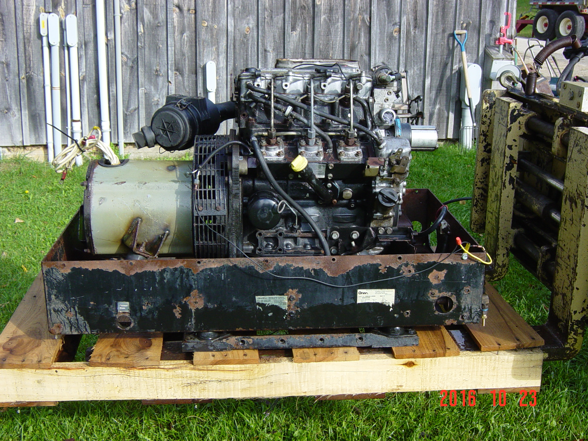

So I'll borrow this picture from post #5.
The little 3 cylinder Isuzu that I'm working on looks very similar to this one. About a week ago I was trying to get it started and just couldn't get any fuel delivery to the injectors. I'm thinking that the shutoff solenoid isn't moving the rack to allow injection. This engine has sat outside for a while and I'm wondering if the sun has tuned the diesel into varnish and the injectors/injection pump is stuck. It looks like a previous mechanic has been into the engine as there is red silicone on the rack cover where there would normally be a gasket.
This little motor is going to sit on hold for awhile. There's too many other projects on the go right now and there is no rush to get this one going. One more TK to get going and then the owner can decide which one he wants for a generator. He's indicated that he wants one of the TK's and I don't blame him as they have the reputation.
What I like about the little 3 cylinder Isuzu is that I can order a generator that bolts directly to to the engine flywheel and bell housing. It would make for a nice compact unit looking very similar to the one in the picture. The one I'm working on has a fan and a radiator.
I'm still tossing ideas around for the Lister. I'm not sure if it's 7 or 12 hp. I'll find out when the generator is hooked up as I don't feel like pulling a head to find out. The toss up is either direct drive or with a serpentine belt. Direct drive is nice but with a belt I can tuck the generator in right beside the clutch and it makes for a very compact unit. Belt drive also fit's a lot nicer into the corner of my shop.

Just keep in mind that as I understand it reefer motors run at 2200 rpm on reefer duty. You can reset the governor for 1800. I was originally going to go for a 20 KW head but decided that the reefer motor was to low on power at 1800 rpm.

As long as you stay above 1200 rpm, you will be fine. When you drop below 1200 rpm, the governor does not work as designed, and then when the genset hits sudden heavy loads, it could stall out. It would most likely be in the 700 rpm range or below, that this would happen, but ideally you want to be at 1200 rpm or above.
A reefer engine may develop maximum power at 2200 rpm, but that does not mean it will not operate a genset at 1800 rpm. At less horsepower it just means you will not develop full 20 KW. But does it really matter? The average house at any one time, seldom consumes more than 10-12 KW. A reduction by only 400 rpm is hardly taking the engine down the stall-speed, again you just have to be about 1200 rpm due to the governor. A 29 hp engine is still going to be in the 16 KW range, MORE than enough for most houses. My father has a 14 KW Generac and his house is 5200 sq feet.
Even then, you would NEVER set your genset to a certain rpm based on what a reefer unit was set up for. You set your engine speed to produce the proper hertz (frequency) of 60 cycles, ideally 61 hertz so that if you get a load, it does not drop below 60 hertz. To do this, just disengage the automatic throttle control of the genset, and use a hand-method. I used a c-clamp to adjust, and then hold my throttle for ideal power.
Ideal power is what the grid produces. At my house, it is 60 hertz at 240 volts...
