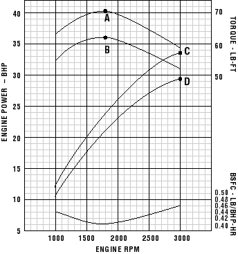

I found a hp/torque chart for the little 3 cylinder Isuzu. (model 3LD1) It looks like I have 21 hp at 1800 rpm on that one. Good for a little over 15,000 watts.
I looked for a chart for the Thermo King/Isuzu C201 engine. So far nothing. Even though the service manual mentions generator use there is very little information about those old rnotors being used as generators online. Maybe one of you will have better luck.
Line B is continuous torque and line D is continuous hp. And I just noticed that 1800 rpm puts it at the lowest fuel usage too.
