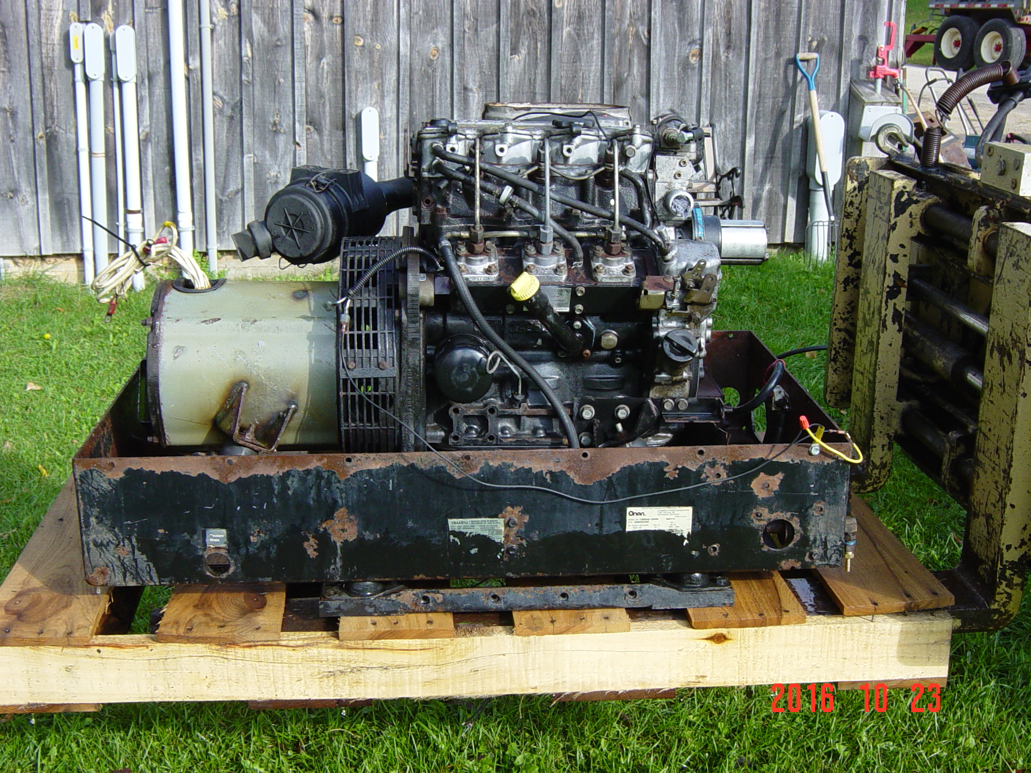

I LOVE my 12.5 KW Isuzu/Onan. SMOOTH as Silk. But it's the largest in a range of several and my preffered backup is a 7.5kw.
IF, and that's probably not ever going to happen, I get another engine with busted genend, I would try and slow it down, maybe to 1200rpm and have a generator wound to accept that speed to maker 60hz. One might have to adjust the governor.
START of Isuzu 12.5 Project. Was told Genend was toast, so I ripped the whole thing apart and was going to buy a STAMFORD end, when I realized it all worked. Started to figure out the adapter plate, because Onan has their own, and then didn't have too.
   / Thermo King / Isuzu motors for generators
That 3 cylinder Isuzu looks very similar to what I have.
