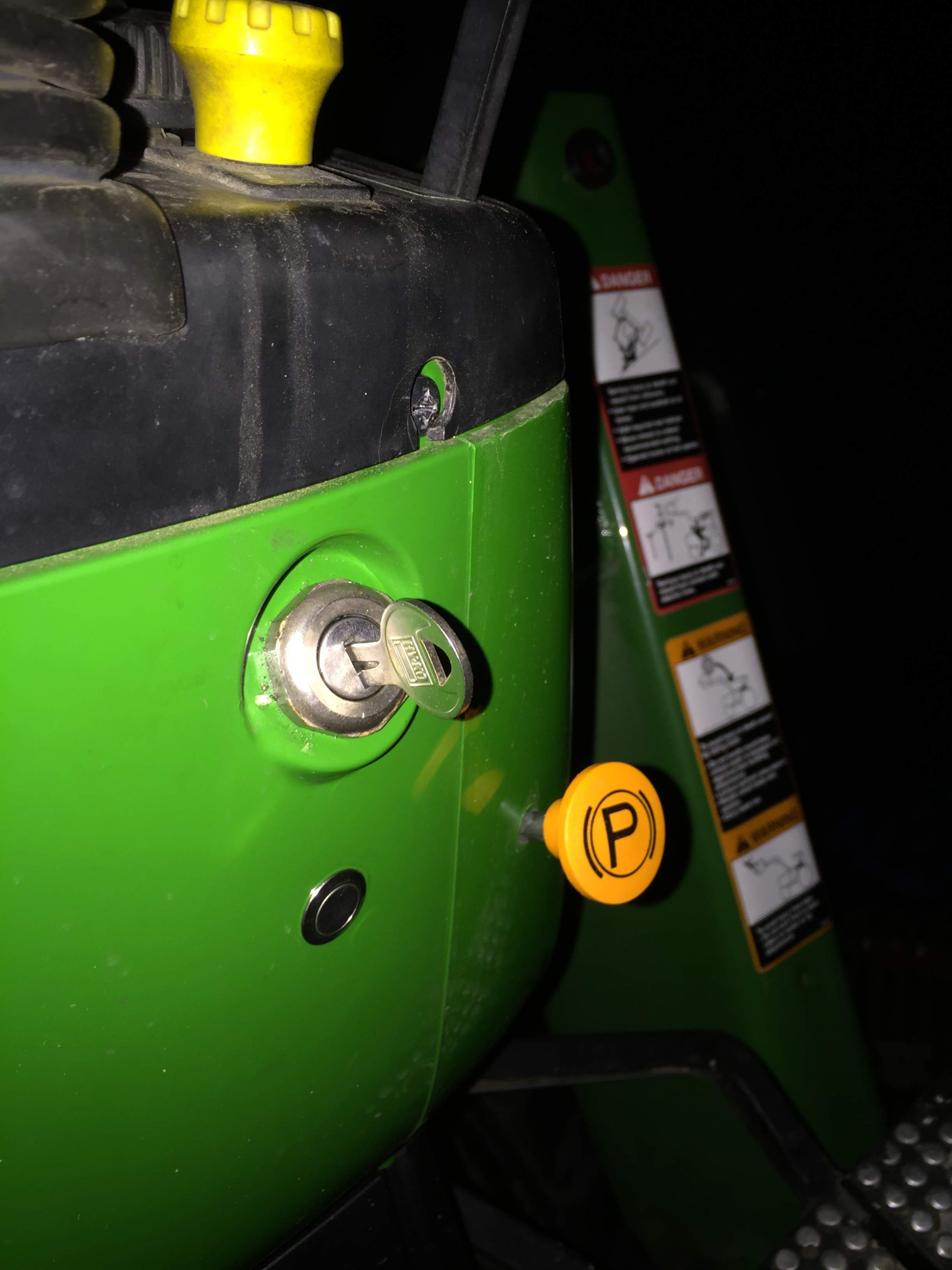

Here's the photo of where my switch is. This is very low-profile switch and the only disadvantage of this one is it's hard to push it when you have gloves on. I chose this switch because it's waterproof and should be very reliable. It's also good looking and stainless so it will never rust. Any normally-open momentary contact switch can be used. Another downside to this approach is that it requires both hands when you turn the key on.
In case you can't tell, the new switch is that little shiny button directly below the key switch. IMG_0561.jpg
In case you can't tell, the new switch is that little shiny button directly below the key switch.View attachment 449357
