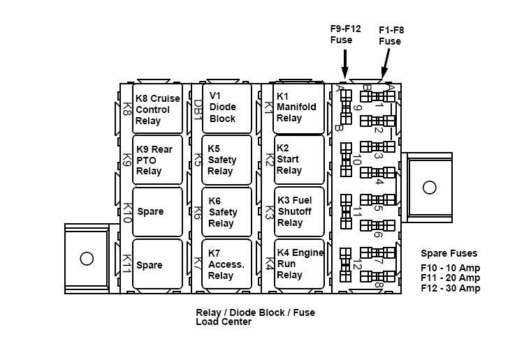

After doing some searching I was directed here to hopefully find the answer to a problem I was afraid didn't have an easy answer. But it appears that the answer is thermistor. I have all the classic symptoms. I've read tons of threads on the thermistor being the culprit in my case, but there hasn't been too much mention of the best ways to replace it.
What I'd like to know is exactly where the thermistor is located and any tips/tricks anybody has used to replace it. I believe its behind the fuse block -- do I have to take the dash apart to get at that, or is it behind the green panel on the front where the key is? Thanks in advance.
/ Thermistor Replacement #2
It is on the back side of the fuel shut-off relay socket.

/ Thermistor Replacement #4
Yeah, it is behind the fuse/relay block, as stated. I have had my
whole wiring harness out, and it is quite tight behind that area, so it
is hard to get behind the block. Those wire bundles are stiff.
I do have a spare of the LVU10323 thermister, but the part is not
expensive.

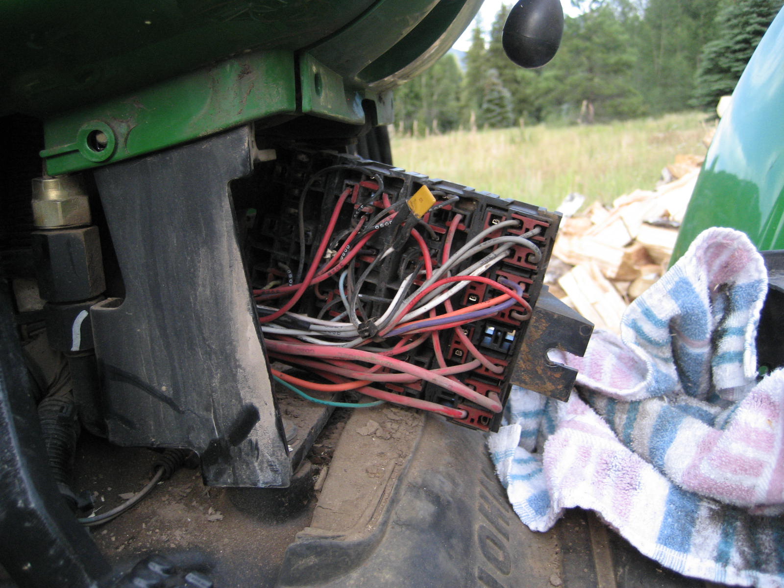

/ Thermistor Replacement #8
I just cut mine out and heat shrinked it back on - See attached pictures

/ Thermistor Replacement #9
Long0
Great pic. I didn't realize the block would roll out like that. And it appears the thermistor is easy to get at. Now, do you mean you soldered the wires then put the heat shrink over them? Or didn't solder, but depend on the shrink to hold them in contact? I assume the former. :)
#12
Well, I brought my camera down to take some pics of thethermistor replacement, but thanks to Long0 and his pics, that's about it and nothing more to show really. It was pretty straight forward.
I removed the plastic case that contains the fuse access door -- there were 2 scres adn 2 bolts. Then I removed the fuse box assembly which is 2 nuts. It came out, but it is pretty tight in there. Mine swung the opposite way of Long0's in his pictures. The thermistor was right there behind the box and quick-tied together with some of the wires. At this point I removed the green cover directly above the fuse box -- where the steering adjustement and ignition are located. This gave me a little more room to move the fuse box. I then cut out the thermistor, put new shrink wrap on the wires and soldered the new one in. Very straight forward.
It has been starting fine so far. I'm not sure if it is my ears or not, but the click of the solonoid seems to be a little louder, but that could just be me. Hopefully this licks the no start problem that has been frustrating as he11 for a few years now. Since it only did it occasionally, and of course always did it when in a hurry.
