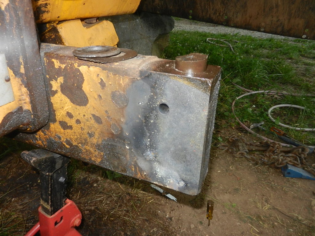

So, I've got a stuck king pin on my industrial backhoe. Couldn't get it moved to remove steering knuckle.....so it's been cut off. I now have (roughly) 1" stub on top of the axle and 1/2" stub on the bottom.
Been beating, oiling, rose-budding, welding (a lever onto the top and sledging on it) and it's still laughing at me/us.
In process of having a frame built so we can slide/hold a 30 ton bottle jack and see if we can use that to move it from the bottom up....
So, the bottle jack is our current plan.... had a friend who said I should thermal lance it. I had never heard of it and looked it up.
I have now also spoken with a company that provides/sells those tools and he (very confidently I might add) said that it should take about 30 seconds to blow a hole through the king pin, which is approximately 1 3/4" diameter and 10 inches long.
If you are as clueless to what this is as I was..... I'd urge you to do a google search and watch a video or two. If you like fireworks, it's quite impressive though, I presume it's not for the faint of heart.
Which brings me to my primary concern should this avenue be explored.
1. The pin is vertical. After seeing how the slag blows out, I don't think going down is prudent....so would want to go from bottom UP, at least I'm not staring down the throat of Mount Vesuvius.
2. Guy from company said that the rod can be bent, which is good and helps support idea of going vertical
3. Slag.... I didn't see anything after a triumphant view of a hole or a pin being removed.... may I presume that the slag that blows out of this will stick to all the metal and create little issues, to the degree I care they're there? Or, since the machine is cold, would they maybe stick, but pop off easily?
4. My real concern is melting the actual hole that HOLDS the king pin. That would be a bad day. So, if the pin is say, 1 3/4" diameter, what size hole do you target? I'd think a 1/2" type thing as the closer you get to the diameter of the king pin, the less room for error.
Thoughts??

I've done a fair bit of lancing, fun/not fun. Fun to see the end result, not fun getting burnt which is almost inevitable. Wear ear plugs for sure and a dark, #7-8 or so shield.
Bottom up would work better but saying that, think about where the slag goes and protect your hand with either a piece of bodymetal or pairs of gloves. Working overhead is hard to keep everything parrallel but can be done. Horizontal is the easiest, you can see but the slag still flows/blows out.
Never seen or used a bent rod, if you did bend it, you'd have a heck of a time keeping it straight and parrallel to the pin. Not only that, but I'd be wary of the rods inside coming loose the outer sheath.
There is lots and lots of slag, it won't stick to metal unless the surrounding area gets really hot which it won't. If you're on cement, put some metal on the floor or you'll end up with a badly pitted floor as well as cement pieces stuck where cement pieces shouldn't be . Make sure you're well away from flammables, outside on gravel with a hose handy is ideal.
An 1-3/4 pin is easy to lance, I've done them down to 1" which is tricky and have screwed up a couple of bosses I'm not ashamed to admit. Have to watch grease holes as the molten channel will follow the path of least resistance, i.e a preexisting hole. The ones I screwed up were front kingpins on an Izuzu cabover, and of course the axles were obsolete.1/2" is probably the biggest rod you'd want to go.
PS: Any certifications/qualifications on buying some of these tools? (other than drinking a beer and shouting to everyone with a camera running "hey, watch THIS!"
No certification required, just experience LOL. Be sure to keep your oxygen hose well away from the area and be sure to have a fire watch. Don't force the rod into the hole, if you do, it'll end up getting stuck which is a pia. If you don't have another acetylene/ox setup the get it lit, you can use a welder or a 12V battery on a striker plate, just be aware to keep the battery out of the way. Don't be tempted to get the last inch out of the rod neither once you start getting deep, suck it up and throw the last bit away.
Once the pin cools, it'll probably fall out. I've lanced out 3-4" pins on a loader and a well placed rap with a hammer once cooled and out she comes.....Mike

Pics of the king pin and surrounding would be helpful to see if there are other options to consider...
Didn't think about a picture.
As a preface, our current project is to have a cradle made (being done now) that will hold a 30 ton bottle jack and put the jack on the bottom part of the pin and see if we can then push it out or at least break the bond.
The lance thing is in my view, the last last resort.
The pin has been cut on the top AND the bottom so I don't have any choice, it must come out.

I don't care about the bushings and bearing, all those are going to be replaced.
Now, down the hole where the pin resides is a horizontal hole. This is where a slanted "cotter pin bolt" goes through to lock the pin in place. So this would be a possible place for slag to flow if it got exposed to the lava.
Be aware of what I said previously, the burn hole will follow the path of least resistance. Not just slag will flow out but oxygen as well which will burn along the hole. If you see slag coming out the bolt hole.....stop.........Mike

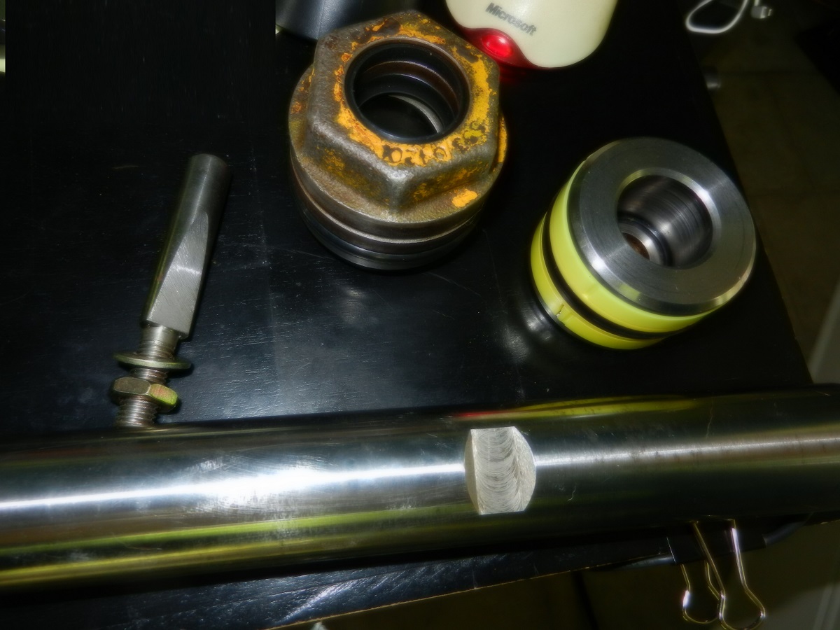

For anyone not familiar with this.... the rod goes through the axle. The hole you see opens up to a "notch" in the rod and a slanted cotter pin goes through there and bolts on back side to hold everything in.
Picture attached shows new rod with notch and upper left, shows the tapered cotter pin with nut.
The two meet up inside the hole you see in the earlier picture.

I misunderstood your description. I was thinking a hole thru the pin. You'll be fine as long as you stay in the center or at least close to center as you can.......M
