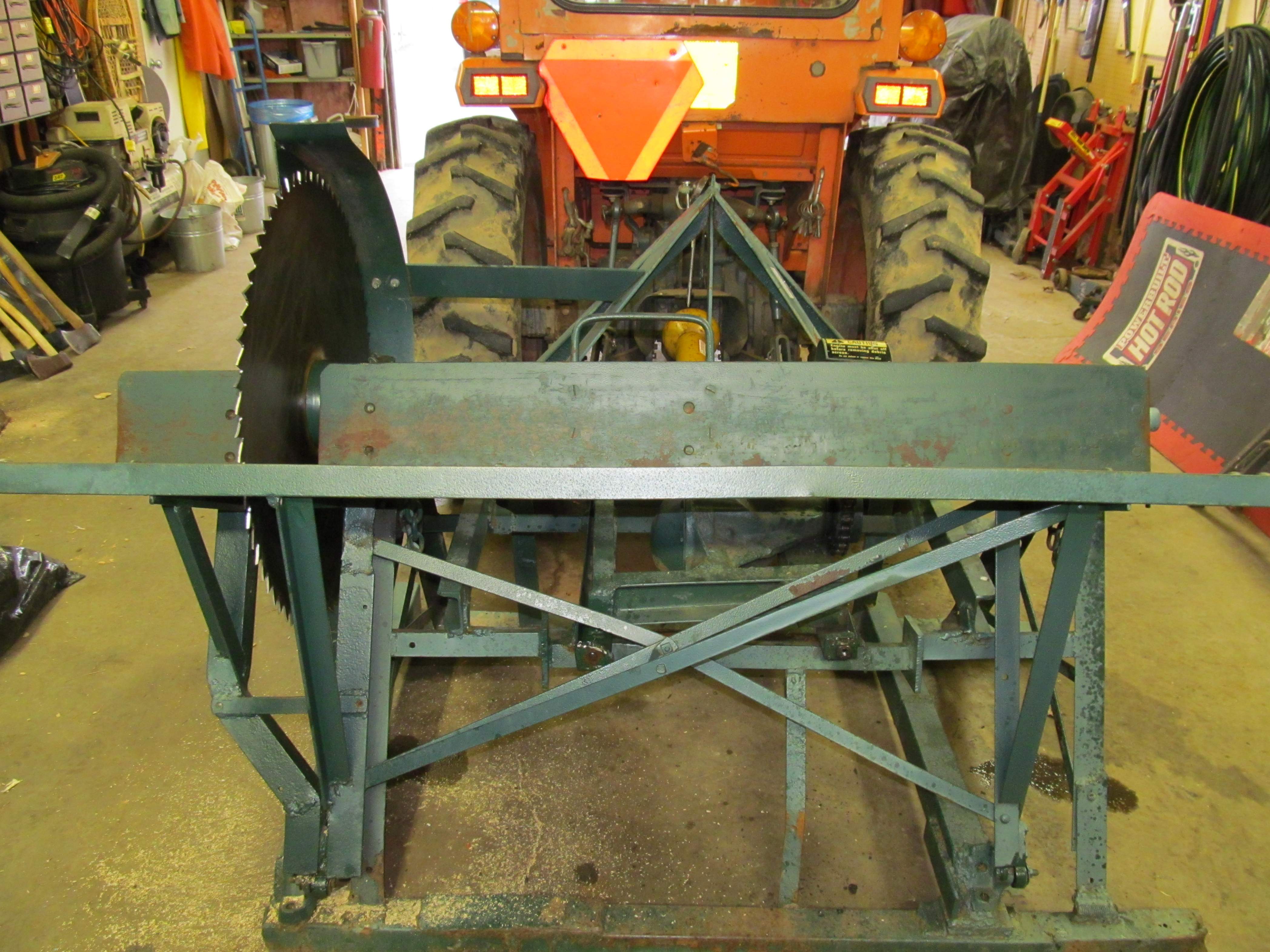

This year, found the blade had a 3/16'' run-off. Made me think of the danger . Got the saw apart, got the shaft checked, she was bent. Got it re-welded and cut on a lathe. redone the whole base with new steel. Now I know for sure. Will send new pictures.

I think this will work

IMG_0175.jpgSince my thread on Nov. 10 of last year, I got the shaft of the buzzsaw straightened, and redone the subframe from the bottom up. The saw now runs straight with no vibrations.
