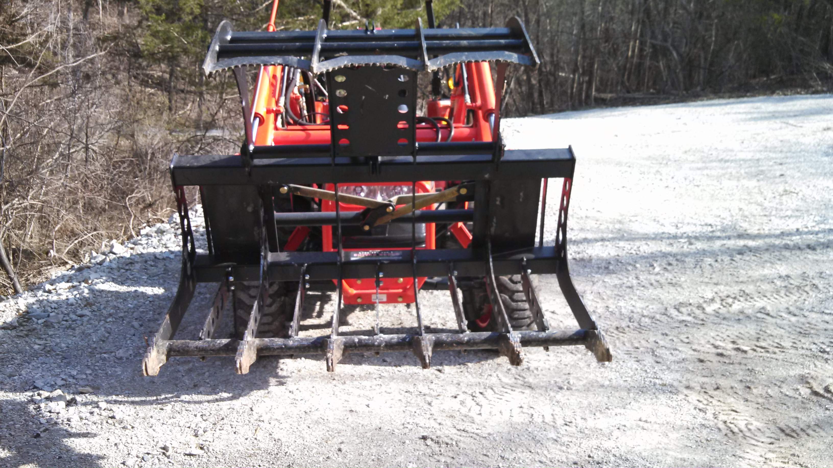

Here is what the little single lid one looks like when you are on the "business end"
