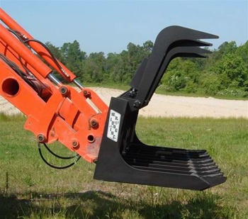

Are you sure that you want a rake style grapple? What will be your main use for it?
This is the best style for moving brush.
W.R. Long Open Bottom Grapple 1
   / The WICKED Root & Debris GRAPPLE!!!!!!! #306
<img src="http://www.tractorbynet.com/forums/attachment.php?attachmentid=368312"/>
Agree. Rake style grapples have their uses but the open bottom style has many advantages for general purposes including brush.

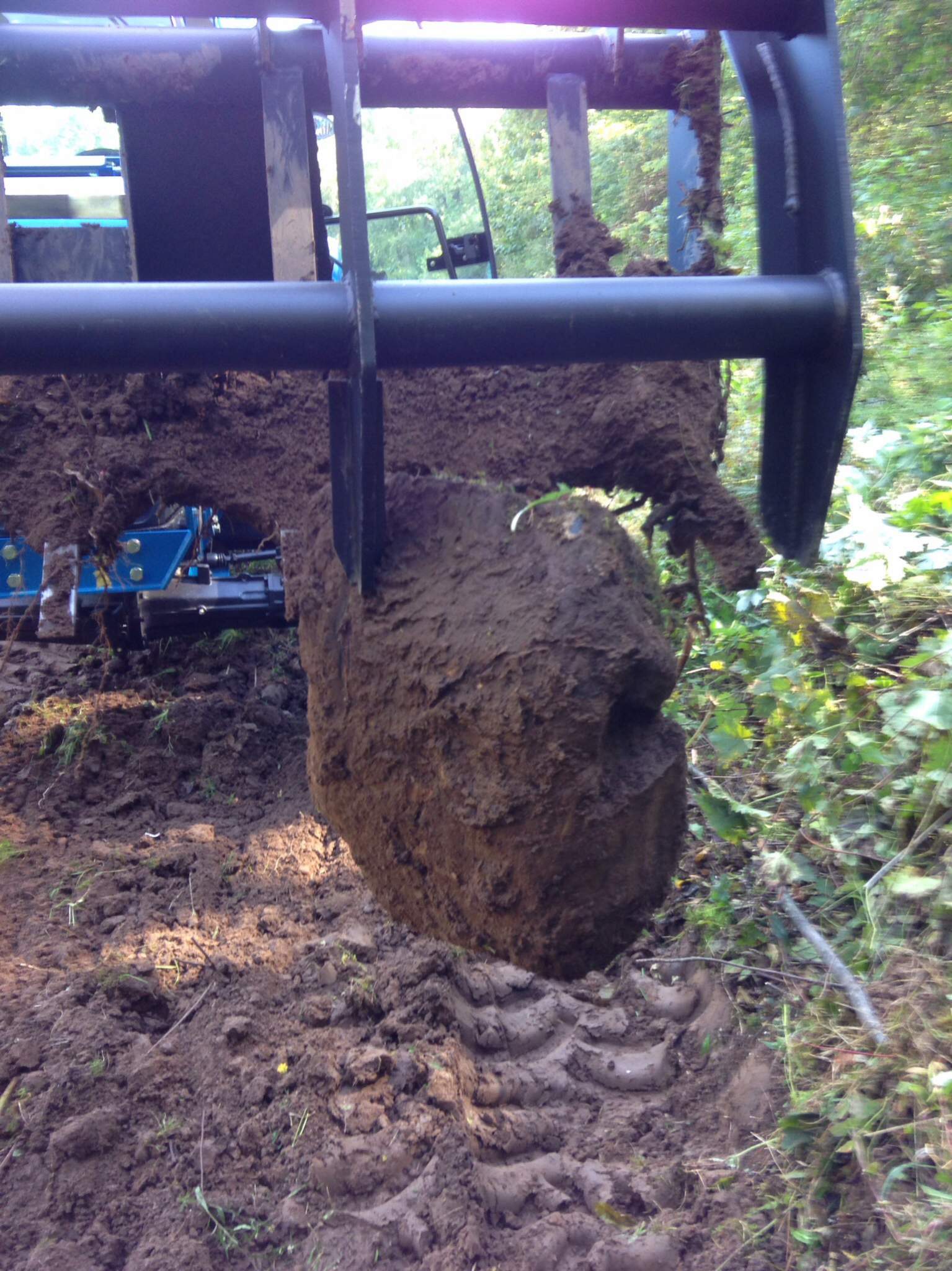

For my all around use, I much prefer the rake style. I have owned 2 flat bottomed grapples and they couldn't grab as much brush as my rake style. Then again my rake grapple has 70" jaws. I can make a brush pile up to my chin and move it all in one trip. That works for me!
I can also drive up to any log and pick it up every time on the first try. Drive into the log, close the jaws and it's held tight. Works every time and no chance of a heavy log falling back into the grapple and tweaking the arms of the loader.
And when it comes to digging out roots there is no comparison. You would be amazed what comes out of the ground with little effort. Here is a picture that shows what the grapple does in my ground, (have lots of roots and vines.) That was two passes, I picked the rock after my second pass.
For my needs the rake style was the better choice, but all grapples are fun!
