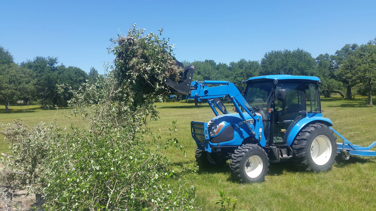

I bought an EA 73” Single lid Wicked Grapple for Utility Tractors, specifically for moving trimmed tree branches and brush. It’s 42 1/2” jaw opening works very well for that purpose. It’s been used on our LS XR4046HC 46 HP tractor. We’re in process of upgrading that Tractor to a new LS XR4155HC which has 55 HP.
IMHO this Grapple would serve you very well.
We also have an HD 84” Blue Diamond dual lid grapple installed, almost permanently, on our 96 HP New Holland TL100A. It’s primary use is pushing over dead trees and moving to burn piles.
Can’t help on your rocks as we have none here.
The only thing better than having a grapple........ is having two.

That grapple will do great. Post some pictures when you get it. Good choice.

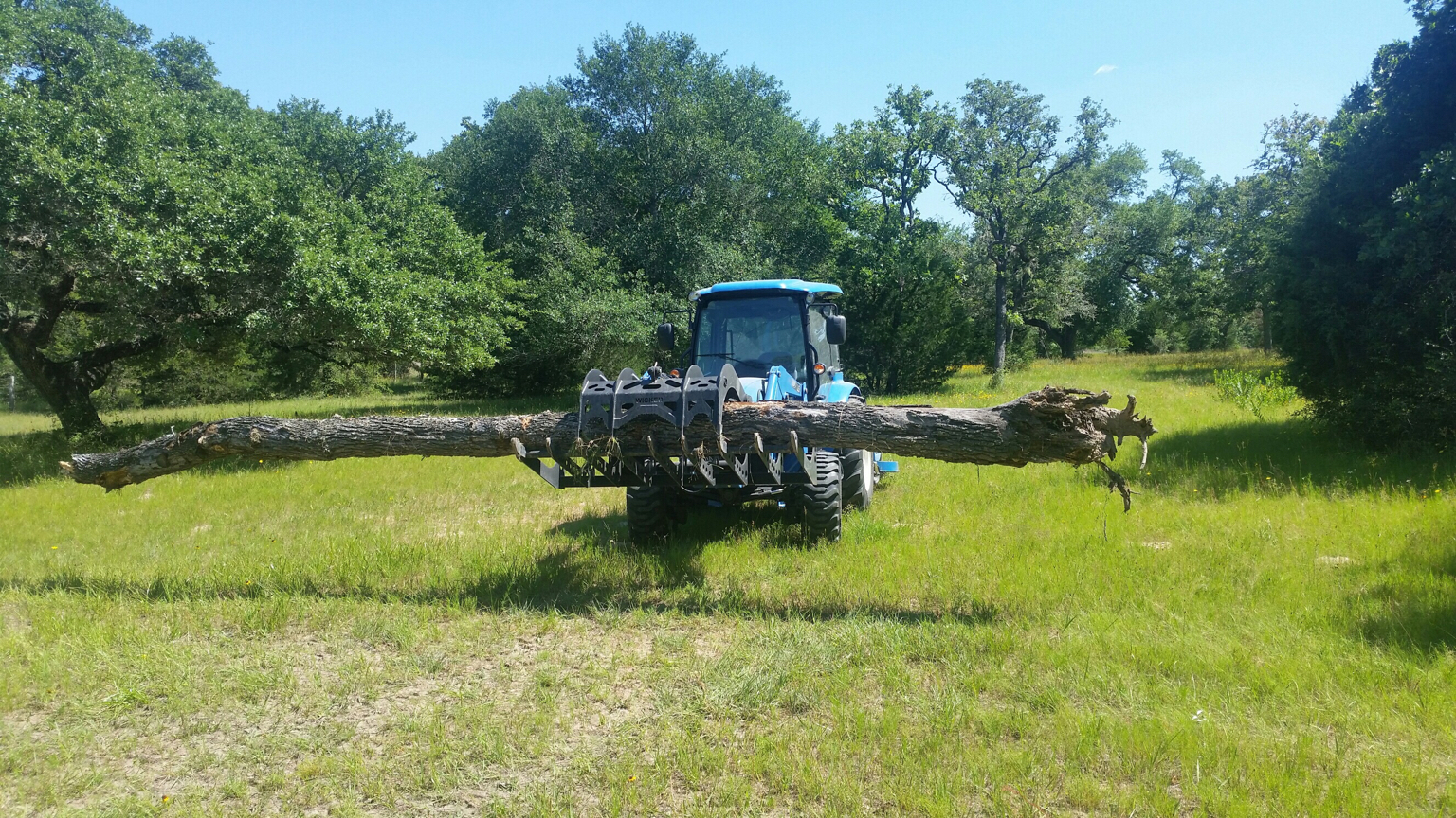

Well, my 55" single lid came in today!!! Very happy! It works so good. Can't wait to get more seat time with it!
Here's my terrible night time pictures, I'll get more as I use it!
