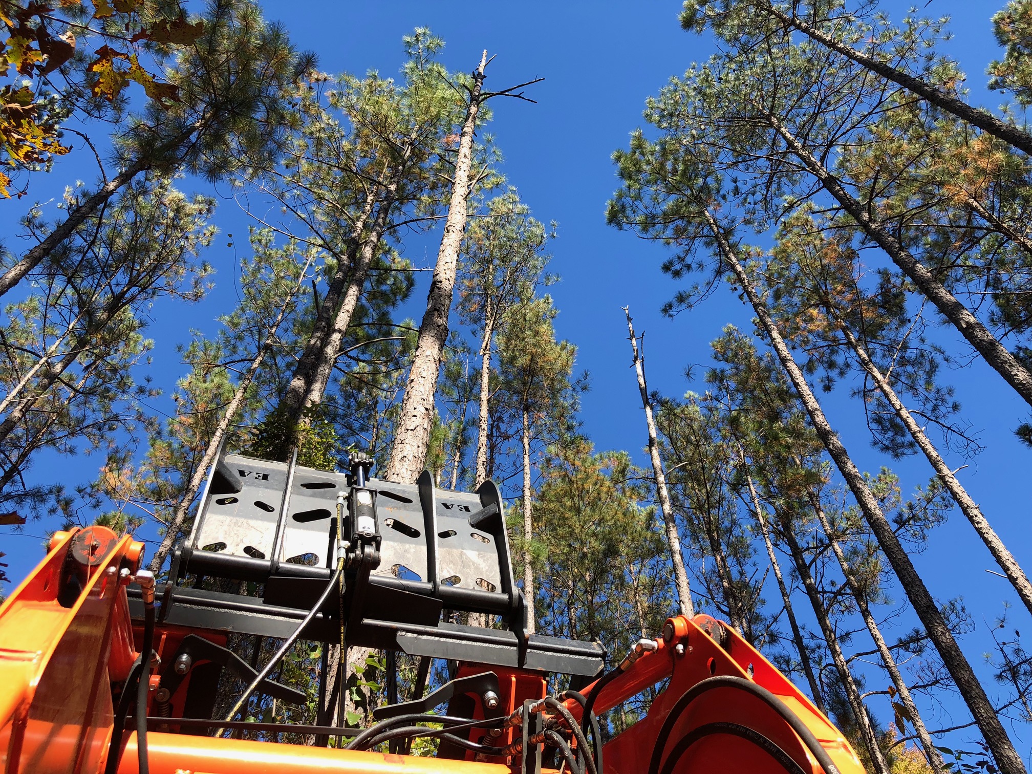

Went a little outside of design specs;)

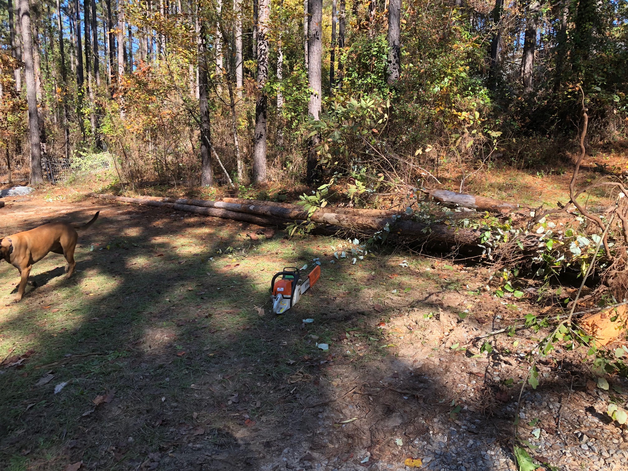

Some of the aftermath.

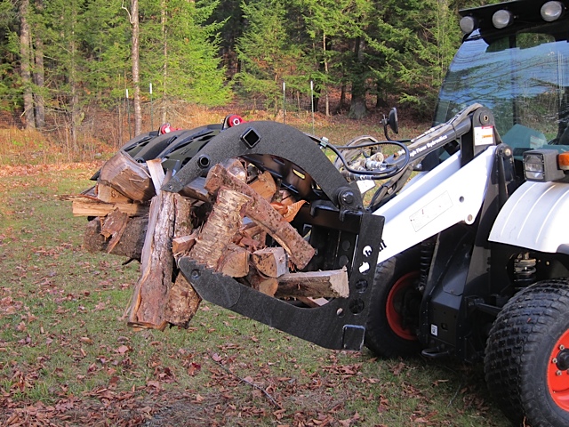

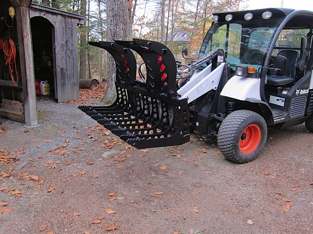

I think you'll be happier with the cradling ability of an L shaped grapple for this application.
This customer has a 66" Dual Lid Wicked Grapple on his Bobcat Toolcat and was really pleased with its firewood grabbing ability.

Thanks for the pictures. That’s one of the main things I’d be doing.
