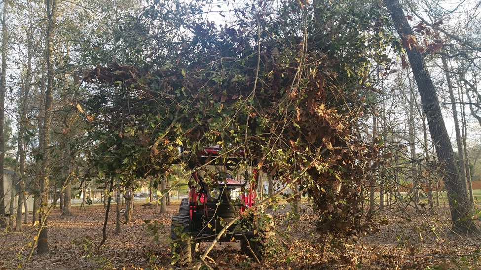

The 60" will grab just as much brush as a larger one. This is actually a 60" single on snowback's 2538 Mahindra, but who could tell? :laughing:

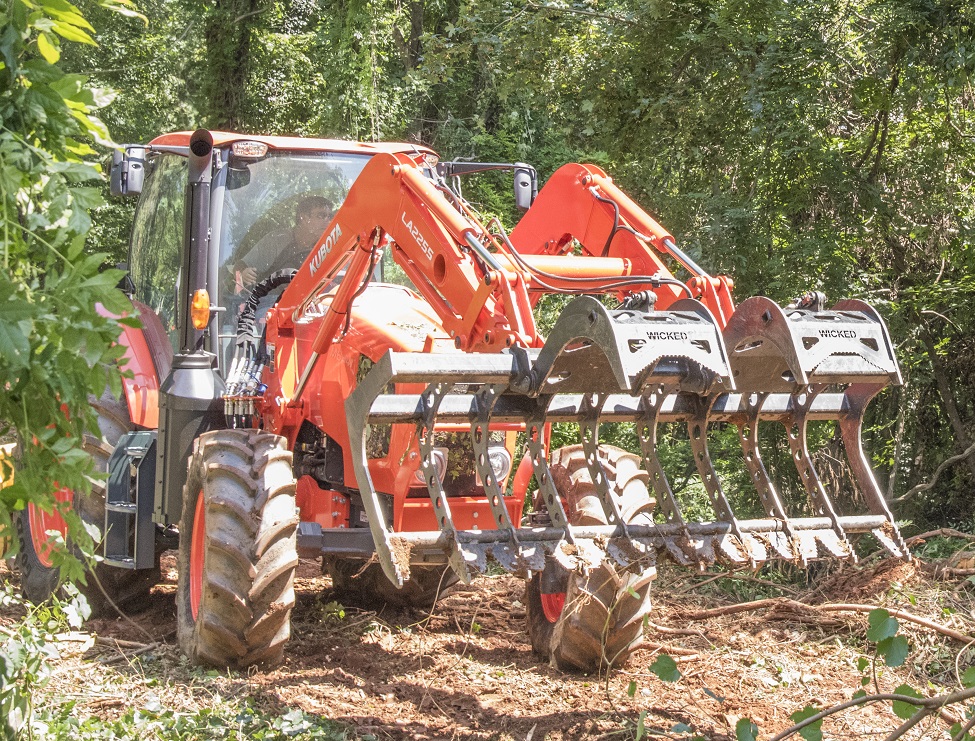

Large logs will not be an issue either. This is a 60" Dual Lid on a Kioti NX5510.
Oh, a couple of pics for comparison....because aren't pics great?
60" Dual Lid on a Kubota L4060
66" Dual Lid on a Kubota L3240

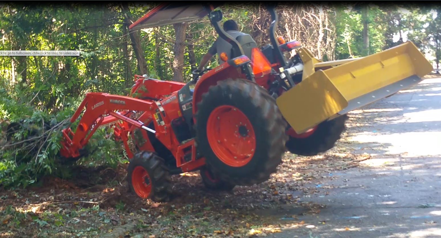

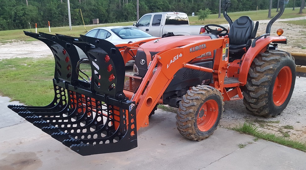

The key words I heard were "pull up". More often than not, the corners of a grapple are used to get under and uproot stubborn brush and saplings. Used thusly, a wide grapple will twist the front end loader and even lift the opposite rear wheel off the ground on occasion. For tough uprooting, narrower will be more effective and easier on the equipment, in my opinion.
We have a 72-inch single lid which has performed valiantly on our 55 horse Mahindra. But if I had it to do over again, I would go no wider than the FEL. No matter what size you get however, you will be delighted.

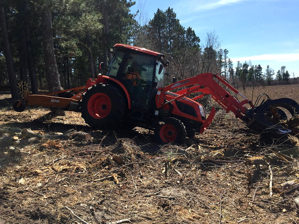

A few examples. I'm sure I have more if I really dug(pun). :laughing:
Travis

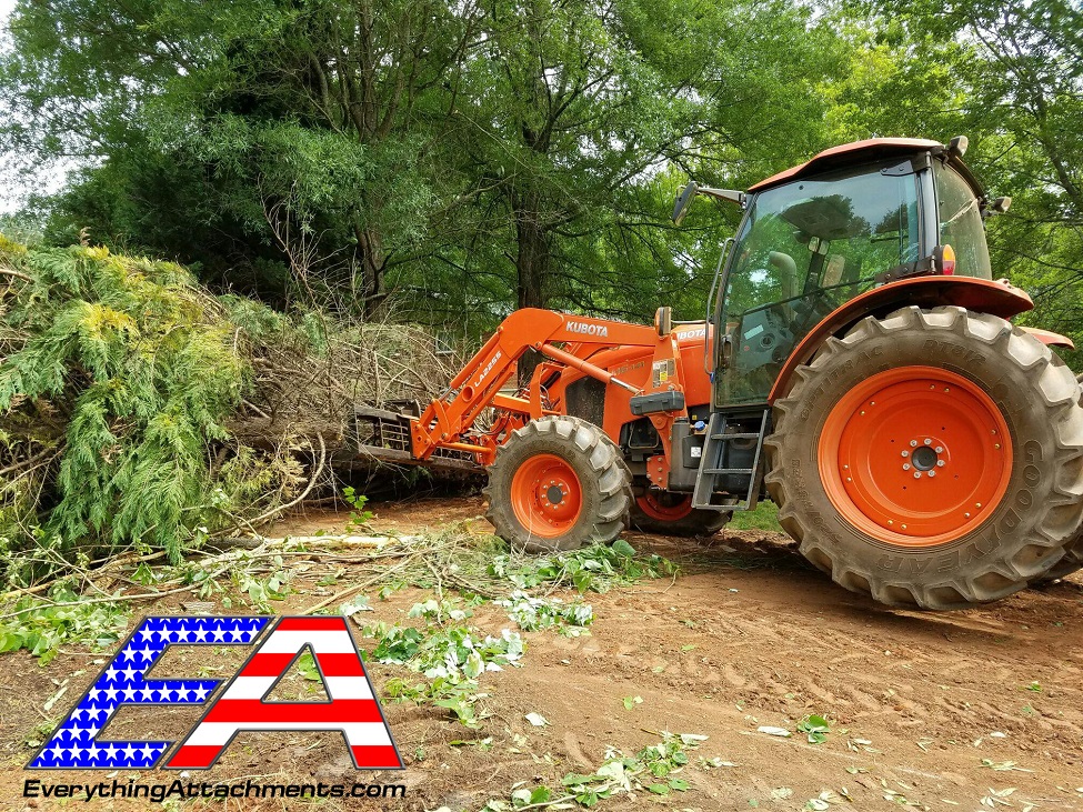

Exhibit A Kubota M6-141

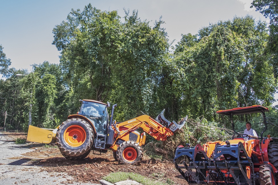

Exhibit B Kubota M6-141
Exhibit C Kubota M6-141
Exhibit D Kubota L6060(amplified on purpose)
Exhibit E Eric's famous Kioti NX6010.

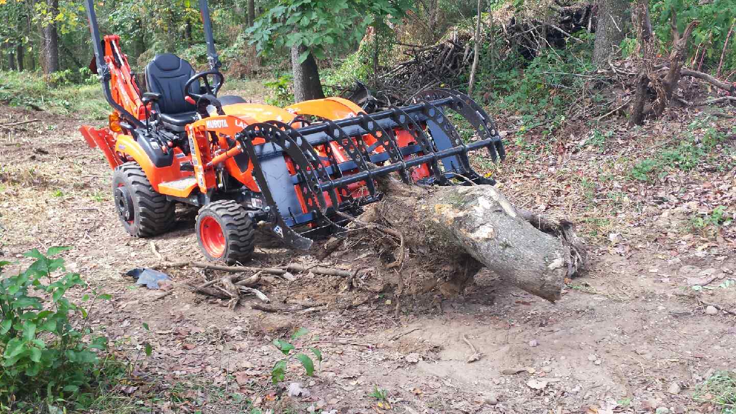

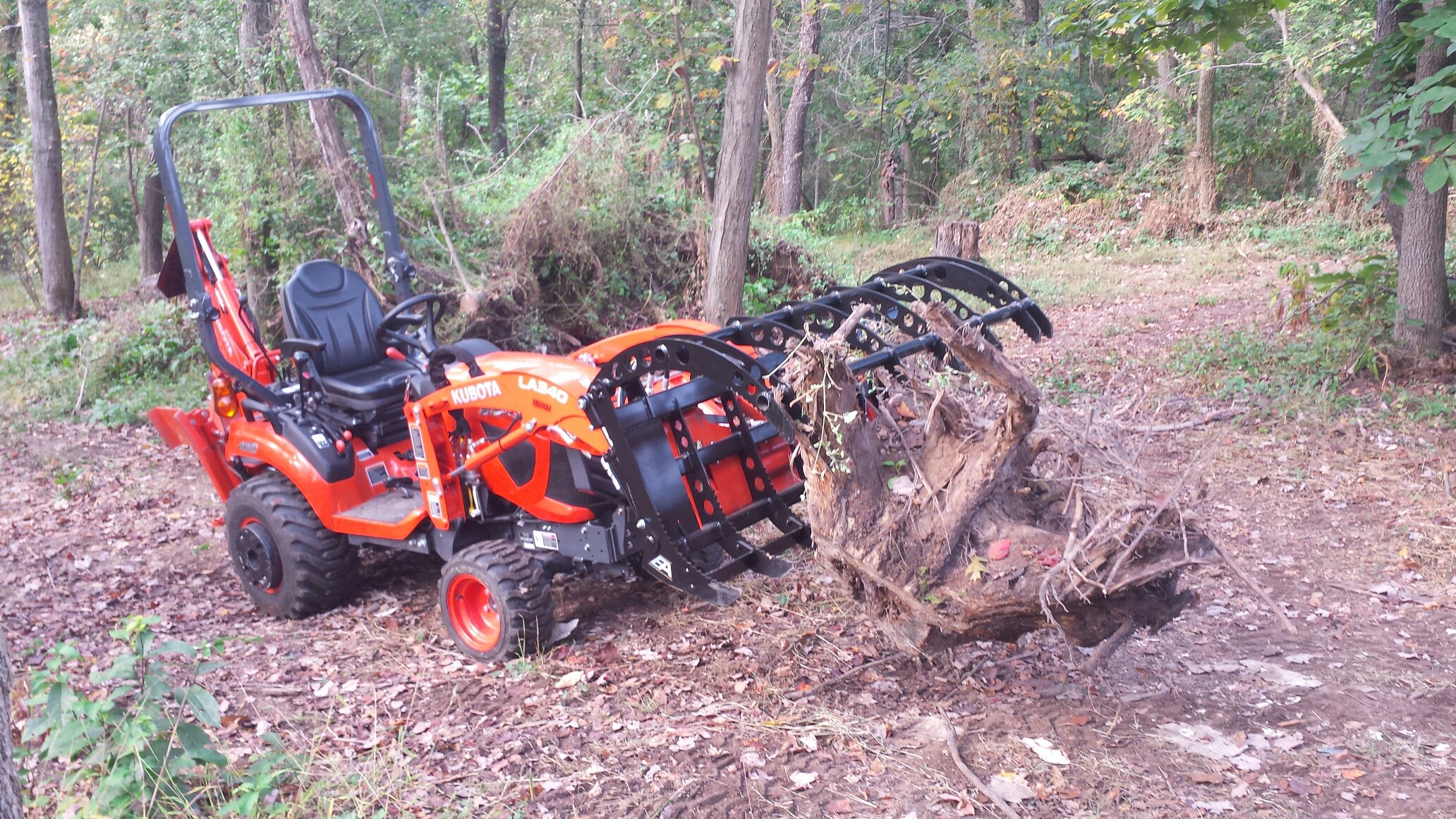

Finally got to use my new 55" grapple. While not as impressive as what some of you big boys are doing, it helped me move a lot of stumps and brush to my burn pit. Some of the stumps were heavy enough to almost pick up the backend of the tractor, even with the backhoe and wheel weights. I won't complain about doing that all day and not breaking a sweat! :)
   / The WICKED Root & Debris GRAPPLE!!!!!!!
#2,828
I am as impressed with what the BX23S is accomplishing there as I am with your taste in grapples(that's a LOT)!! :applause:
Travis

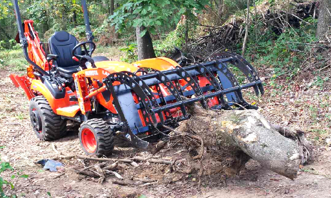

Which model grapple is this, Ted? It looks like it has wings extending beyond the tines and a brush guard built in. That looks like a good compromise. The wings keep the brush off of the tractor and the tines are only the width of the FEL to keep the work centered. To get the extra width to protect the tractor is one of the main reasons I chose a 72 inch.
523822d1462818725-wicked-root-debris-grapple-resized952016050995142038s-jpg
#2,830
It's our Wicked Utility Grapple for tractors up to 125hp. Ted built the one shown 96" wide for our Kubota M6-141, but, after using it, wouldn't recommend larger than an 84".
TOO wide for most applications, but we'd probably still build one if a customer really wanted it!!
Travis
