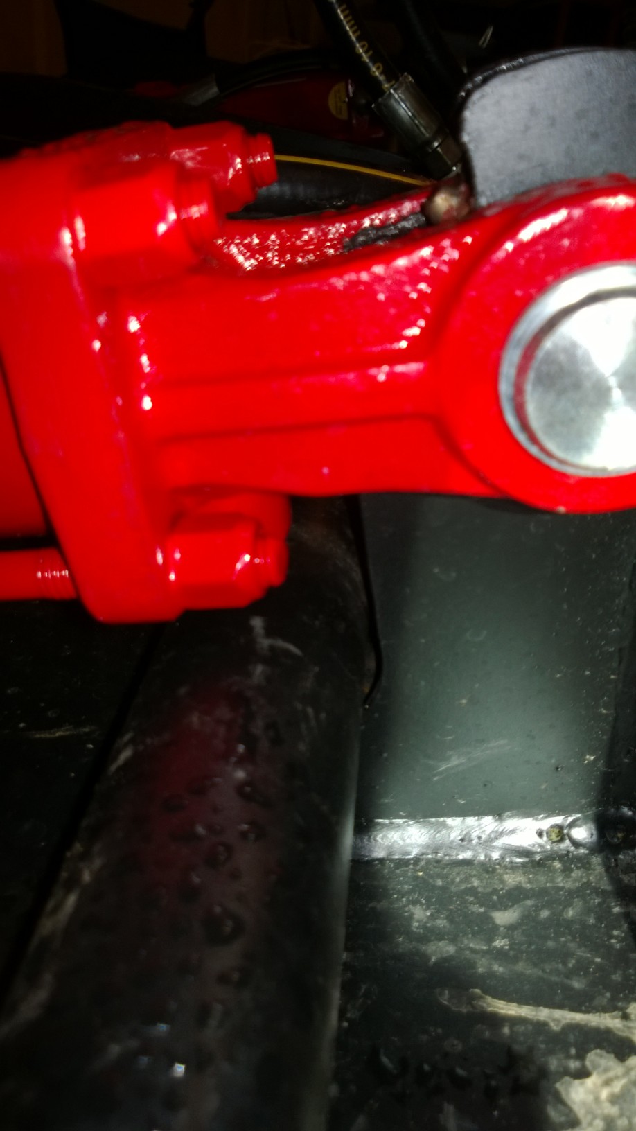

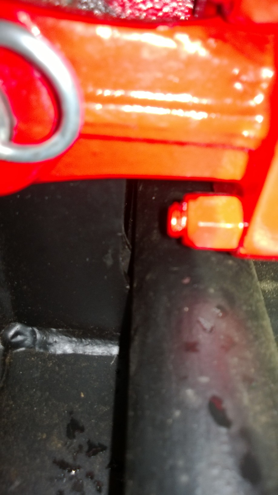

I am having a problem with my new grapple, one clamp does not close all the way. Seems like it did last week, although I could not swear to it.
I called EA this morning and talked to Rick who must have been pretty busy as he did not want to hear what I learned in inspecting it last night. He just said send a picture and they would troubleshoot from the pic.
What I wanted to tell him was that
My guess is that both sides were closing last week (new) but I can't swear to it
Turns out there is no physical interference on lid, when I detach the cylinder from one end it closes fine.
So it's the cylinder itself that is not reaching far enough to close lid.
Would have guessed a wonky cylinder, but an initial measurement of both cylinders shows them to be extending pretty close to the same amount - so not conclusive.
To confuse the issue, upon closer inspection it looks like the upper cylinder bracket on that side was welded on further back than the "good" side. So if the cylinder is at the limit of it's extension it might explain why the lid doesn't close.
Anyone have any thoughts on cause, cylinder or bracket mis welded? I attached some crummy pics that attempt to show the different spacings between the round pin housing and the top cylinder bracket themselves.

Pull the pin on the cylinder and unscrew the clevis a bit. You may be able to gain enough to make it close.

Travis just called me back, says there is an adjustment on the cylinder shaft that allows me to have the cylinder reach a bit further. Says a couple folks have had to do that.
Sounds like an easy tweak, although I won't be working at the property for a couple days to check it out.
Sent from my Samsung SPH-L710 using TractorByNet
Now I know, rookie mistake. Somewhere in the back of my mind I knew most cylinders were adjustable, but I guess I forgot. I won't forget again....:eek:
But I always like simple fixes even if they make me look stoopid.
