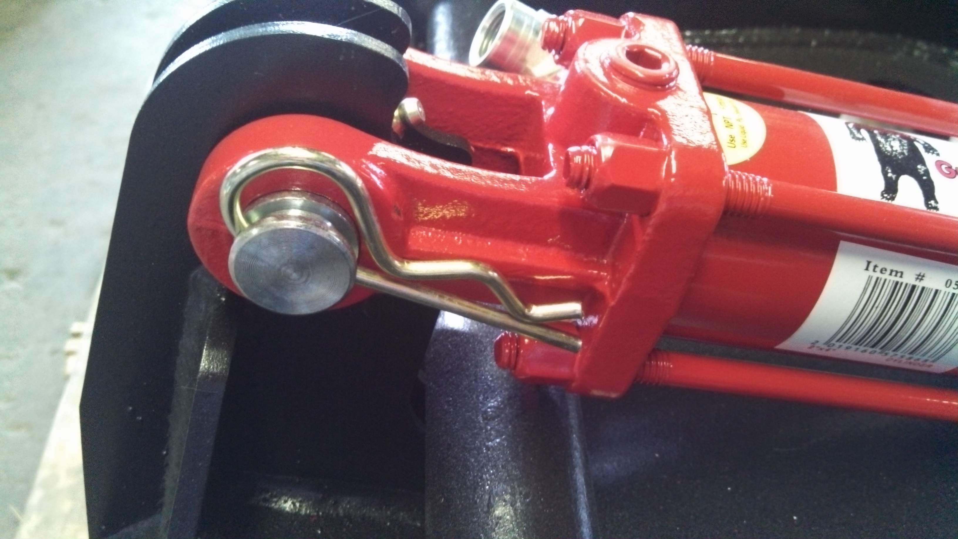

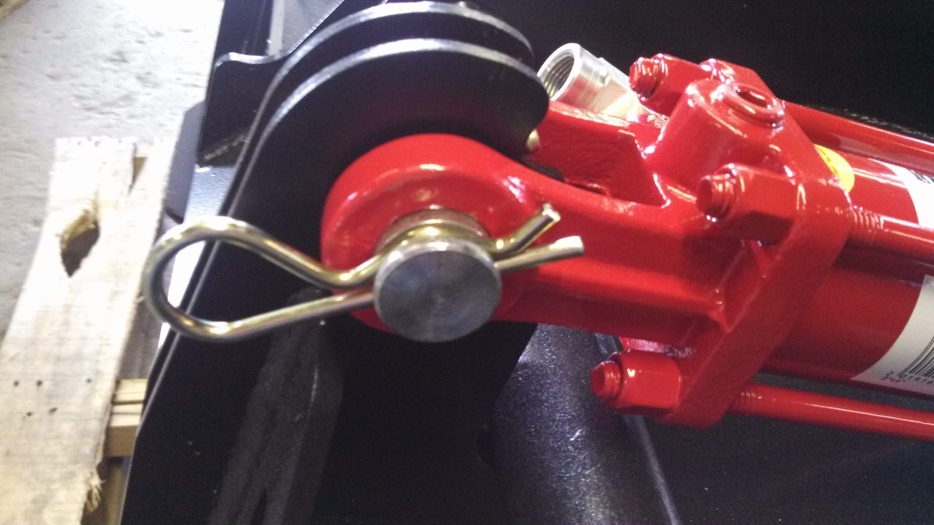

When I noticed the other two pins missing last night, I was on the way back home and did not really look close at it. But I did notice on at least one of the round pins that hold the cylinder that the whole thing was loose enough to turn. So I think however I push in the haripin clips, the position will change as the round pin turns over time. I'll be back out there in a few days maybe (weather permitting) and will look at the situation closer. Still like the elegant idea of a clip, though. If anyone gets a chance to measure the bottom of the groove where the hairpin clip goes through, please let me know and I'll look for some source of the clips online.
I think Harbor Freight sells a box of ?25 or 50 e clips of different sizes. Cheap money.

We're gonna ship 4 R-Pins and 4 cotter pins out today. The cotter pins will definitely stay put.
This is how they've been:
The guys will start pushing the R-pins all the way through. This way is much harder to remove and shouldn't go anywhere.
For added security, you could even wrap the end of the R-pin with tape or wire it shut.
<img src="http://www.tractorbynet.com/forums/attachment.php?attachmentid=340403"/>
Again, consider E clips. There is nothing for brush to snag. No meat hooks as with cotter pins. Come off and put on with either screwdriver tip or pliers. Easy peazy.
