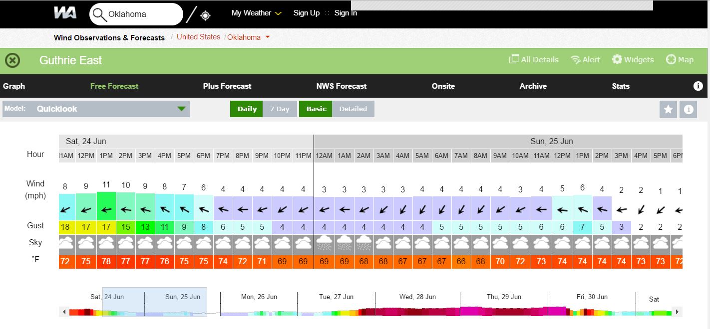

Here is the Website that I use for planning when to burn the brush piles: Map Results | Wind, Forecast, Radar, Weather & More | WindAlert
Today and tomorrow would be good:
Hey I haven't seen that before thanks!! I usually burn during a long rainy day when I can't work or when the show is on. There are too many big fields and houses nearby to risk a lighting off a big brush pile with out some rain/snow for me at least.
You well know how fickle the Oklahoma wind can be!

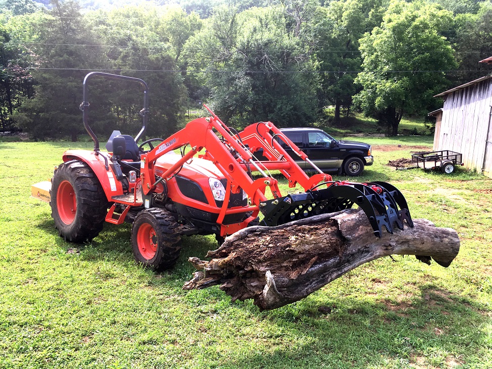

All, I did receive my 54" single lid grapple on Friday from Fedex which is 6 weeks to the day from when I ordered it from EA. Picked it up late in the day and was able to install the grapple same day in the dark no less without issue. Hook up was a breeze and hydro hoses were exactly what was needed so Thanks Travis! I cycled thru opening and closing the cylinder several times then checked my hydraulic fluid. Added about a quart to get it back between the lines and good to go! Have put about 4 hours on grapple today and it is performing flawlessly.
Man, those NX tractors are becoming quite popular and I sure LOVE seeing the Wicked Grapple on em!! :D

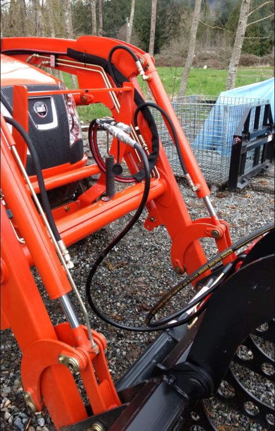

One question - I was thinking there was a spring attached to the hoses that kept the hydro lines up and away from the action? Is that an optional item? or aftermarket? If so anyone have a link? Thanks.
The single lid models do not come with a spring hose saver, but it is offered as an accessory here on the website: TRACTOR HOSE SPRING KIT
Here's a peek of fellow member DieselBound's installation of it.

I thought EA intended those spring hose savers to be welded to the grapple. I guess the torque tube works too.
It works either way. Some prefer to mount it to their torque tube for use with multiple attachments.
Zip tying the two hoses together 1/2 way between the grapple and tractor improves uniform coiling and really helps "tame" the hoses when a spring saver isn't present.
