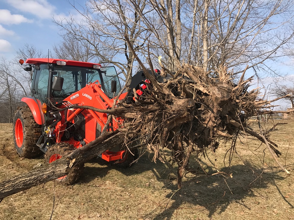

My tractor finally showed up and the grapple was the first thing attached! Before getting the grapple dirty I snapped a few shots....and snapped a few first loads. I am very impressed. I may have wanted some additional hose length. At full roll forward the hoses do utilize the spring loaded hose guide. It may be fine, but makes me nervous. I did lessen the guide and get a few more inches.
Net net...I would buy again from EA.
Heck yea! The stumps match the grapple....WICKED!
Keep in mind, the spring is there to flex backwards. If it didn't, it wouldn't be doing it's job.

Travis,
It flexes backwards just as it's designed. Flawless. The first time you see it (as a newbie) it makes you pucker!
Yes, black walnut stumps are wicked. They are a fight to get out!
Great grapple and could not be happier.
