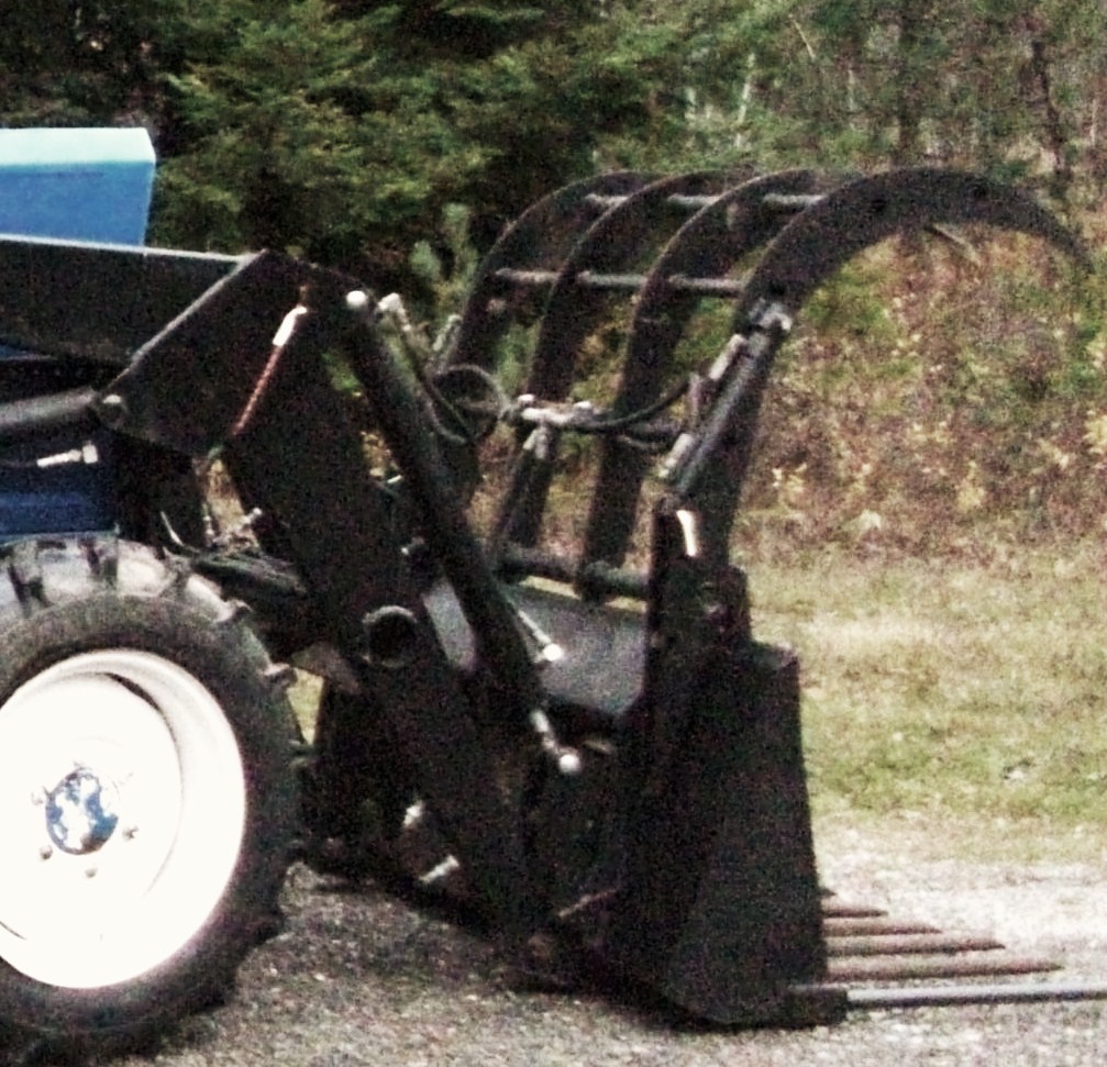

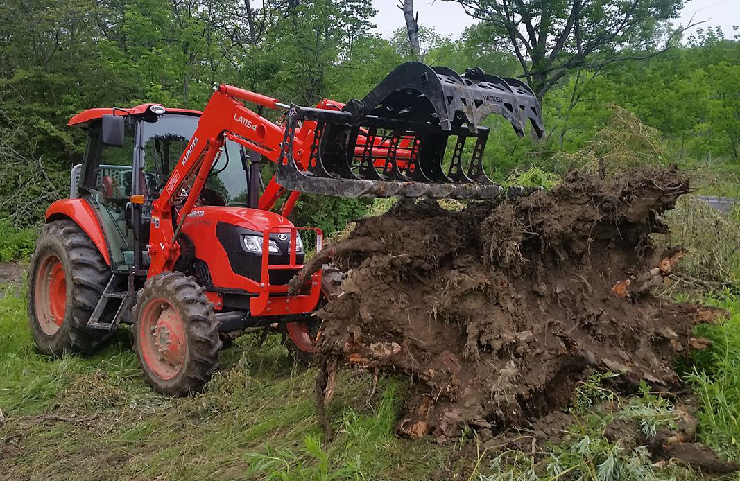

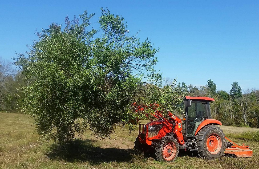

My largest opens to 46" and I regularly want more when dealing with brush.
   / The WICKED Root & Debris GRAPPLE!!!!!!! #1,402
I'm beginning to think that grapple opening is like horsepower. Once you've tasted more it is hard not to want it available even if most tasks can be done with less. I still believe that a 30" opening grapple would be my favorite implement if that's all I had but a 37 would be even better and a 44 better yet. I don't doubt for a moment that I could figure out things to do with a 50" that I cannot do with my 44" too. I agree with TomSeller that grappling brush is where a very wide opening is especially useful. Brush is light so the limiting factor in how much you can collect and carry in one load is nearly always determined by how much you can cram into one grapple bite. Grapple width is one factor but brush is "sticky" so even a 48" wide grapple can clamp on a huge wide load of brush. Opening size is therefore the bigger factor. I'd much rather have a 48" wide 44" opening grapple than a 60" wide 37" opening grapple as it would be more versatile.
I don't know exactly how much weight I'd be happy to compromise on in order to get a bigger opening but I wouldn't even blink at 5lbs per extra inch and 10lbs per inch might be reasonable too. It does seem more about geometry than steel however. Wish I had CAD skills to play with moving pivot points and mount locations.

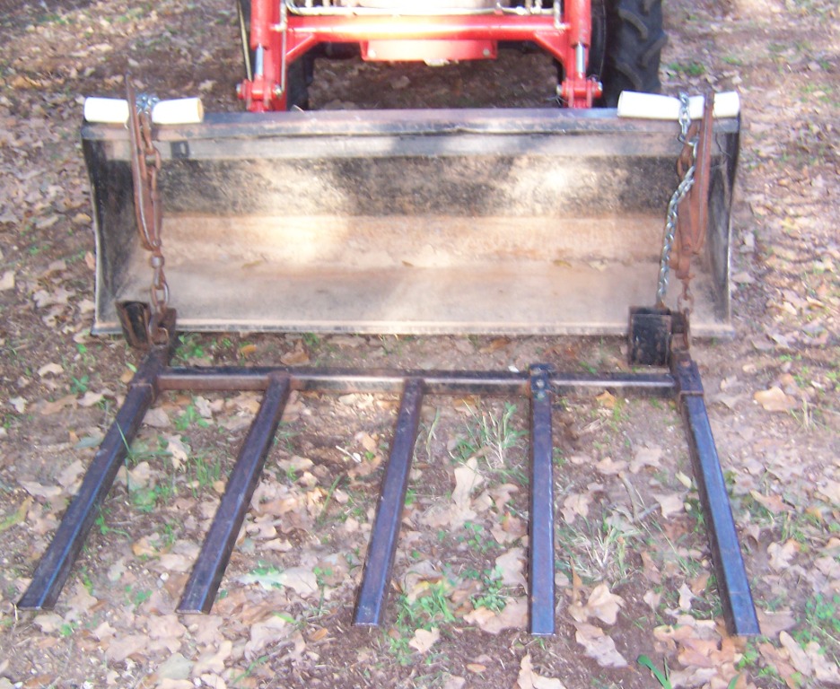

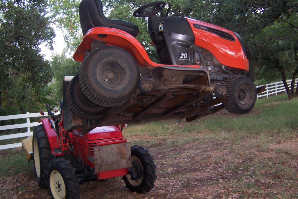

I've looked into grapples, however they cost serious money and would require some expensive reworking of the hydraulic system. I've found that almost everything that can be done with a grapple can be done with a good set of forks for much, much less money. Just slide the forks under the pile of brush and rock it back. Off you go!
Also, because the forks don't have the top clamp, they are much more versatile. After you haul your brush, you can take pallets off trucks and use them as a lift for anything you need to get under - like a riding mower.

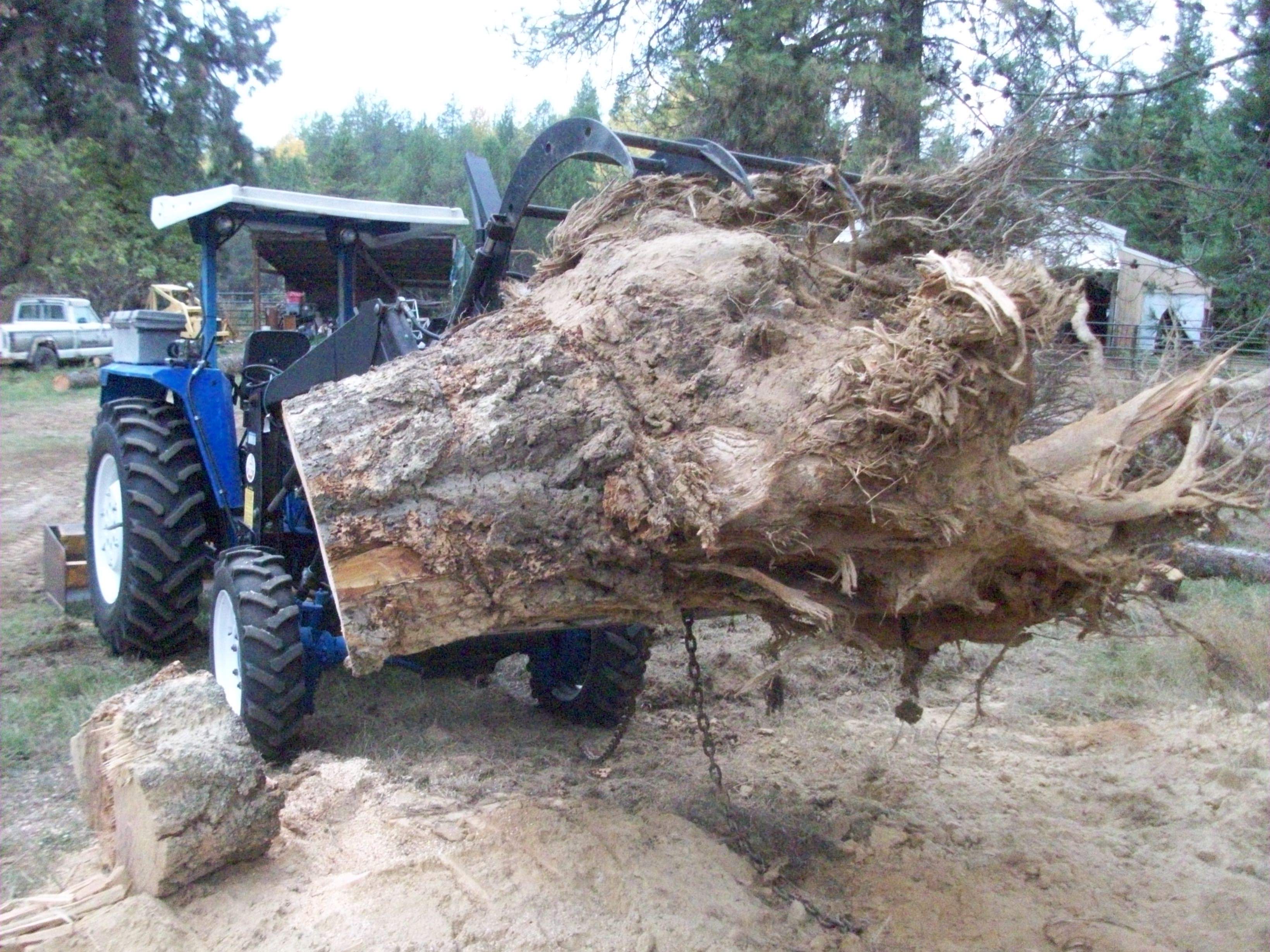

Maybe you should realize that this is a discussion forum not simply a marketing thread for EA. And, if the subject is so "well worn out", why isn't there a solution?
I don't know who made my grapple or what it weighs, but it is 66" wide and opens to 49" The problem I see with the wide openings is (at least in my grapples case) is that it won't even clamp a 22" log inside the grapple.
It does do well for large objects.
Works good enough for me and sometimes it is nice to have the large opening but gave up the ability to internally clamp small objects.
From EAs pictures they sure look to be a great compromise.
Maybe someone will figure out a way to do both- large opening AND clamp smaller objects but haven't seen one yet.
