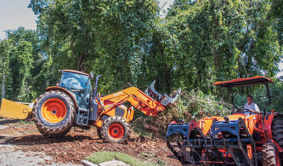

Single Lid Wicked Utility Grapple
Dual Lid Wicked Utility Grapple

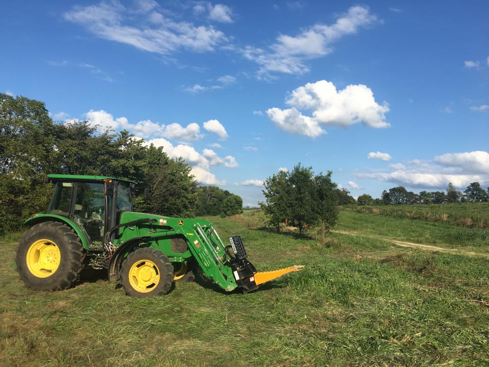

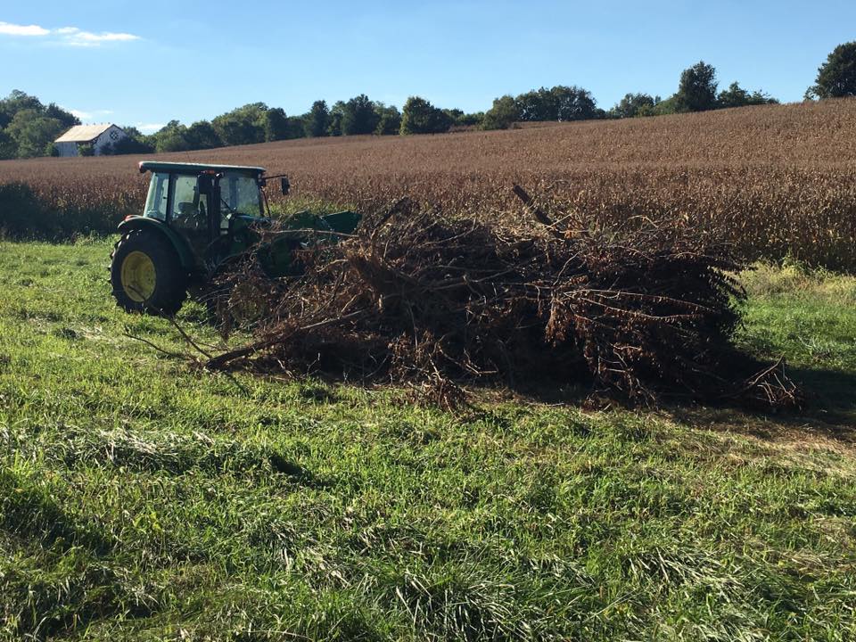

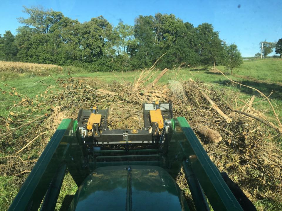

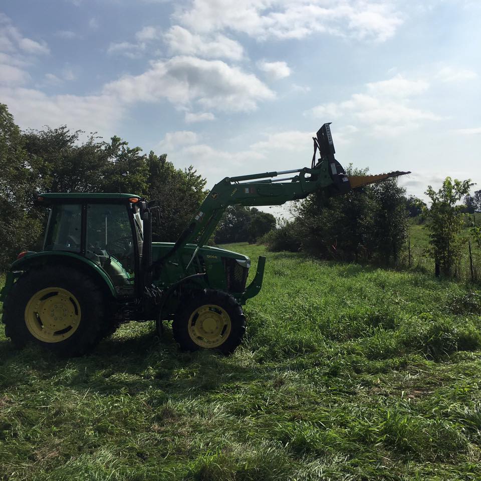

This is a 78" Construction Attachments Extreme Duty Grapple... on a 5100e.
My Danuser Intimidator pulled a old woven/barbed wire fence line with encumbering Honeysuckle and crappy 2-4" sapplings. Put it in piles... then I returned returned with my Grapple.
First bite was small and I thought... "This is going to take forever!" took it about 1/4mile to my burn pile location.
Second bite... well... it wasn't so small. The wire and criss-crossed trees, roots, brush created a connection which kept me from removing a 'bite'. It actually just took the whole rest of the pile. So, I geared down and pulled the whole thing.
This thing is big and heavy however... I have found I really need a ballast box. Even with over 900lbs of beet juice in each back tire.
View attachment 480805View attachment 480806View attachment 480807View attachment 480808
Loading your rears is really for traction. It's kind of a "freebie" because it adds no weight to the frame of the tractor, it's just sitting on the ground. But for loader work, besides the increased traction the beet juice does not offer any reduction of loading on the much smaller front axle. To do this, you need weight behind the rear tires. Then the rear tires are the fulcrum, with the loader on one end of the lever and the attachment/ballast box/etc. on the back.
Usually you can get by with a heavy attachment instead of a ballast box. And often times its convenient to have on anyway. If I'm doing dirt work I will throw the 8' Harley on the back as it always comes in handy. If I was grappling brush/etc. and doing cleanup i'd probably have the rotary cutter on the back.

Mega Compact Utility Tractor Wicked Root Grapple from Everything Attachments
The blue tractor on EA's grapple page is mine.
