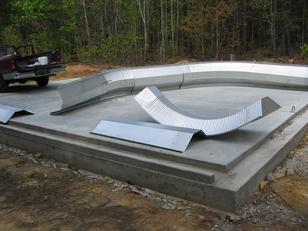

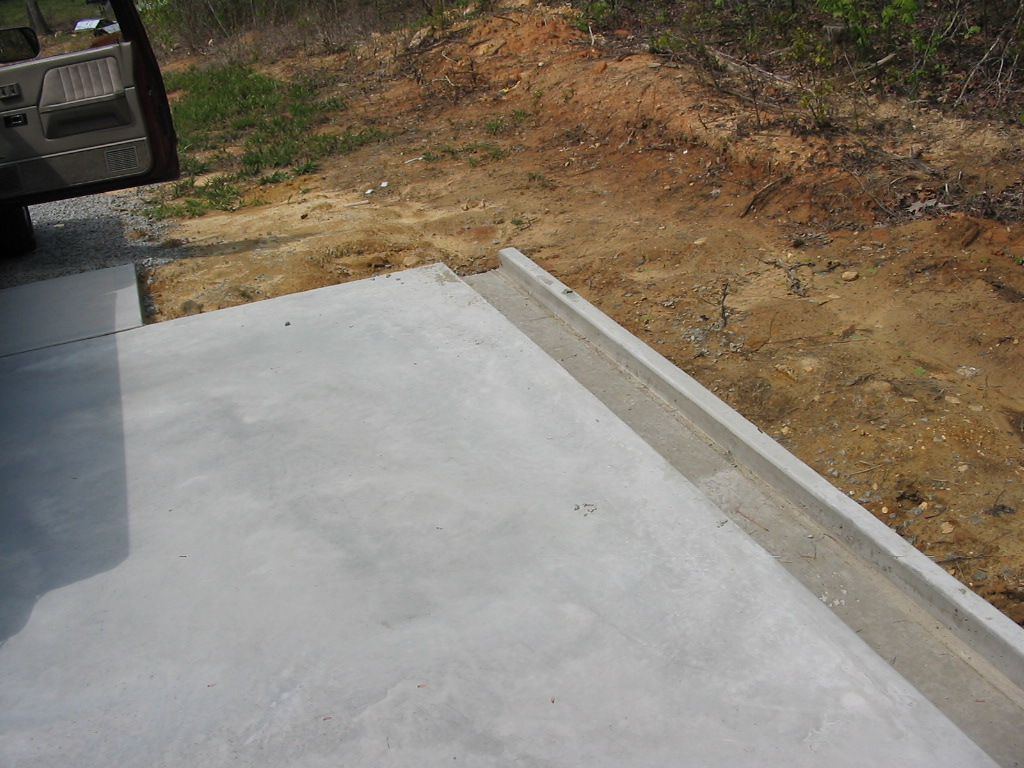

I am just starting on my steel US Building. It is a 20x30 "A" style. I am going with the keyway channel.

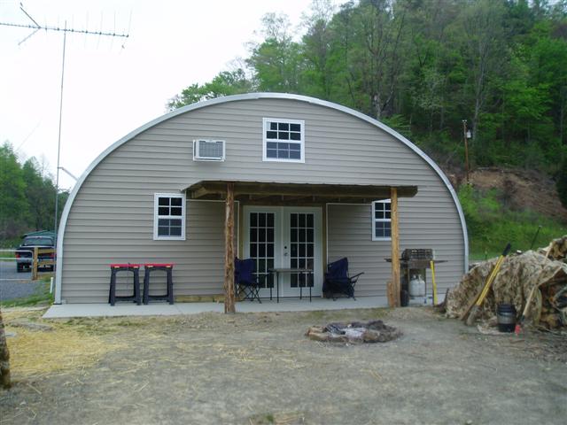

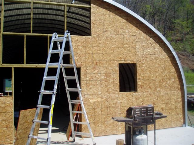

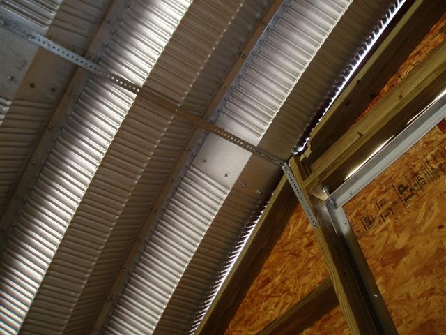

Also, i guess my framing looks a little eclectic...let me explain. I was going to go with board on board-1x8's 16' long, but the guy that was going to mill them(poplar) had a big order come in ahaed of mine, so i would have had to wait too long. While i was looking for another source, i found the 7/16 OSB at HD for $4.98 a sheet, so we decided to OSB it and go with vinyl siding. Anyway it is in.....

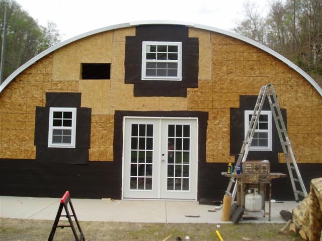

With the windows and door in, it really looks nice!!! I really like that window on the top. Not sure why, but it does all something to the building that I wasn't expecting.
I the framing PT? All of it? From one of the pictures, it looks to have a green tint to it, but I don't know why you'd use PT wood for your framing? If you do for some reason, did you use hot dipped galvanized nails, or nails specially rated for the new Preasure Treating of the wood? If not, you might want to add some nails or screws to your OSB and the lumber it'self as the chemicals in the PT wood will corrode the fasteners away in just a few years. Or so I'm told and I've read.
Are you going all the way to the ground with the siding? or are you going to put a nice brick or rock wainscoating along the bottom?
Eddie
   / The truth about Arched Steel Buildings...
#36
Eddie,
Yep, all PT 2x6 & Galv nails. I guess i want it to last a couple of years.....:rolleyes: !I'm going all the way to the ground with the siding. That hole to the left of the upper window is for the A/C. Since i am not a fan of sheetrock we decided to do the inside walls with the OSB and trowel on joint compound in a random swirl pattern, then paint. I'm about 75 yds from a creek and in the "100 yr" flood in the late 70's the floor of the building would have been under a foot or so of water. Do to that, my wife decided to polish & stain the concrete floor and paint a border or pattern onto it. That way if we ever get wet we can sweep it out once the tide recedes. Siding starts to go on 2morrow, pic's to follow.

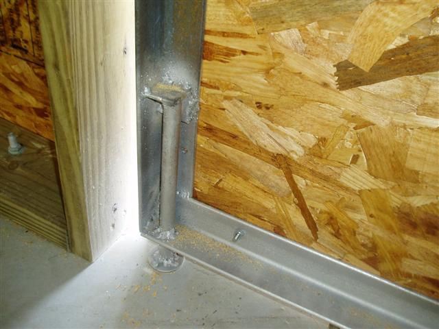

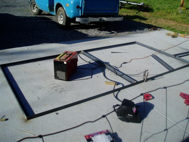

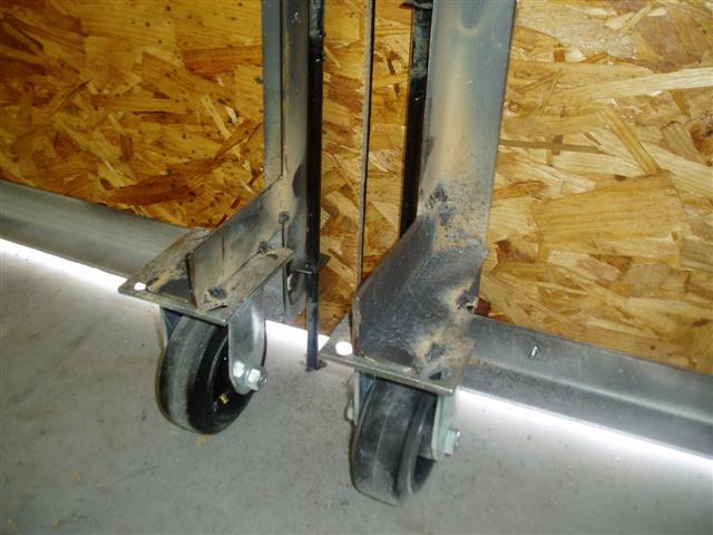

The streetside barn door frame/pin idea that i came up with...(don't look at the welds!....i had to use my 110v unit and they ain't pretty:mad: ) The 7/8 pin is 4" into the concrete resting on a 1/4" nylon washer and the hole is filled with grease. The doors are 6x12' each, framed with 2x2 3/16 angle. I will cross brace them later when my Millermatic 210 has something to plug into(still on temp pole)
RD
