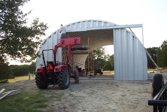

I built this in 2000, 40 X 60.

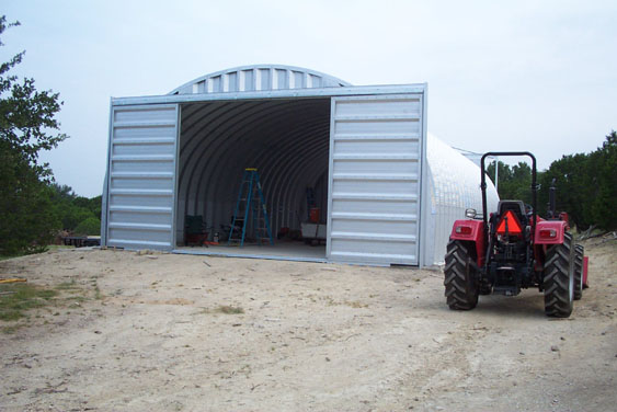

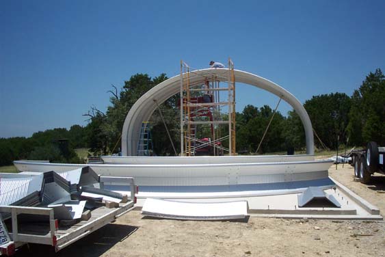

Bought ours from Steelmaster, out of Canada. It is 30' x 50' with end walls and doors. It is a drive-thru with sliding doors, 14' wide by 12.5' high. The building kit cost $8,100 add the $1,200 for the slab and about $800 to pay the highschool kids who helped and we have a building that will be around longer than us.
Here are a couple of pictures to show how we did ours. Looks just like MotorSeven's pictures, just different people.
