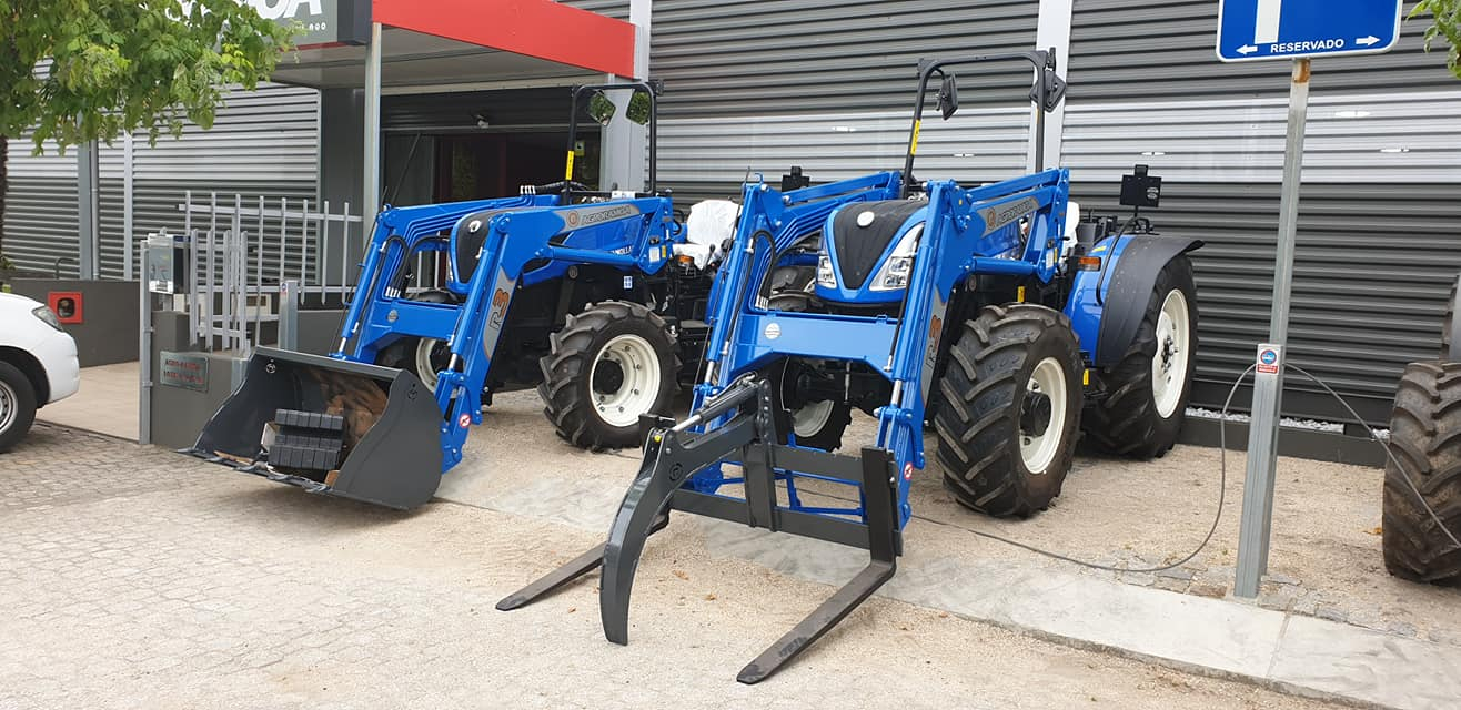

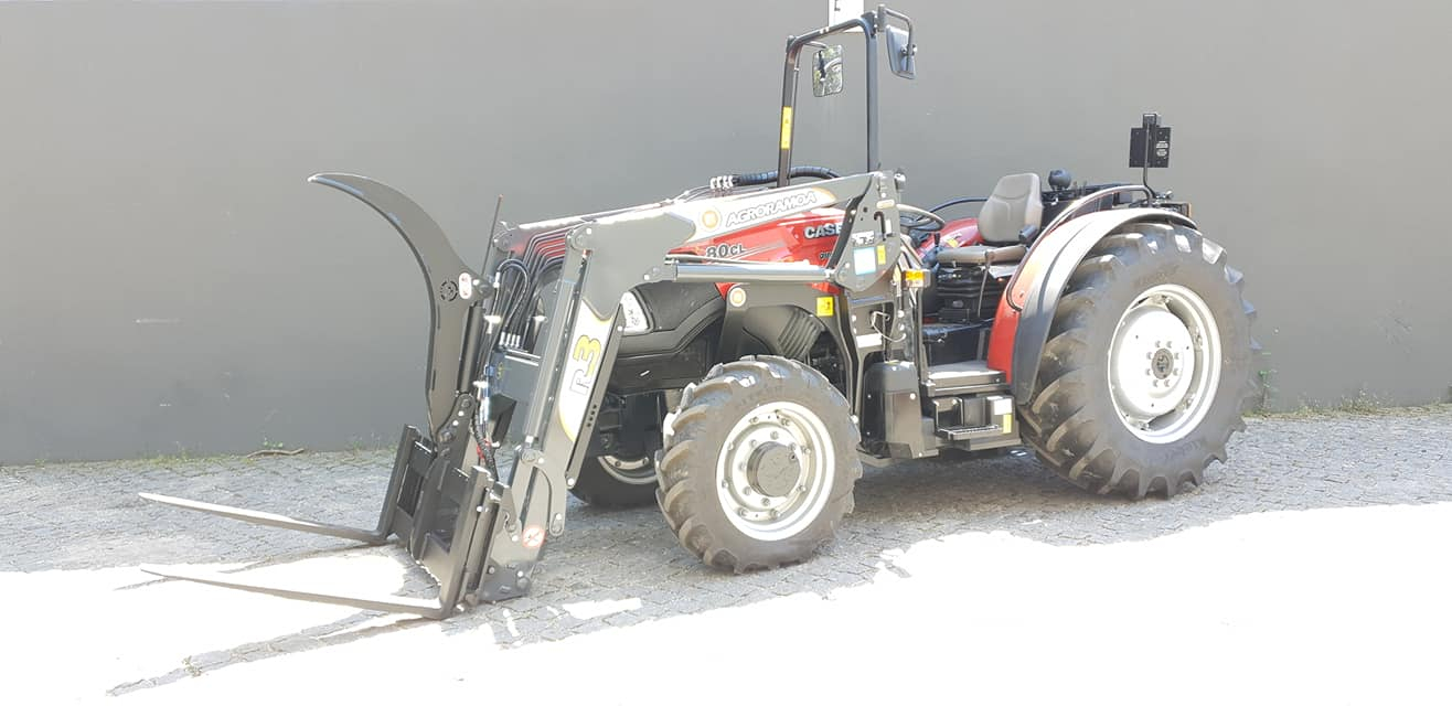

   / The "thumb"
#43

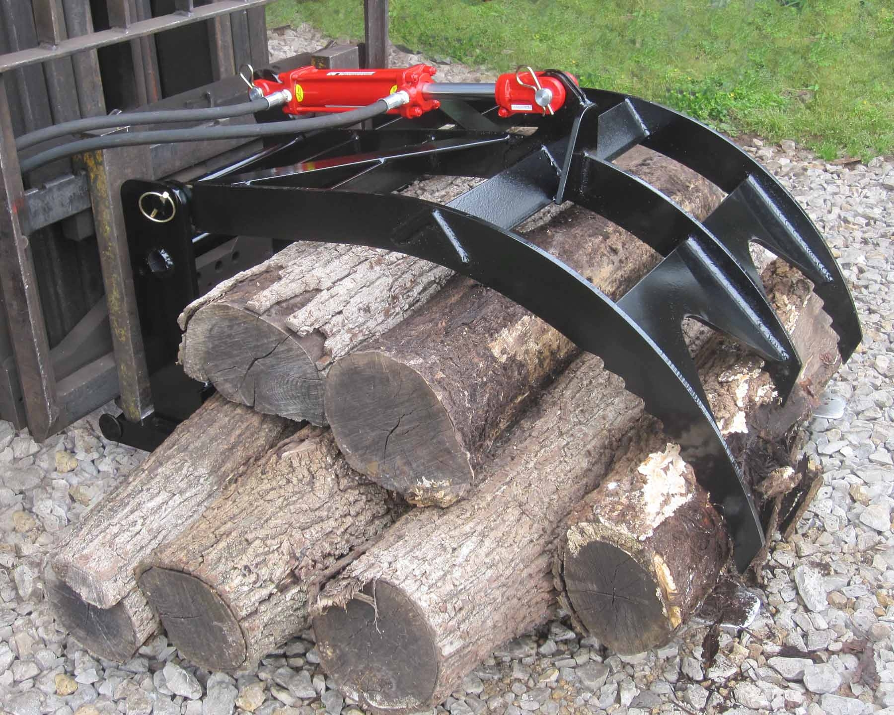

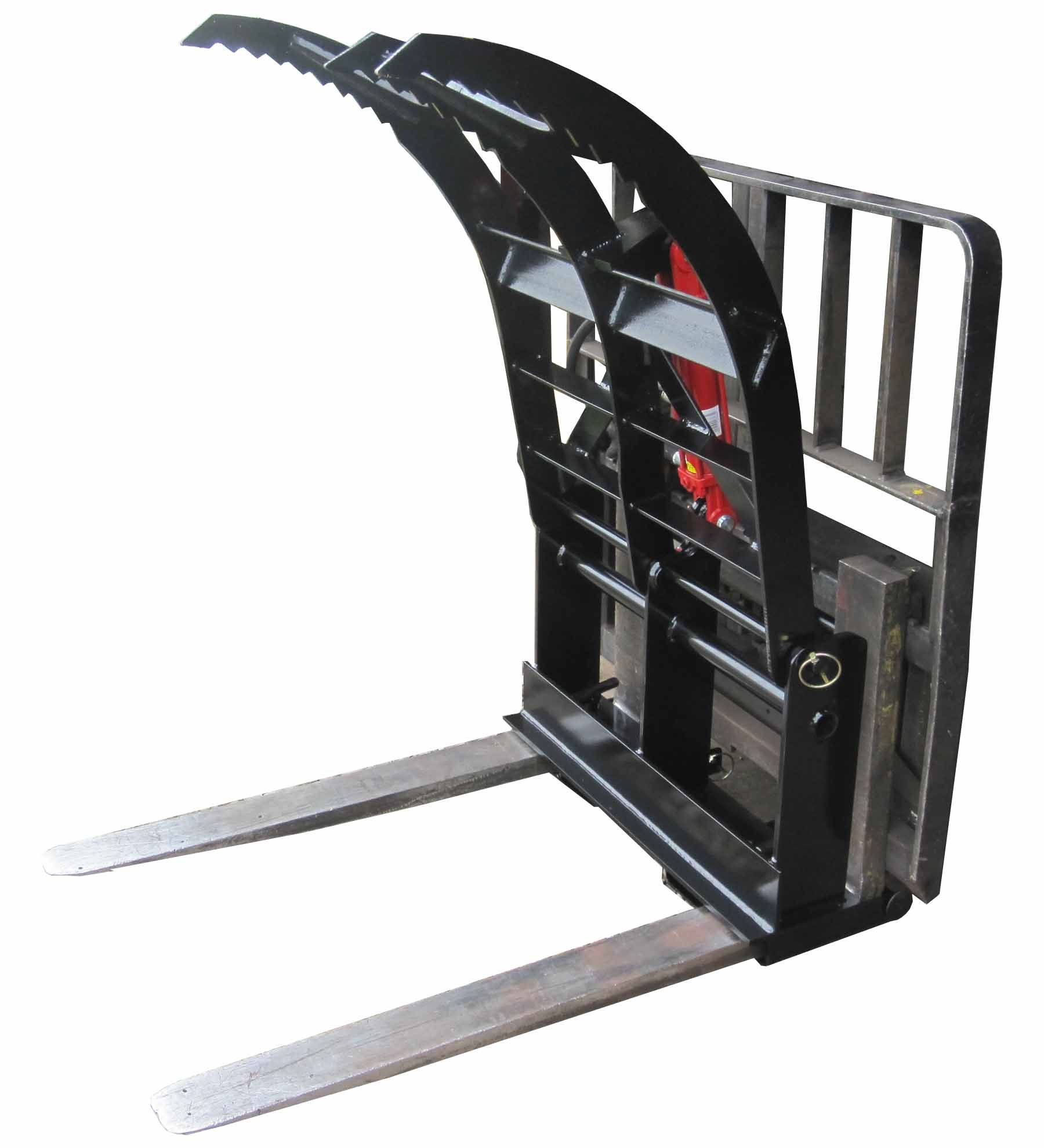

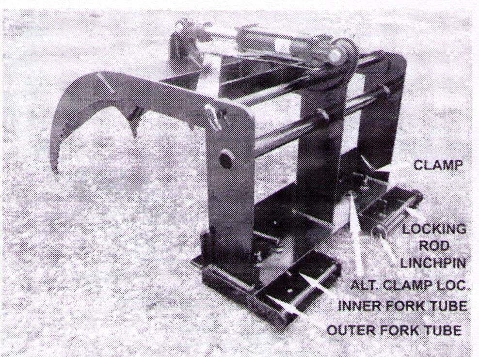

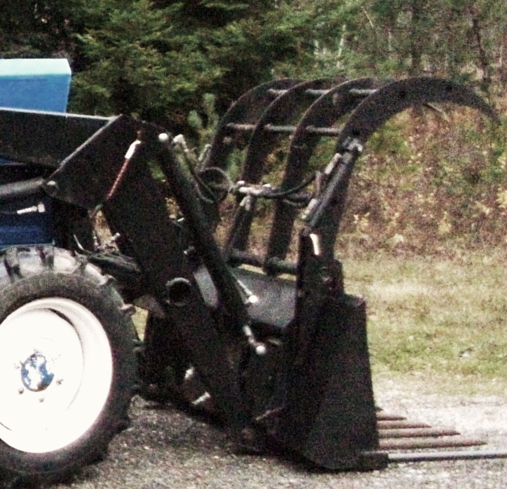

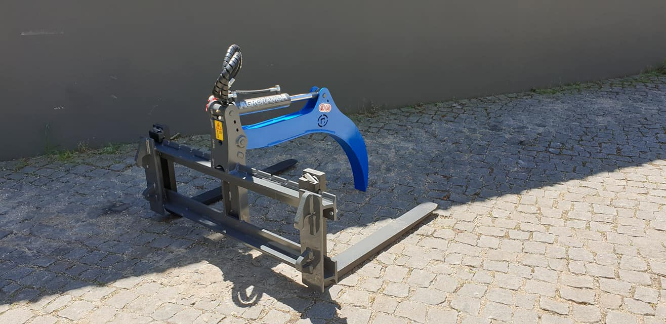

I'll share some pictures of similar style of thumb and forks setup we have here for brainstorming purposes.
When I'm doing DIY projects, I usually look at lots of pictures and absorb as much as possible.
View attachment 777719 View attachment 777720 View attachment 777721
Hey guys, do most of these thumb assemblies lift off of the frame, or are they welded on? They fall short of opening to 90 degrees, which is one of our goals, but if they easily lift off the frame for those occasions when you need to pick up a tall pallet, then that's no big deal.
I'm thinking that if they are indeed removable, it might make more sense to just sell what I have and buy one of those. I'd still want to weld 3-point lift tangs/pins onto it, so I'd be doing some fab either way (unless I find and buy one that's both 3-point and JDQA), but that might be less work than what I already have.
   / The "thumb" #44
This one I shared in particular, it's solid with the forks frame and it's made specifically for logs. That's how smaller loggers haven't quite invested in a log crane yet load they trailers with.
You can remove it by pulling the pin for the thumb and the one for the cylinder, although, a little bit of work is needed compared to other solutions that may offer some sort of quick change feature.
The thumb design can vary a lot depending on your needs.
It shouldn't be too hard to create a quick change feature on the thumb that you could simply pull one or two pins and the assembly comes out. Like the concept of the receiver hitches, but a beefy one and mounted vertically so the assembly would slide up to come out.

There is a slide on the forks style: https://www.4startools.com/336S27-Pallet-Fork-Mount-Grapple-336S27.htm
And: PALLET FORK – PRECISION MANUFACTURING

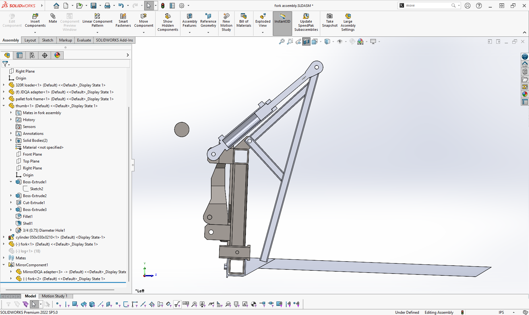

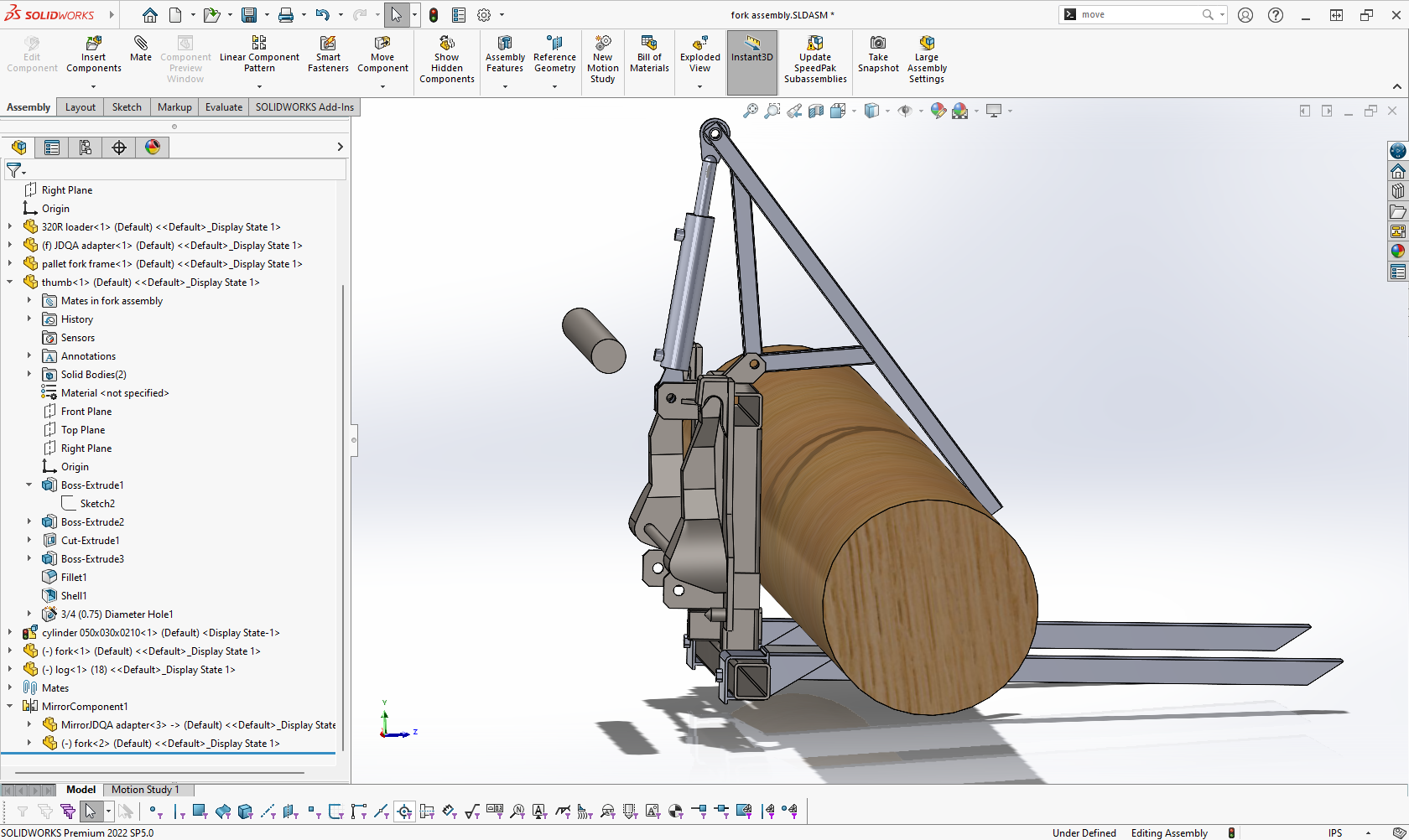

   / The "thumb" #47

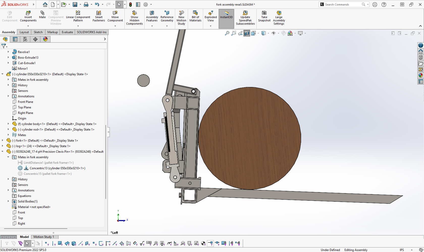

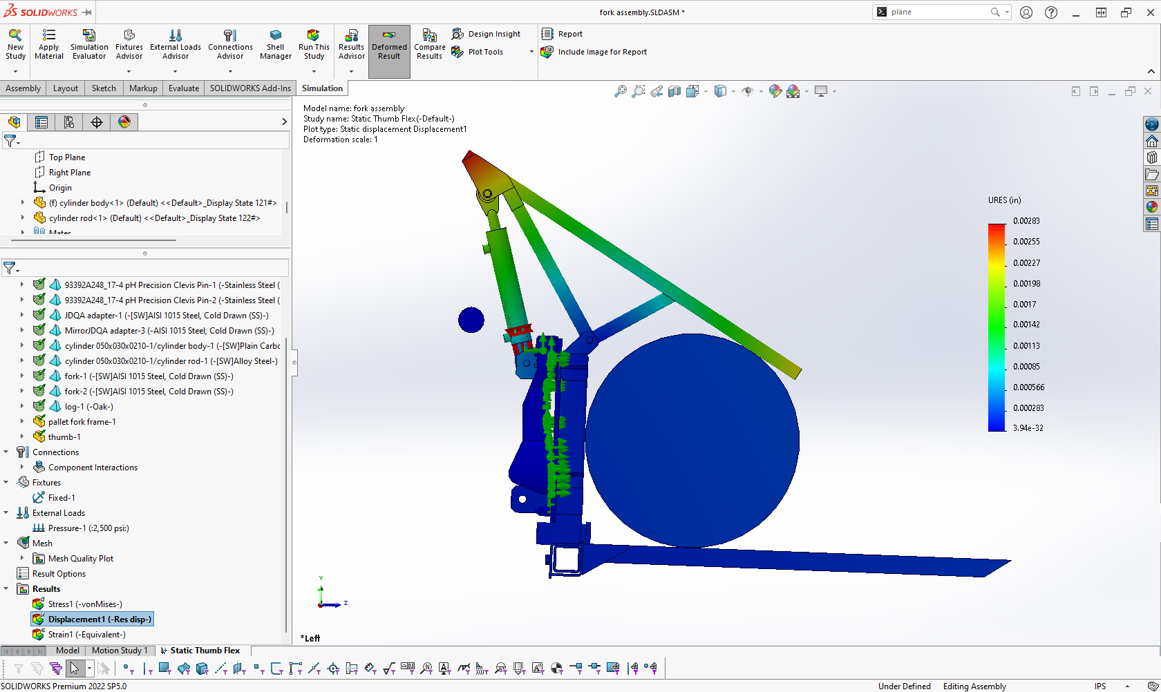

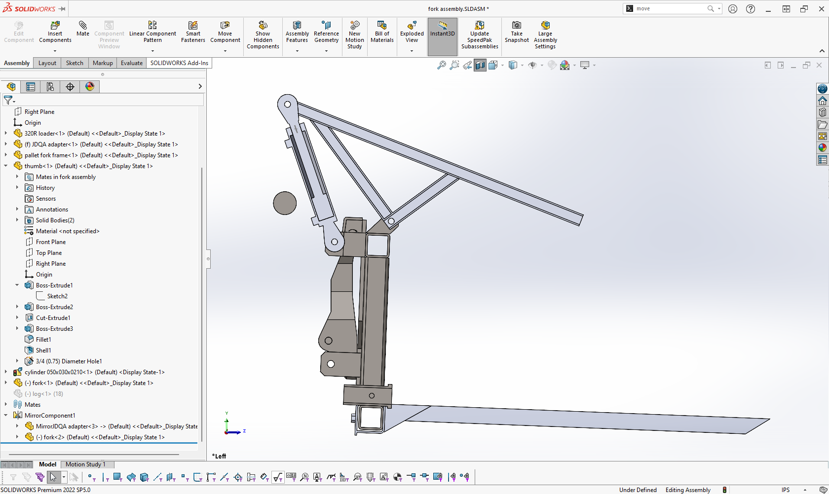

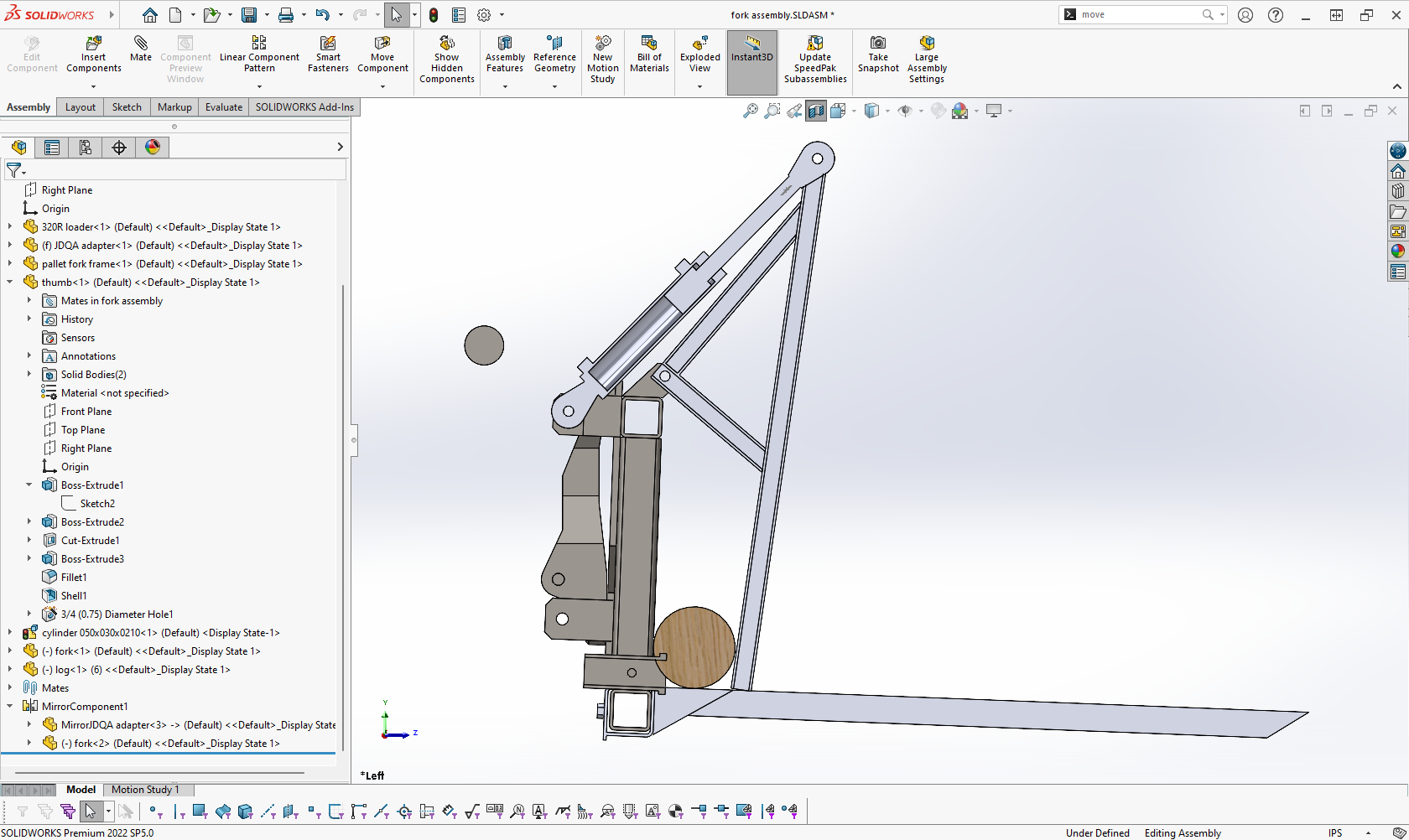

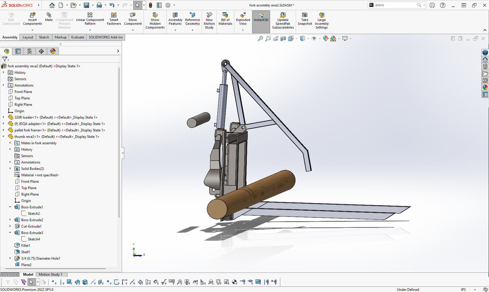

@Sawyer Rob had posted this in another thread:
Serendipitous timing, I was both contemplating a grapple and setting up to modify my own 3-point forks for JDQA loader use. One of my primary loader uses is moving logs, all 15 foot lengths, and I do this using a pair of chain chokers arranged as a sling. It works great, but requires a lot of hopping off the seat, and it's not always the safest operation unhooking the chokers while piling logs.
Looking at @Sawyer Rob's rig, I started playing with the idea of using the top link pin on my 3-point fork frame for mounting of a cylinder to control a thumb. I won't need this top link pin when using the forks on the loader, so it's available. It appears all I need is an extra set of tangs welded to the top tube of the fork frame, to let the thumb pivot:
(click for full size)
The tube floating in air is the cross-member on the loader frame, need to make sure the cylinder can't collide with that. Shown here with an 18" log, but tested with 6" to 24".
No binding or collisions in full range of travel:
Only potential problem I see, other than needing some more work to pick metal sizing and thicknesses, is that the thumb may tend to lift small logs off the forks due to forming a "V" with the back of the frame at small diameters:
I thought I could tune this out with some fiddling of the section lengths on the thumb, but this is the best I've been able to do without either giving up max capacity or causing a potential collision / bending metal between the cylinder and loader cross member or cylinder to thumb spine.
If someone can give me a good guess on square tube size and gauge for that thumb, it might save me some FEA simulation work. The cylinder is only 50mm bore, so around 7850 lb. at my tractor's 2500 psi working pressure. Weight is a concern, as this fork frame already weighs a lot, and I'm often fighting for more loader capacity when moving logs.

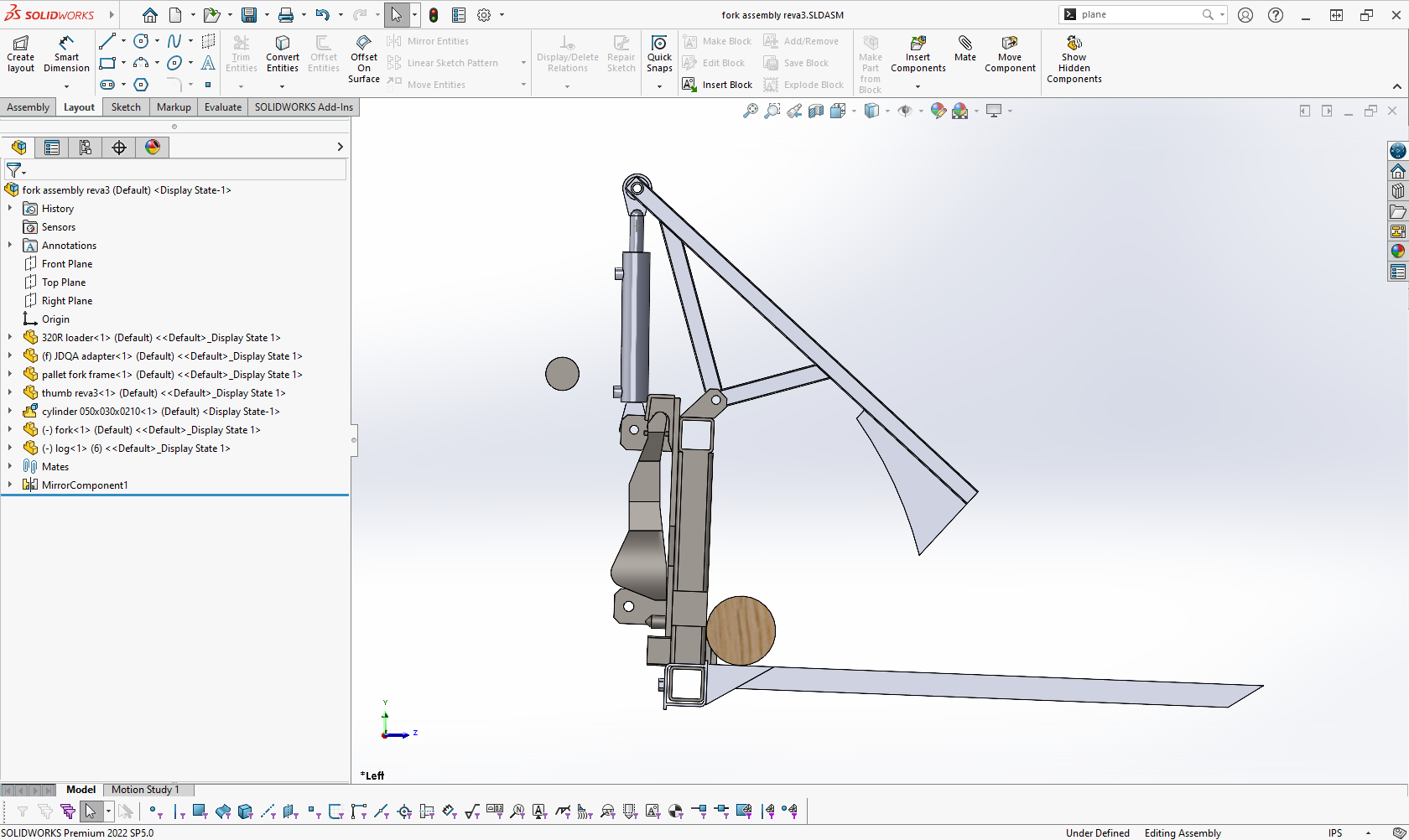

why not kink the end out at a 45 deg so that a small log would not ride up and if it is a big log the corner would catch it and pin it in?
   / The "thumb"
#48
You mean like the reverse of a hook?
instead of angling it in which increases the ride up effect for small logs if it is angled out for a small segment at the end, the closing thumb will push small logs down but on larger logs the longer straight segment will work as normal and for in between sized logs the corner will act as a point to pin them keeping them from riding up. one of the drawings you posted earlier had exactly the opposite.

Doh! Yours came in while I was answering the last. Great post, thanks for the pointers. A few quick answers:
Yes, that's exactly what this is! I chose tubing size, tangs, and cylinder all based on what I had in my inventory. If buying I might have gone with 1-1/2 x 3 inch tubing, rather than 1-1/2" square. But I can always add a 1/4" x 1" or 2" spine atop the arm to add strength in the vertical direction, if needed. If I decide to cut a curve in some 6" x 3/8" flat stock, I could actually put a curved spine (tooth) on the bottom of the thumb.
Two options:
First, I could quickly and easily add another tube section mitered onto the end:
Second option is more work without a plasma cutter, but I could cut a piece of 6 x 3/8" flat stock I have into a curve, and weld it onto the bottom of the arm. This might be prone to side-bending if it's just a single thickness with much extension from the arm:
I thought I'd be able to more slowly release it with the straight arm than the curved, to be honest. Have to think that thru, as one serious shortcoming is the fact that the 3rd function I have available to control this is off a "bang-bang" electric solenoid controlled by thumb switch on my joystick, it's not proportional.
Speaking of which I was planning to add needle valves or restrictor plates to the input ports on the cylinders to be able to adjust thumb speed, unless Deere offers some valve similar to the 3-point float-down valve, to do the same right on the tractor.
The most frequent use will be lifting logs off a pile and setting them on the ground for bucking, in which case I think I can control the descent by how steeply I angle the forks down. The other potential use would be lifting logs out of a trailer, but I'd need shorter forks to get into the trailer more easily, and I'd have to be careful not to catch the far wall of the trailer with the thumb. It's a closed-side trailer with a railing about 2 feet above the floor:
Thanks! Yes, spent my career as a design engineer, and I'm all too familiar with those caught in analysis paralysis. Get it close, then build it. You'll learn more from rev.A than you think, and quickly mod it or spin rev.B to be much better.
first option from above but reverse the angle so that as the thumb closes the small log will be pushed down a med log will engage the point formed by the corner of the segment and large logs will engage the straight section and work as before.
   / The "thumb"
#52
Got it. Yeah, that would work nicely for small logs, but might make it more challenging to use for some other ops, like plucking medium or larger logs off the trailer floor. Everything is a trade-off!
   / The "thumb" #53
nothing a diverter valve an extra cylinder and another pivot wouldn't fix lol

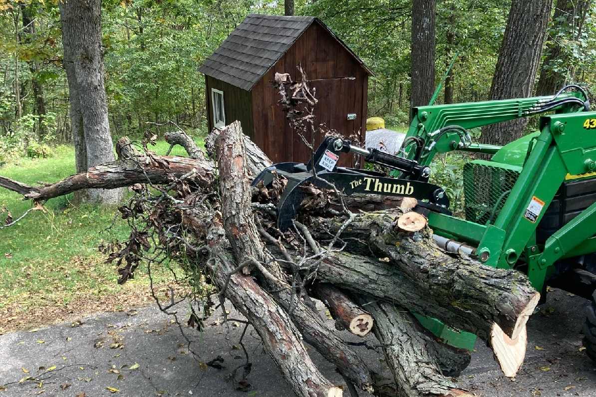

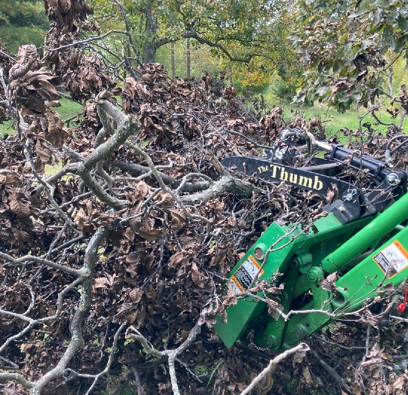

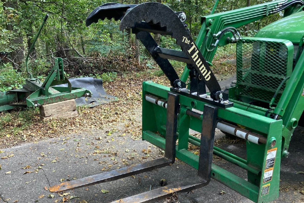

I'm very happy with "The Thumb" on my forks (which are mountable on either the FEL in place of a bucket or picked up with the quick hitch (iMatch) on the 3ph.
Quick to remove with just three pins. No interference picking up pallets of firewood, and even add some stability if needed.
