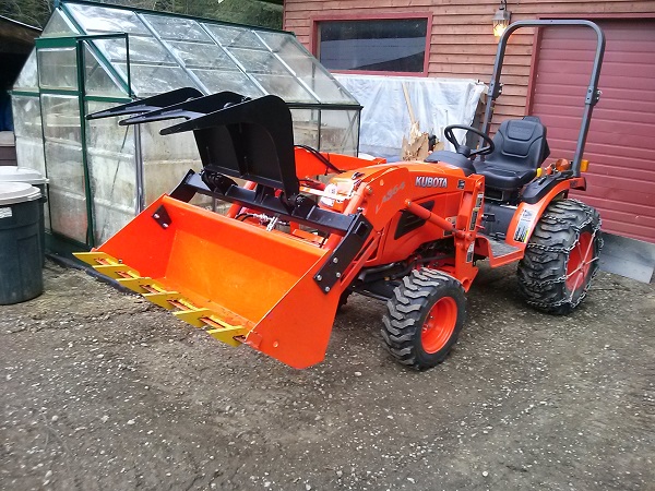

Just had a WR Long 3rd function installed on my B2620, the Kubota factory was a diverter valve. I also had the WR Long bucket grapple installed. A heavy duty piece of equipment. BucketGrapple.jpg

That grapple sure does look heavy duty, I'm thinking on having something a little smaller like a thumb. So with the diverter valve installed, which bucket function did you loose, lift or curl when you operate the grapple?
   / "The Thumb" Bucket Grapple questions #56
I did not loose any...went with true third function

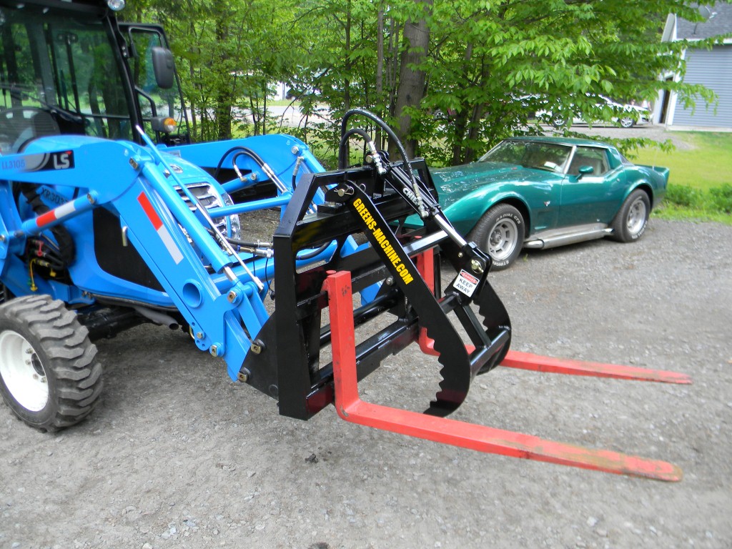

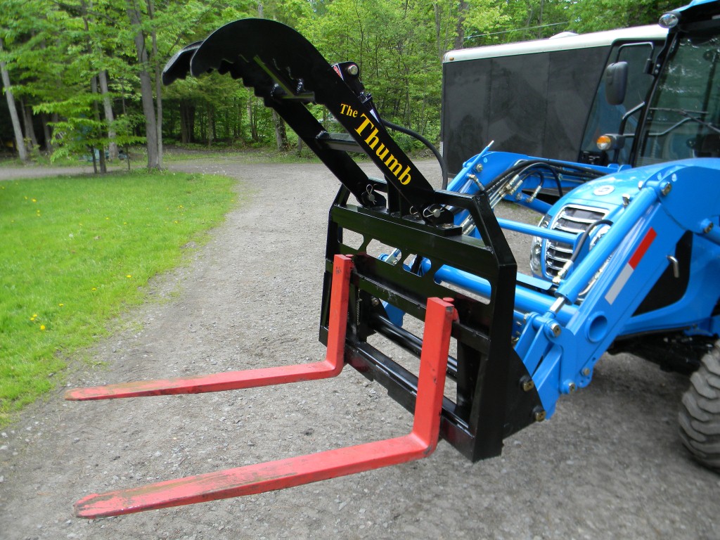

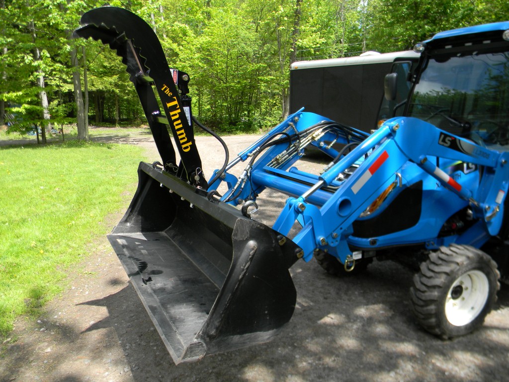

I have the thumb (actual name Thumb by greensmachine). I bought 2 base plates and mounted one on my forks, the other on the bucket. The thumb does not block your view any more than a grapple would. Plus its a lot cheaper, less than half of what a grapple would cost. The thumb gets the job done for me. I don't have enough work to need a grapple. Mine is powered by one set of rear remotes. I ran hoses up to the front.

Thank for the quick reply. I viewed you pictures and I like the one with the two red long extended bars, it appear to get under anything better, to give you a better grab. What is that piece you have the thumb and bars attached to, which is not a bucket.? And you have a picture with the thumb on your bucket. what host/h.-fluid line do I need to make the thumb functional. My Mahindra 4500 has four h-fluid lines, and they are all used for the TAS loader>ML360 I already have on it. What will I need to do/add to my Mahindra 4500 to operate a thumb mounted on my bucket???
